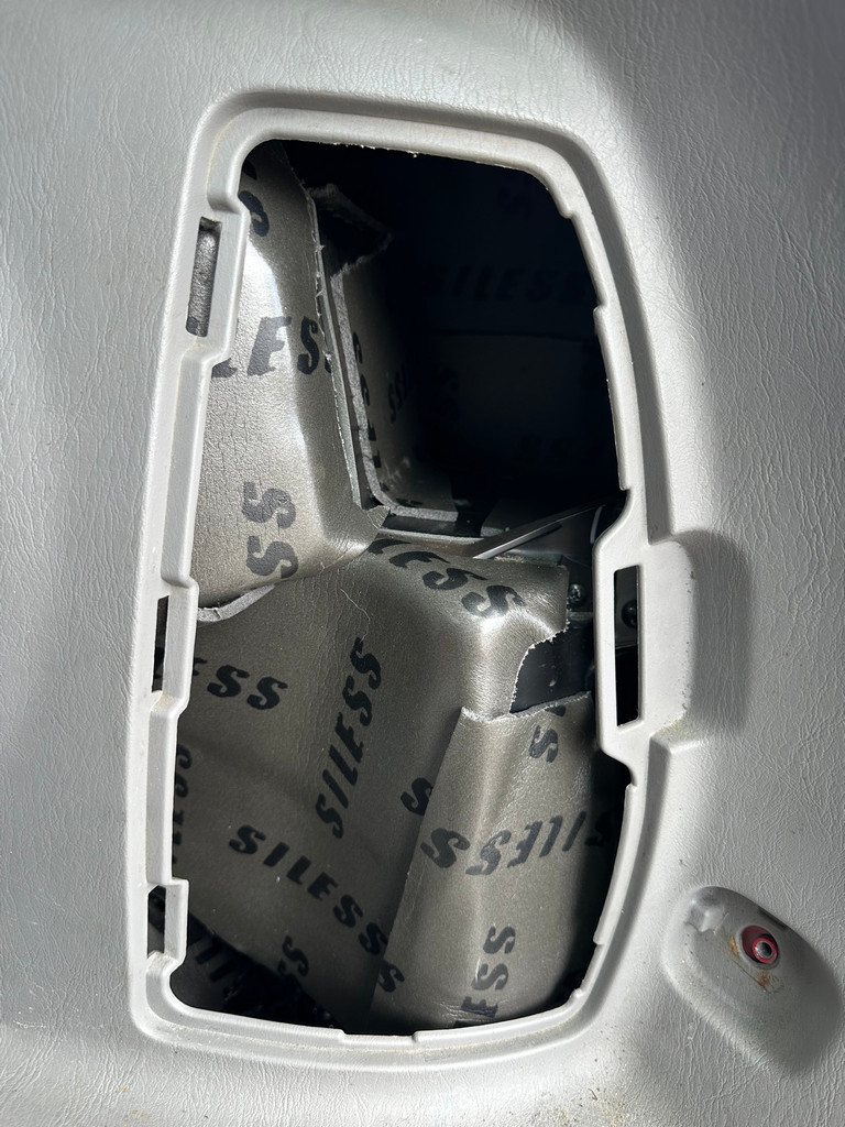

I'm also concerned about the front door panels. The brackets are tall enough to rest against the door panel in the bottom corner. That could cause vibration or excursion collision, so I may print out some shorter ones to be on the safe side when I return from my trip. I installed the crossovers on the panels that cover where the power window controls are located and didn't realize there is a block of foam that fills the area. Welp, that got chopped in half.

  • I mounted the amp under the rear 60 seat and may have to move it - the seat is touching it slightly when up and down (front of amp in up, rear of amp when down). **PSA: DO NOT MOUNT ANYTHING UNDER THE REAR SEATS!!!!!** Gas tank, you idiot!! 🤦‍♂️ I made sure to use very short screws that barely hold the amp in place.

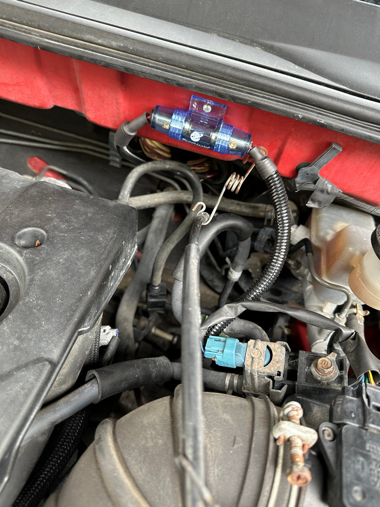

It doesn't work! Do'h!!! Cause I forgot to put the fuse back in the fuse holder under the hood!! Which, btw, you can't tell except for the holder mounted on the firewall.
