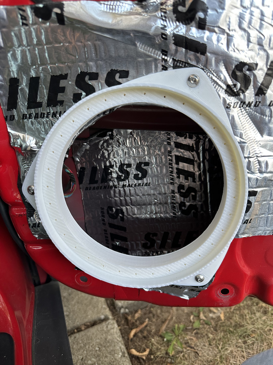

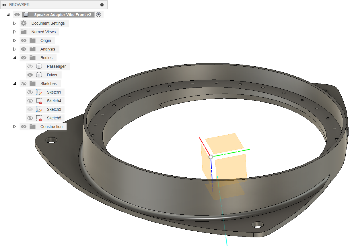

I'm starting a thread to journal my progress on my daughter's 2003 GT Base stereo upgrade. I'm keeping to a small budget and not going overboard (easy for me to do). So, let's begin. I removed the stock speakers and noticed they are the cheap bracket/speaker combo; those gots to go! I designed and 3d printed some brackets. I managed to put in a 5.5deg tilt for imaging. Here's an example:
They fit perfectly.

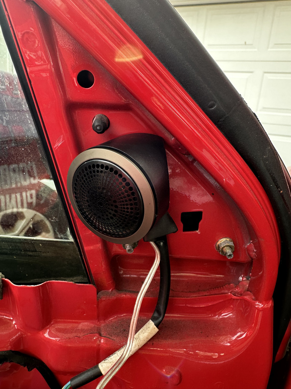

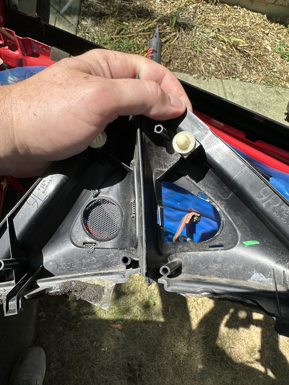

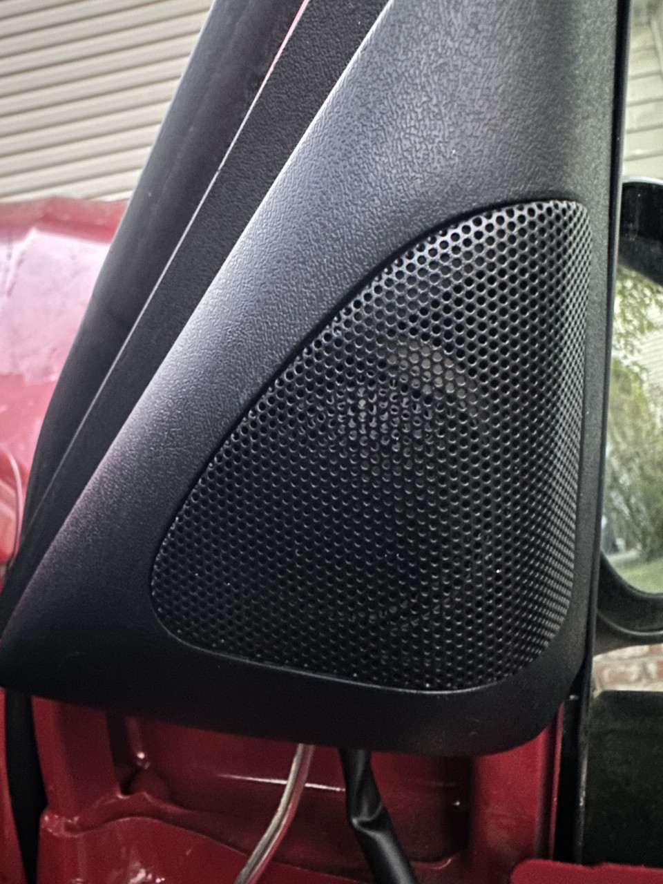

Going to the junkyard, I scored some tweeter pods and the subwoofer. I'll post updates regarding the subwoofer. The tweeters in the component set are much larger than the factory ones. I didn't like their angle positioning either, so I removed the grills and dremeled as much I felt necessary to keep structure to hold the grill and allow me to improve the position of the tweeter.
I managed to use the pillar pods with the set to hold the tweeter in place with some basic dremel modifications; I'll post a pic when I finish the other side. After repainting the grills with satin black and reinstalling them, I'm very happy with the results and new angle.

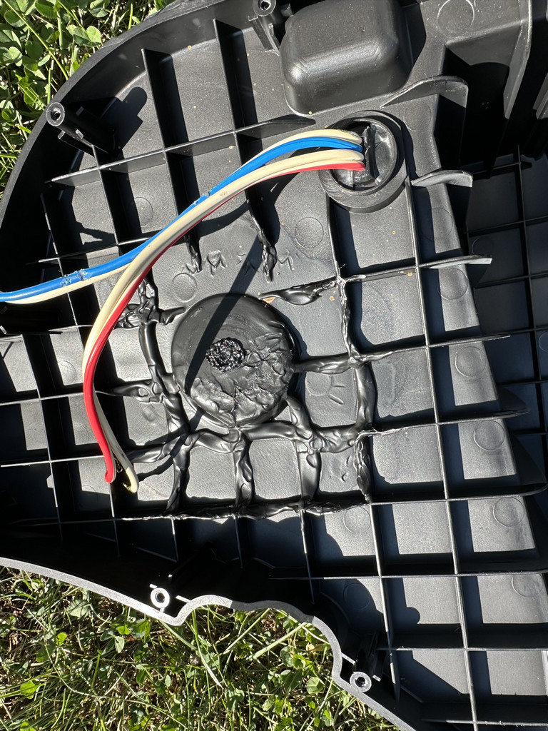

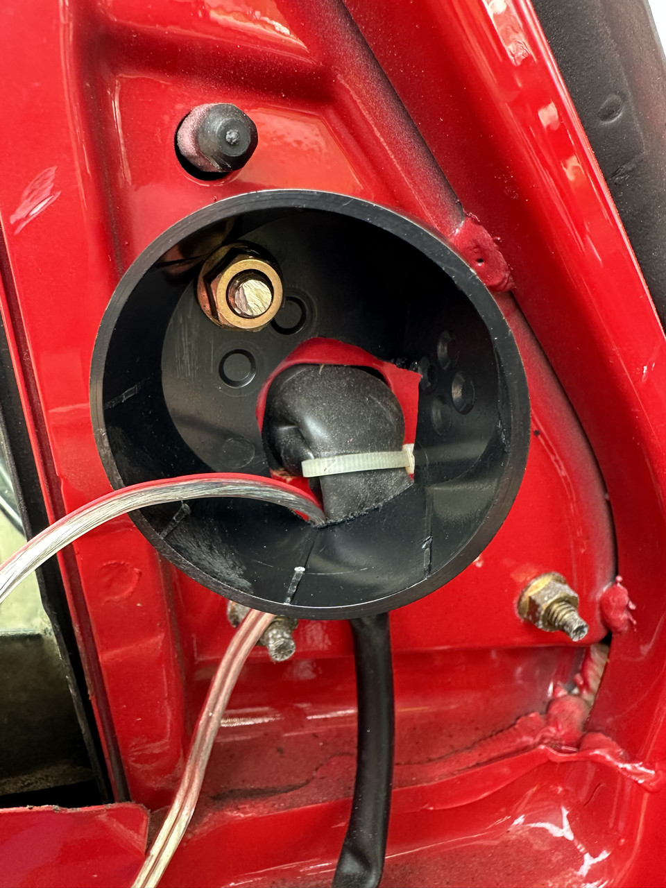

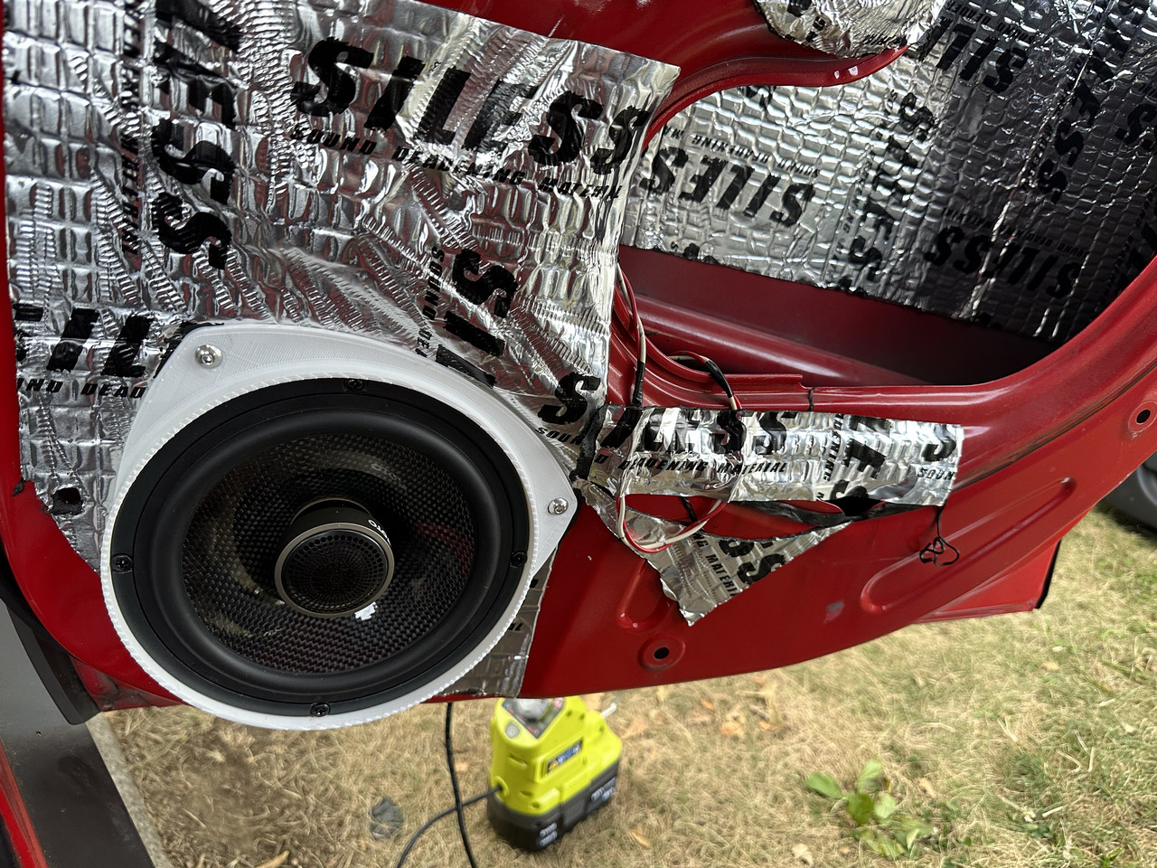

More progress today. I have a road trip Wednesday and hope to get this done sans the subwoofer. Here are some more pictures of the tweeter bracket that came with the components I fitted behind the factory bracket.
I designed some brackets for the rear door panels as well.
I can't believe the grill is the size of a 6.5 on the face, but it only has an open to support a 5.25. Seriously?! I may go to the junkyard and grab some door panels for the upgraded stereo just to have the true 6.5 support. The window buttons can be fidget devices. :lol:

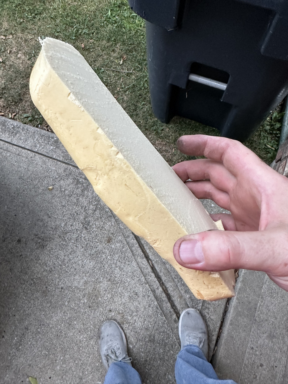

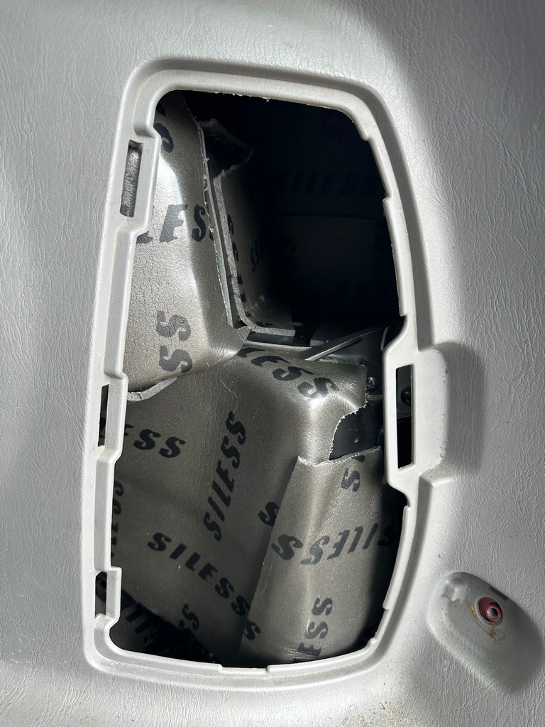

I'm also concerned about the front door panels. The brackets are tall enough to rest against the door panel in the bottom corner. That could cause vibration or excursion collision, so I may print out some shorter ones to be on the safe side when I return from my trip. I installed the crossovers on the panels that cover where the power window controls are located and didn't realize there is a block of foam that fills the area. Welp, that got chopped in half.

  • The speaker brackets are fine, with no rattle or distortion from excursion collision, so I'm leaving them as-is, but I will release the STLs with shorter options since all speakers are not created equally.

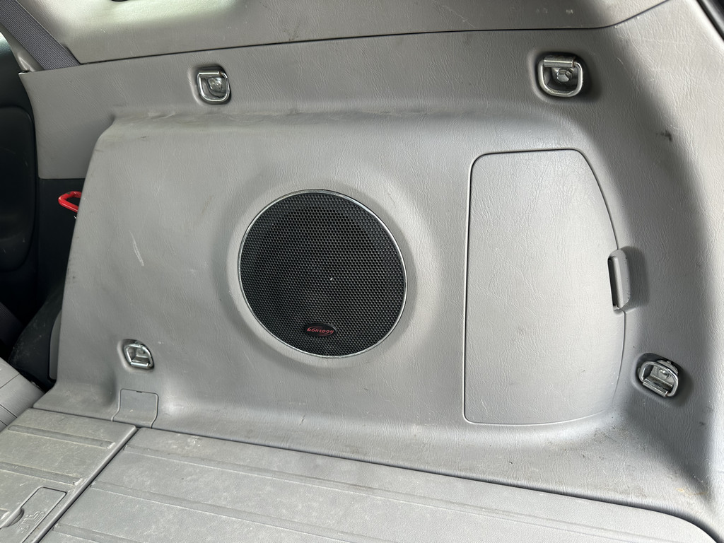

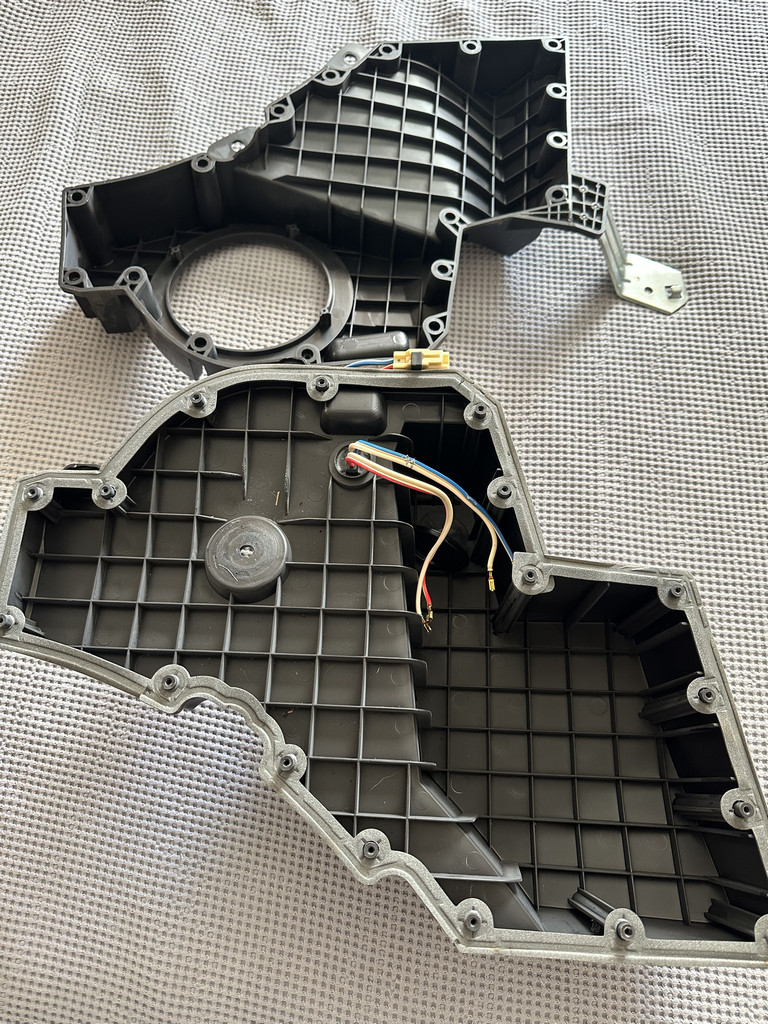

I should have taken a few more pics of the subbox, but this should be enough to get the point across. The box itself is held around the perimeter with many screws and one bolt through the back of the speaker. You definitely want to remove the bolt on the speaker before removing the screws around the speaker surround. The speaker is surprisingly not that bad, and shocked it's a dual voice coil.

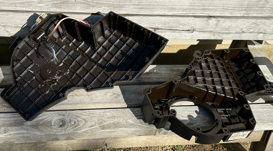

I picked up a Skar Audio EVL-65 in hopes I could fit it, but that definitely was NOT going to happen! So, I spent some extra pennies and picked up what now I believe is the BEST replacement choice, a Kicker CompRT 6.75" DVC 4ohm. The speaker touches the back, so I would say the MAX mounting depth in this enclosure is 2-3/4". The cage and magnet on the Kicker is wider than most speakers and happens to be vented. I used a hot gun to flatten the fins and a 3d printing pen (using ABS) to fill in the bolt hole.
Happy with the fit and preparations, I sprayed the inside with underbody spray.

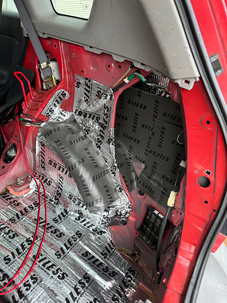

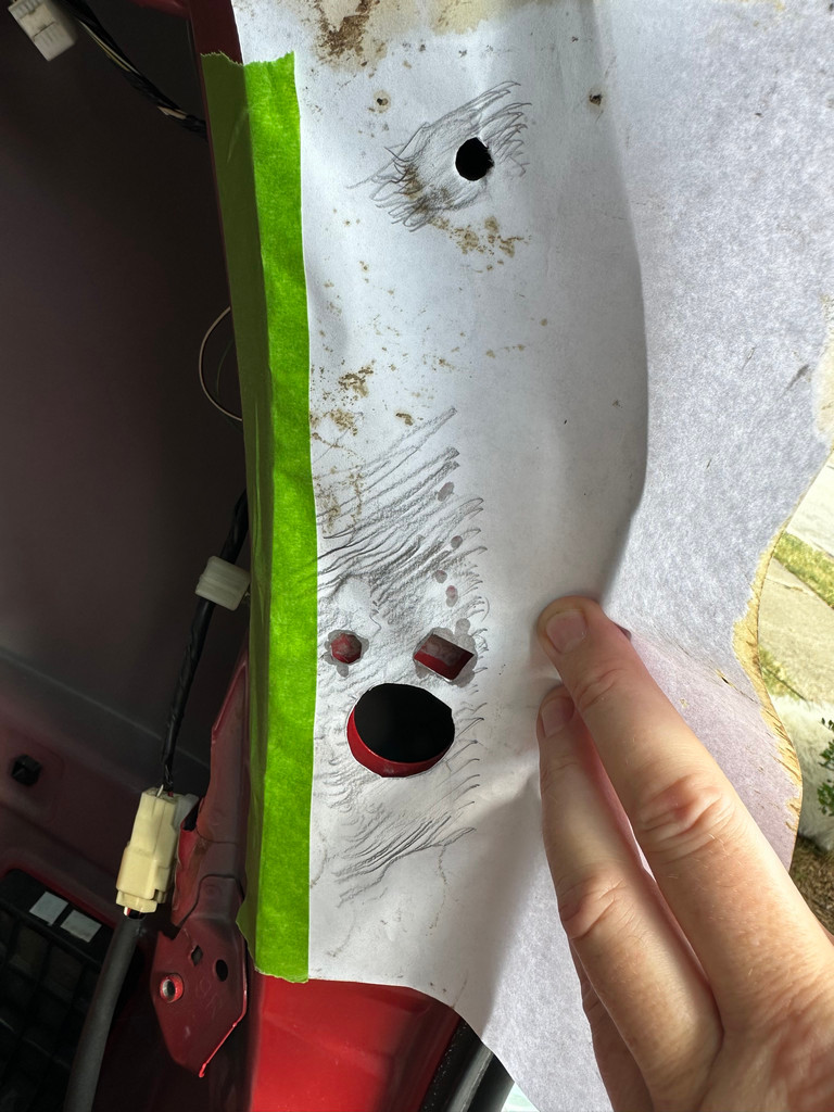

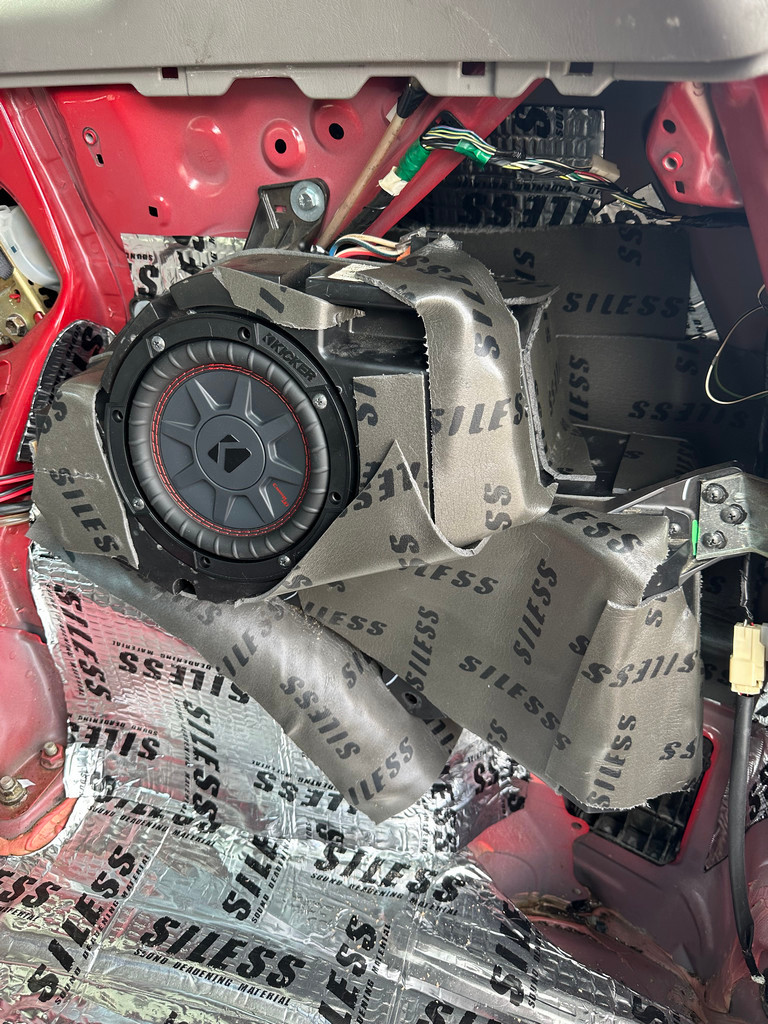

Time to get everything back together. I had to make a trip back to the junkyard because the car doesn't have holes for the brackets, I don't believe it's an option for 2003 - don't quote me on that. A #2 pencil and paper for transfer then cut out and used a sharpie to mark the holes. Easy peasy
The holes above and below the speaker are also absent, but I wasn't going back to the JY for those. I cut the top plastic hanger off the back so it would rest flush against the body, marked the holes, and used a stepper bit to make the holes large enough for some cheap 1/4 20 bolts with swivel locking nuts and fender washers for the top two holes. As for the bottom two, that's a bit trickier. I ignored one (lowest hole can't be reached behind), cut out ~2 3/4" standoff from a piece of 2x4, and used wood screws from both ends after drilling one hole through the body at a seam. Time to deaden this whole back and install the sub!

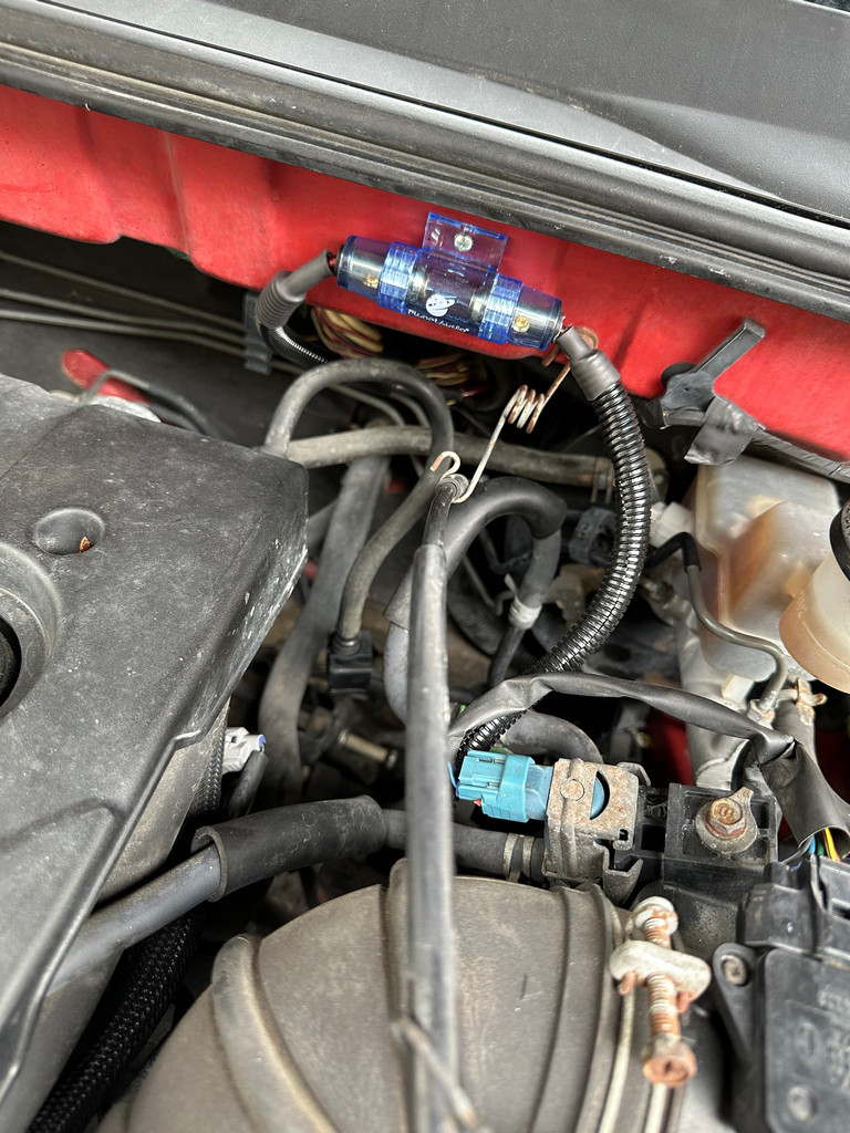

It doesn't work! Do'h!!! Cause I forgot to put the fuse back in the fuse holder under the hood!! Which, btw, you can't tell except for the holder mounted on the firewall.
Hindsight for me, but something to consider for others looking to upgrade or install one of these gems, I would mount the amp to the box in the available space in the compartment on top. I'm using a Taramps 400watt Monoblock because of the size (Class D) and best bang for the buck - it would fit perfectly there, but instead, I mounted it under the rear seat (Again, I do NOT recommend mounting anything that requires drilling under the rear seats - gas tank!)
