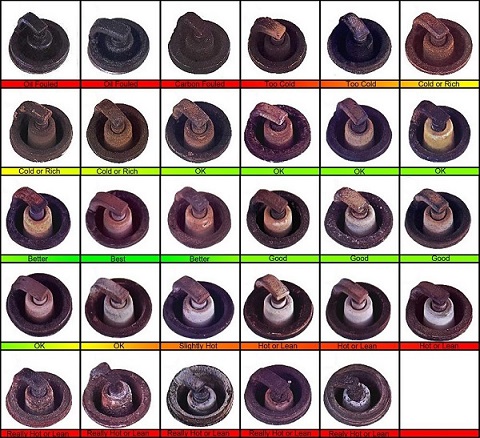

I think I would first have a look at the the spark plugs. The way they look can tell you a lot.
https://images.search.yahoo.com/images/ ... rt=mozilla

I checked all the spark plugs, 3 looked perfectly fine and the 4th (furthest to the driver's side) was similar with small amount of deposits. I swapped it's coil with one of the original coils, but there were no changes.

If you still have the old plugs could you post a picture of the electrodes?

vibrologist wrote:If you still have the old plugs could you post a picture of the electrodes?
I hear you on the Dart. http://www.curbsideclassic.com/curbside ... tal-mopar/
Image20160214_233115 by LodeCreative, on Flickr
Image20160214_233129 by LodeCreative, on Flickr
They don't look terrible (to me), but they are less than 6 months old.
Man, a Dart with a Slant 6, those are indestructible.... still tons of electrical issues, even the later electronic ignition cars, mine had a major electronic failure i never sorted out, eventually swapped for a 318 and just transplanted all the wiring from the donar.
Well, 40+ miles on the car so far without any of the driveability issues showing up. Those normally would show up within the first 2-5 miles. It did feel like it missed once at a traffic light (but my 90lb Bernese was in the back and she may have just been moving around, her panting is enough to shack the car) and it has a slightly heavier than normal vibration. Not sure if that is just from the relearn procedure or if there's still some issue to find.

Re: No codes, Car Shudders at low speeds
Thanks for the pictures.
These plugs were running a little too hot. The insulators should not look white but slightly tan.
