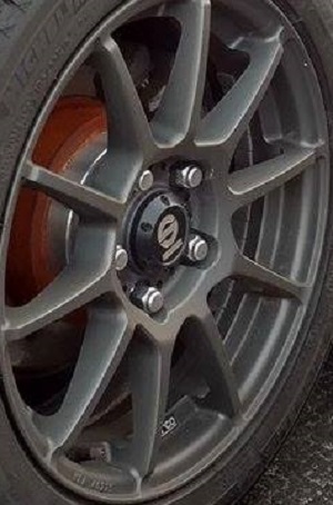

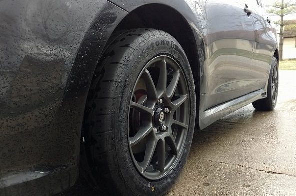

its official im using the Sparco 16x7 as summer tires and will get steel wheels for winters.
installed 205 55 16 Firestone Firehawk Indy 500 tires. they look and handle amazing

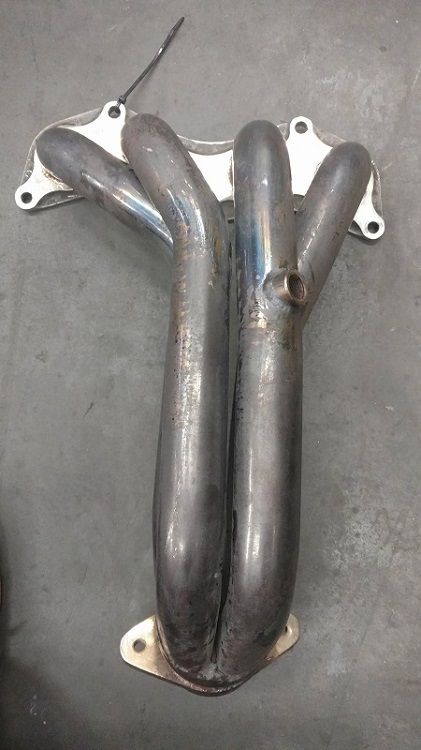

i got a Strup header for my vibe gt, hope to install it soon.
russki1990
Posts: 31
Joined: Mon Jan 16, 2017 11:31 pm
Re: Russki1990 2009 vibe GT manual
Post by russki1990 »
installed the header.
reused the old gasket and doughnut just sprayed them with copper spray.
needed to add a spacer for the oil dipstick about 3/4 inch thick.
soak header bolts in PB blast
remove heat shield and all bolts

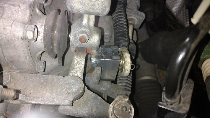

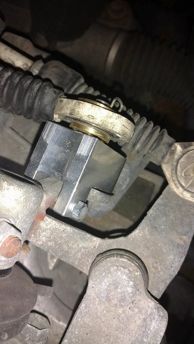

my next mod will be a short shifter.
this is a TRD knockoff by OBX from Ebay ( 35$ )
russki1990
Posts: 31

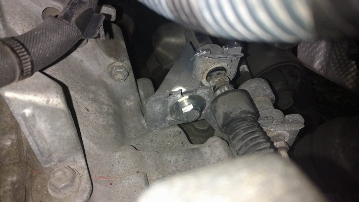

this weekend i installed that short shifter. and it feels amazing. but when i was in their i found out one of my bushings on the shifter was warn out and moved about 1/8 inch and it caused a lot of slop in the shifter mechanism. i found out that the 1st gen brass shifter bushings will work on the second gen vibes. at least it did on my 09 GT.

easy to install.

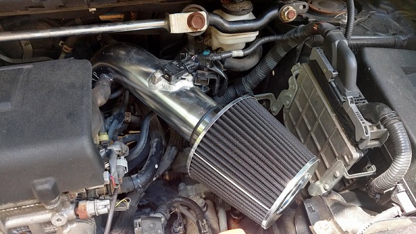

just bought a intake for a Scion XB it looks really similar to the intake on a Vibe.
will be trying out this intake hopefully it will fit.
its a lot cheaper then the intakes that are marked as vibe specific intakes.

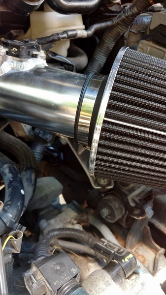

the intake got installed, and it fits nice. it was a cheap way to get some cool sounds from the engine.
russki1990 wrote:the intake got installed, and it fits nice. it was a cheap way to get some cool sounds from the engine.
Nice! Any pics? I might have to try this on my twin boy's new 09 GT for that price.

It fits good but i did have to make a bracket, otherwise it rubbed on the intake housing mounting.

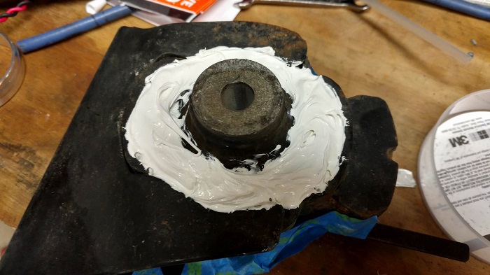

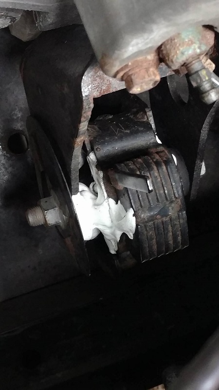

Also did a hardened engine mount for the front of the engine.
i was getting a lot of play so i decided to try out how this would feel.
i got some shore 30 rated silicone and filled it in.
will be installing it in a couple days due to it needing about 3 days to dry.

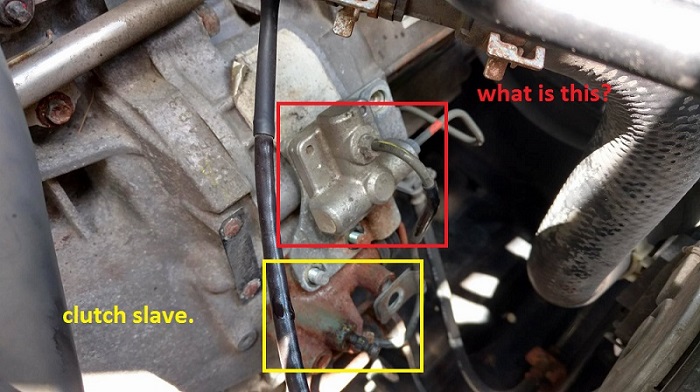

does any one know what this is and can i get rid of it ?
my guess is that its a clutch damper ( it has an orifice inside that slows down how fast you can dump the clutch)
has any one ever deleted that from the system and just ran a SS hose to the slave?

drove the vibe today for the first time with the new engine mount.
it feels amazing, you dont get any vibration from the engine at idle or when starting off ( does vibrate a little when the engine first fires on start up) but the response is much much better now. i think i will try and do the rear engine mount too.

whooops i installed the engine mount too soon, seems like you will need more then 4 hot days to cure the stuff.

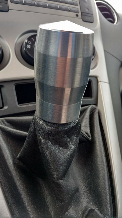

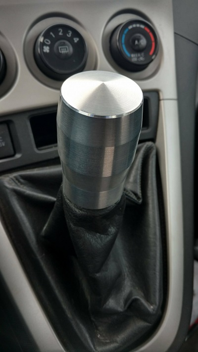

what do you guys think of my new / (old because i did this a long time ago) shift knob?
took some aluminum and turn it on my lathe.
JetBlack
Posts: 38
Joined: Wed Jul 20, 2016 10:28 am
Location: Sacramento CA
Post by JetBlack »
Looks beautifully minimalist, Hows the super strengthened engine mounts feeling?

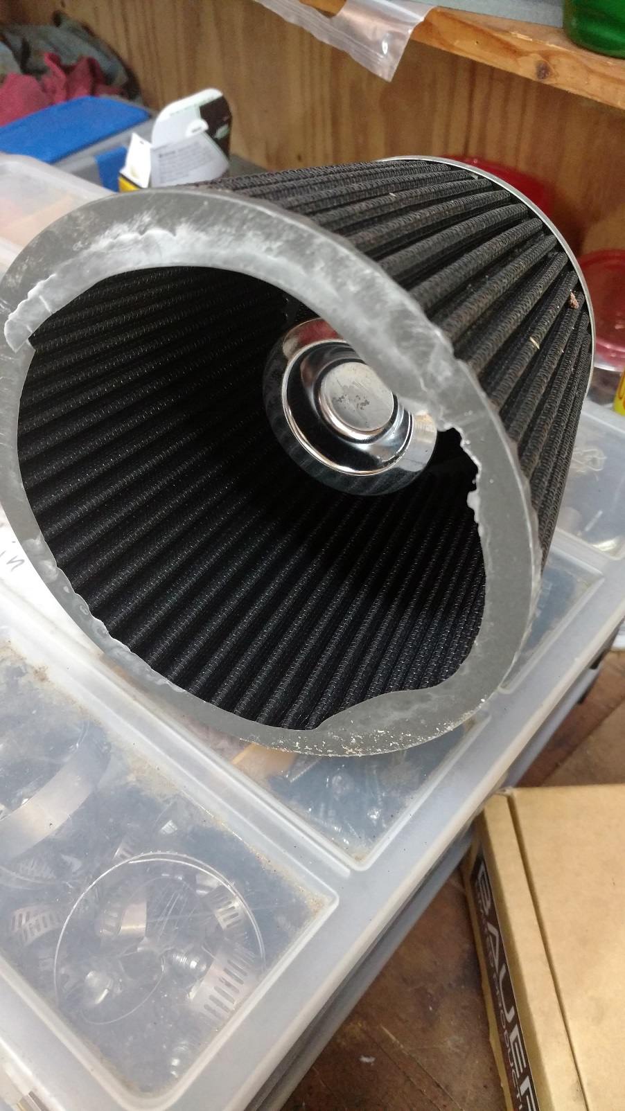

the cheap ebay air filter broke and fell off while i was driving.
I'd snag a quality K&N filter for sure for that.
