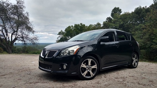

hey guys this is my second vibe gt.
ive owned a 1st gen 2003 vibe gt 6 speed. that i loved but had compression issues on cylinder number 2 had to get rid of it.
now i have a 2009 vibe gt 5 speed manual ( i really miss LIFT though)
as of today i have changed couple things on it due to maintenance.
replaced the shifter mechanism for an OEM unit ( helped with slop but did not get rid of it all) if any one has any ides what to do to fix all the slop let me know.
also got some wheels for the winter that i like more then the OEM wheels so i might get some different tires and use them as summer wheels.( OEM wheels for sale)
i will be making an air intake myself, because it is way overpriced for the once that are sold online.
i am considering about doing a lift kit ( around 2-3 inch lift) for the vibe platform and selling them ( let me know if you are interested)
