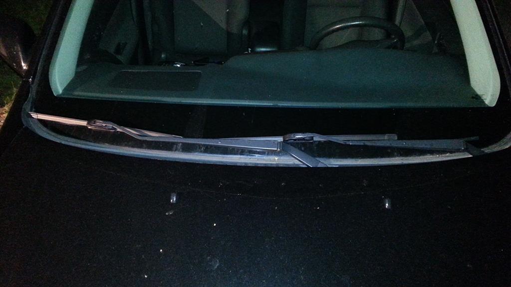

Something has bothered me for a while now, and that is the size of the passenger blade. It says its 18" but I feel like it is too long.

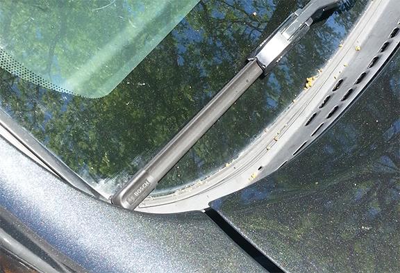

The actual blade in resting position, will ride up on top of the plastic edge piece that is on the corner of the windshield. I thought maybe it was just because of the bulky/cheap winter blades I had put on, but yesterday I bought a set of BOSCH blades ($18/ea ouch) and put them on and same deal.
I feel like this is a waste of money because it could be ruining that edge of the blade, and also I think it introduces mechanical noise. Like a "thump" or whatever when the blade returns to rest, and has to ride up over that piece.
Does anyone put smaller blade sizes on? a 17" or a 16" ?
Its kind of hard to see what I'm talking about in the pic, but you can see it goes right up to the edge with the hood hinge, and I don't think it should I guess..

Well usually I would. But it just annoys me because I'm worried about ruining the blade.
And also I hate the clunk sound it makes. I noticed it especially during the winter when it was and things were a lot stiffer I guess, but I've noticed it in cold rain too. With any luck these BOSCH blades have better quality rubber or something that won't make the sound???

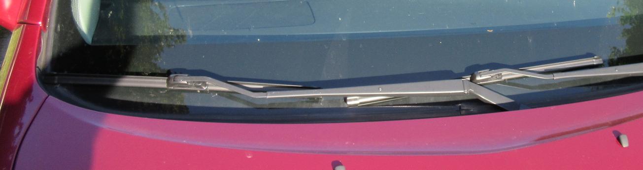

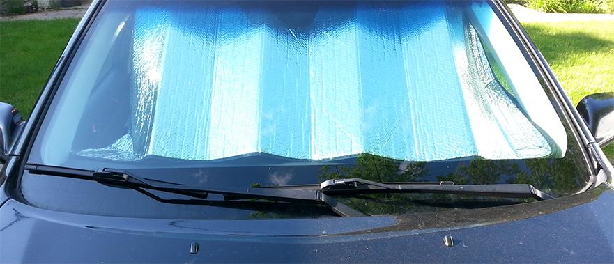

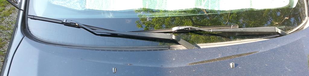

does this look right to people? If my passenger sat higher like yours I feel like I would see it more distractingly and it would become annoying
My passenger blade partially obscuring the driver blade was also something I saw as normal on my old car.

Definitely not right. Wipers should park just below the black area at the base of the windshield which marks the area that is not visible inside the car. Somebody removed the wiper arms and put them back on wrong. It's very common for discount glass companies to do this during windshield replacements.

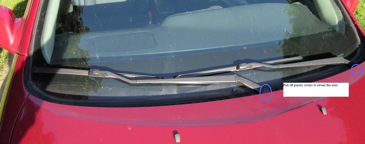

Re: Passenger Wiper Blade Size
You heard wrong. All you need is a 14mm wrench. Pull off the plastic cover by hand, loosen the nut, reset the arm, tighten the nut. I did not even pull the arm off on the driver side.
Before:
After:

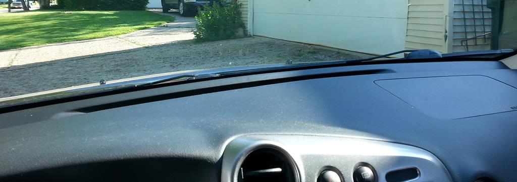

Funny thing about that "black area marks non-visible from inside car" thing. I can still see some of the wiper from in the car, :lol:

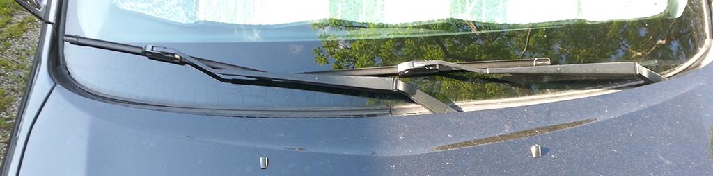

Edit: I just did my best to adjust them.
The drivers side was very easy, I put it up a bit, no probs. It moved easily. The passenger side was another story and left me disappointed. It would not adjust easily, I had to pull it all the way off the pivot mount and it would only go back down at specific intervals, making adjustment a pain.
I manage to either make it too high so the tip of the blade is easily visible on the windshield (but still below the black) which is kind of annoying. Or I can drop it lower, but it still somewhat hits the plastic piece although not as much. When I first adjusted it, I almost couldn't get it back off the pivot mount again and almost freaked out.
Also did gain some room it looks like to install a 22" blade if I wanted on driver side, there is a bit of a gap between the driver and passenger blade near the bottom of the windshield, which won't get cleaned as it is currently set. Maybe a larger blade will fix that.
Here are my new wiper positions, and the annoying view from the inside. idk I guess I like a "clear" windshield area.

BustedVibe wrote:Funny thing about that "black area marks non-visible from inside car" thing. I can still see some of the wiper from in the car, :lol:
My Passenger side blade tip is just over the top of the black line. It looks like your new position.
