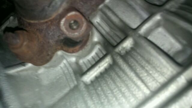

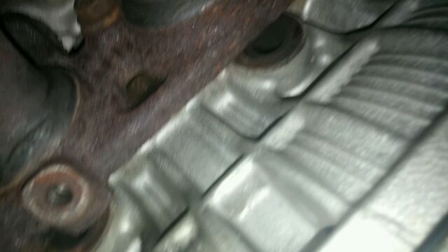

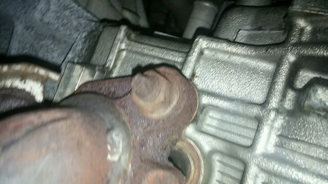

I have pictures but they are too big

Here we go.

klutzycarlover
Posts: 43
Joined: Sat Nov 09, 2013 2:30 pm
Re: manifold help
Post by klutzycarlover »
Okay. Ya, so just take off the manifold then. Should be pretty simple.
