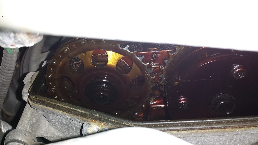

The replacement PCM came in and after a swap I have the same results. No start and only spark on coils 2 and 3, regardless of the coil that plugged into those plugs. Thinking I needed to dig deeper I tore the valve cover off and found the following. (See picture) It looks as though the cams are off to me, like potentially the right cam may have jumped a link. Is that correct or are they supposed to be misaligned like that due to the variable valve timing?

Re: 2005 Pontiac Vibe No Start Troubleshooting
The picture isn't showing :(

Picture attempt number 2.

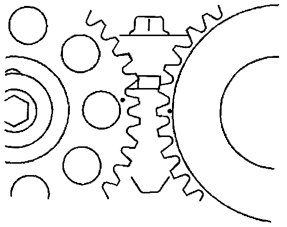

My Haynes manual is saying those two dimple marks on the sprockets should be lined up at TDC.
Here's a pic from ProDemand showing the marks should be aligned:
As you may have guessed...this is really bad news for the engine, most likely.

I'll bet the engine is OK. You just need to reset the cam timing and make sure the chain tensioner is working right. Probably the chain tension got loose and the cam sprocket jumped a tooth. The jumped tooth means the ECU can't get the cam timing to the right place and that sets the P0016. See this:
http://engine-codes.com/p0016_toyota.html" onclick="window.open(this.href);return false;
The timing is off by enough to prevent the engine from starting, but hopefully not enough that the pistons have run into the valves.

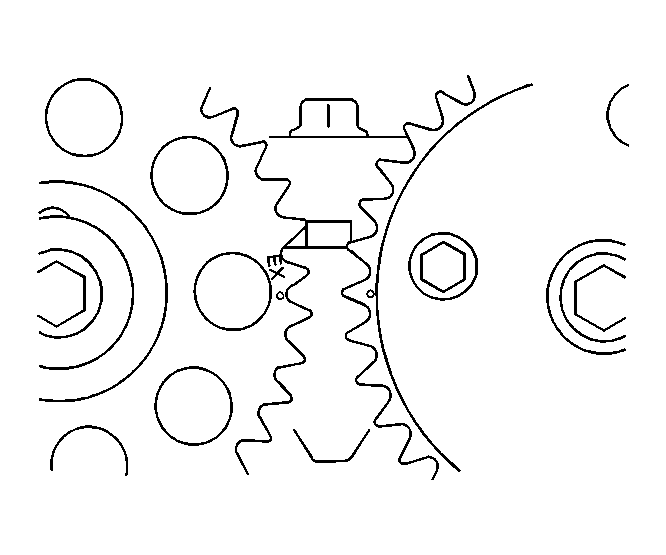

Actually my image from AllData, which is basically a copy of the GM manual, indicates that his alignment may be correct.

My Toyota manual looks more like the first diagram with the dots aligning. Also, there are marks on each sprocket at the top. The one on the left sprocket is visible in the OP's picture. Starting with the link at one mark as "1", the other sprocket's mark should be at link 8.

Interestingly the diagram for the 2006 Vibe agrees with the 2005 Corolla diagram. See image.
