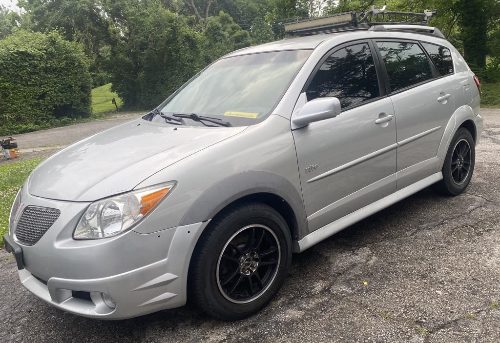

I understand this is an old post but thought I would add my recent experience. 13U and 14U are different shades of silver. The 13u from gen 1 has a slightly yellow or gold tint as compared to the 14u "Platinum Silver" offered on the later 1.5 gen Vibe models. I have an o6 with the 14u and replaced a front fender from a 04 I found from a salvage yard. After installing it, it clearly does not match (see pic)
That said, I am trying to do some touch up on the plastic cladding. Since COVID, for whatever reason, the cost of automotive paint, even Dupli-Color, has gone to a price that is almost unaffordable. As most have already learned "Dupli-color" does not offer an aerosol touch up option although I have been searching for options and found the 14U is very close to the GM silver on my 2007 Cobalt. I purchased the Dupli-color option for the Cobalt (BGM0508) and found the color in the right brightness but the metal flake is too fine, and therefore appears a little different in curtain lighting conditions. I also believe I found a Dupli-Color "close match" for the 13u, if anyone is interested, but have only concluded this match from color sampling and have not actually painted anything to verify the color matched in larger applications.
My final conclusion for my solution (because I am a cheap *&^#@!!) is a Rust-Oleum option which I believe has a very close match in silver tone to the Platinum Silver 14U. However, this paint has larger metal flake than OEM. On the plastic lower side cladding, I am hoping it will look fine for the price. The Rust-Oleum part number is 248927 "Steel" - High Performance Wheel Paint. This is single stage and the price is about 1/3rd the cost of other options if you order it on-line. Like most Rust-Oleum, the single stage finish is a little on the dull side which is great for the cladding. Adding 3 coats of Rust-Oleum "Cristal Clear" over the top and it should be good enough for the smooth areas like fenders, doors and bumpers.. Please try some sample areas to verify this works for you. I am not super picky and wanted something that looked ok, without spending a fortune.

This pic is to show the color match. The front fender flair (plastic cladding) represents the Rust-Oleum color.. The spray nozzle is not very good so it is difficult to get the finish looking OEM but again, for the cost, it is good enough for the kids I hang out with..

Welcome to GenVibe. Yeah, to get true automotive paint nowadays, you better bend over real far and empty out one of your bank accounts! My orange metallic on my 2004 Vibe GT cost me right around $100 for a pint! Not a quart or half gallon, but a pint!!! I was then told that it was the highest tier of all the color combinations, thus the astronomical price! Anyways what you did looks great for a daily driver and once you drive it through a few mud puddles and get some real dirt on it, nobody will know the difference :D
