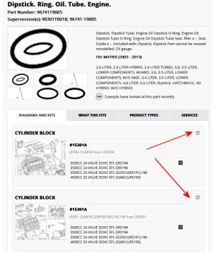

Fletch614 wrote: Sat Feb 22, 2025 6:21 am I am used to looking at exploded parts views on my motorcycles, which makes it easier to locate correct parts. Is there any go to site with exploded parts views of these cars? I've found a few but they are very difficult to search or navigate.
On that same site, if you click the icons marked by the red arrows in this pic, it will pull up the exploded parts diagram, then expand the diagram by clicking on the "View Full Size" link
in that diag, looks like the O-ring you want is item number 11452B which maps to part number 9030112018
https://parts.lakelandtoyota.com/p/__/T ... 12018.html

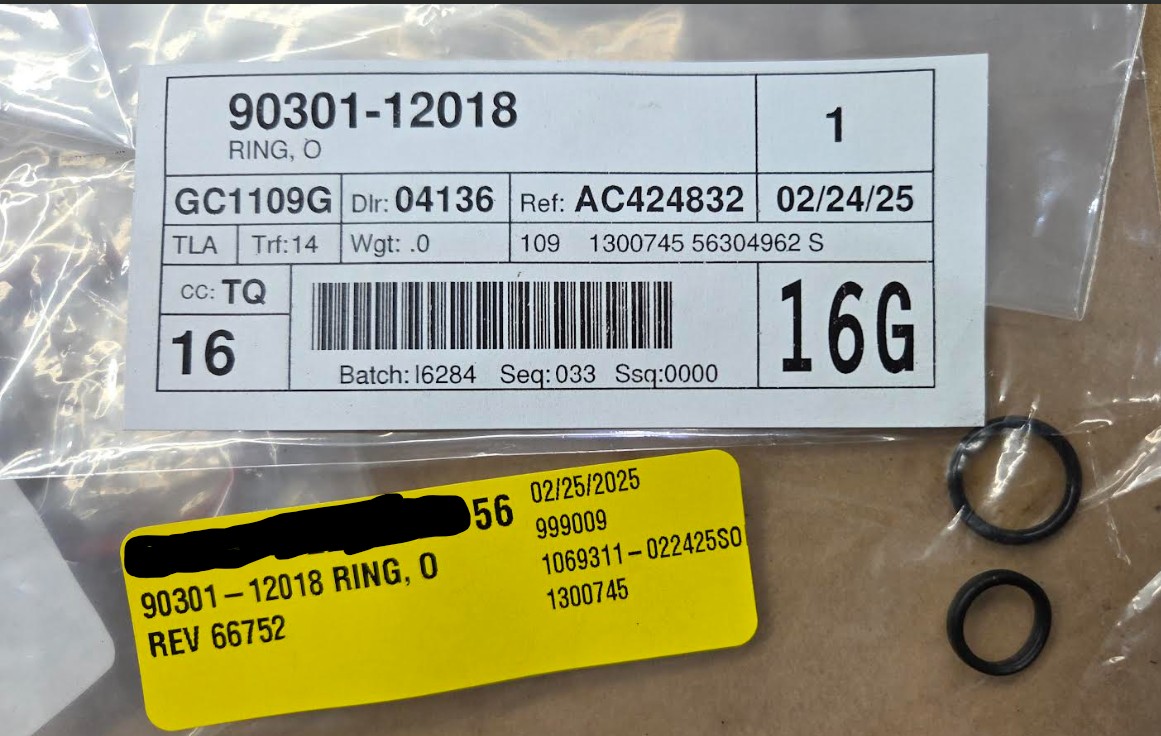

That's it!! Thank you! 90301-12018 called Engine Oil Dipstick Tube Seal.
I'm planning on changing that when I also have my intake off for the new intake gasket for easier access.

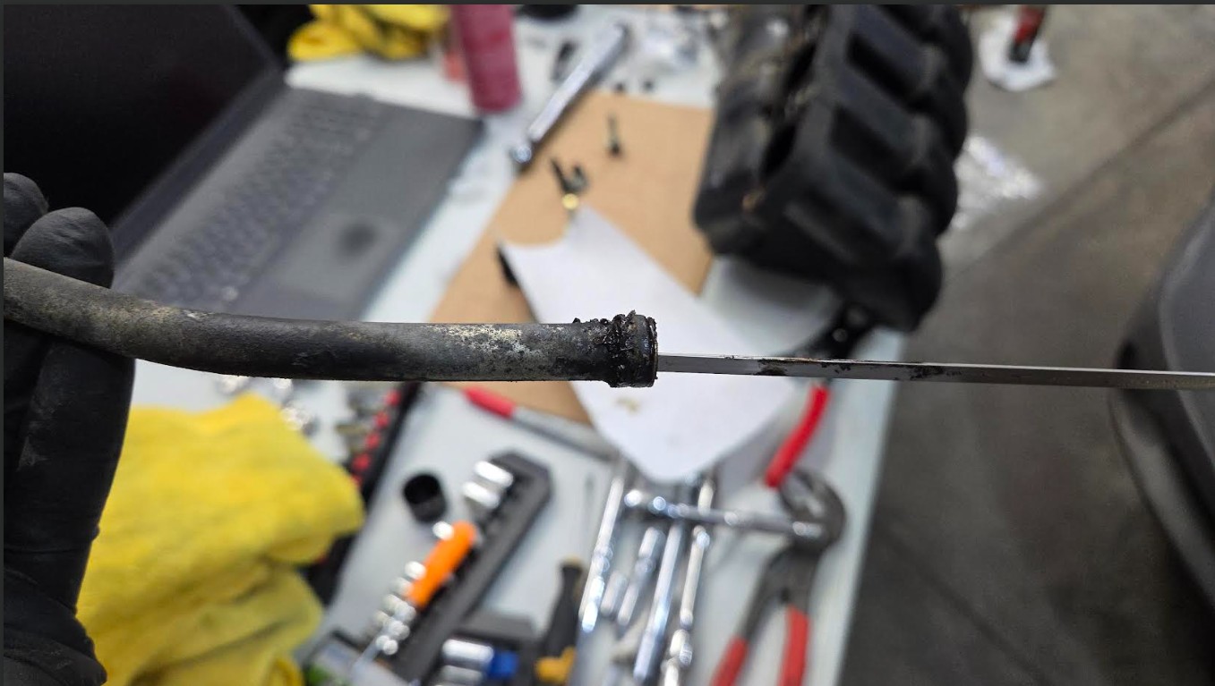

wanted to provide an update. The part I ordered 90301-12018 was not the correct part, it was too large. I'll post a pic of the new part and old o ring. New part is the larger ring on top. It sure looked like the correct part in the exploded parts view. (?) I ended up using an o ring from a collection that I have..hope it seals properly!
Also posting pic of gnarly old dipstick o ring.

Re: oil dipstick tube o ring
that's a significant size difference, sorry for the bad info
hope you get it all back together and leak free soon
Post by Fletch614 »
not your fault! It's what the parts diagram showed. Easy job to do when the intake manifold is removed...but sure hope it doesn't leak, again. It would require removing (again) the manifold.
