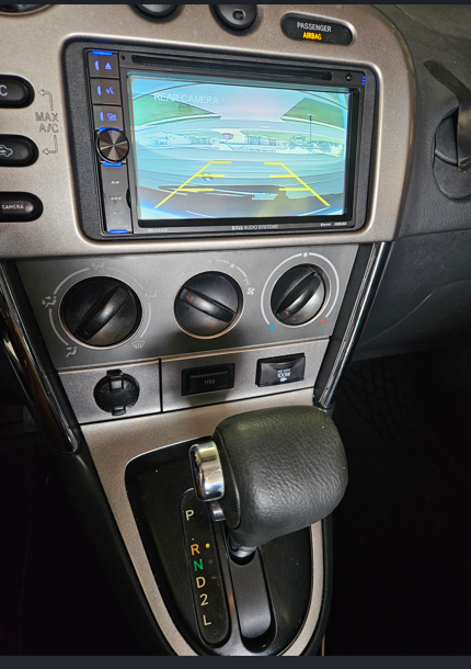

Installed a new radio and back up camera on my 2008 Pontiac Vibe. Went with a BOSS BV765BLC from Crutchfield. It is on sale and got everything to install (radio, antenna adapter, wiring adapter, back up camera, faceplate, etc) for $130 (tax included). Would definately recommend Crutchfield as a one stop shop and they send instructions, wiring diagram and have excellent customer service.
Some of the previous posts were helpful with suggestions and input. But I could not find the back up wire from the fuse panel/block so I just ran the wire to tie into the reverse light. That way the camera activates automatically when in reverse and shuts off in drive or park.

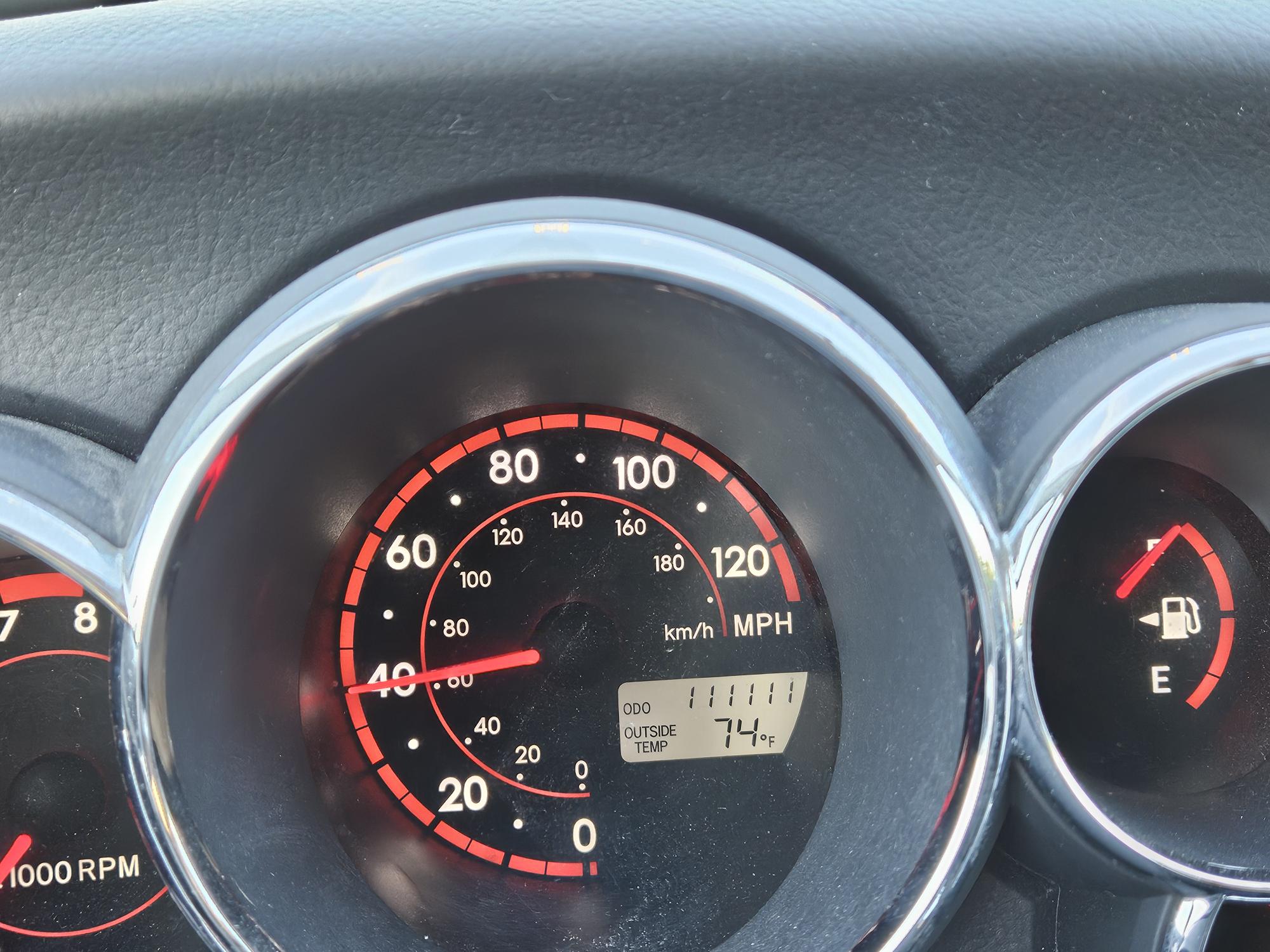

Hit 111,111 on my 2007 silver Vibe (aka Storm)! One step closer to the 299,999 club! My 2008 only has 71,000 so a lot more to go on that one!

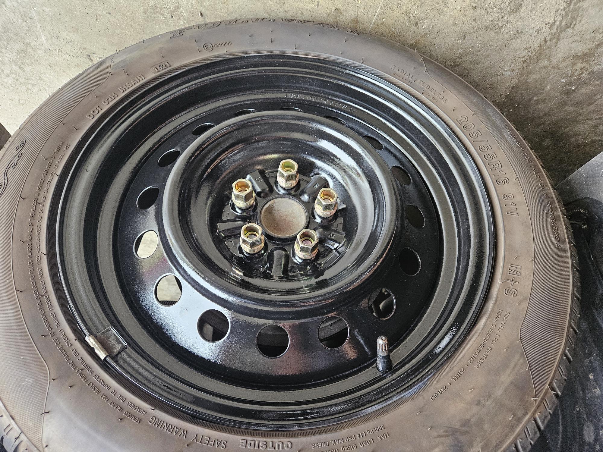

The last task was to sand and paint the steel wheels. I completely forgot to take some before photos without the hubcaps so here is a before with the hubcaps on and one after.

Hey this reply might be eight months late but your wheels look good. At one point I spray painted my oem steel wheels high gloss black too. It looks pretty good with tuner lugs.. my hubcaps have been long gone for awhile.
I also really like your backup camera vibenation I have thought about ordering one but the unit is was looking at doesnt install flush into the dash llike yours.

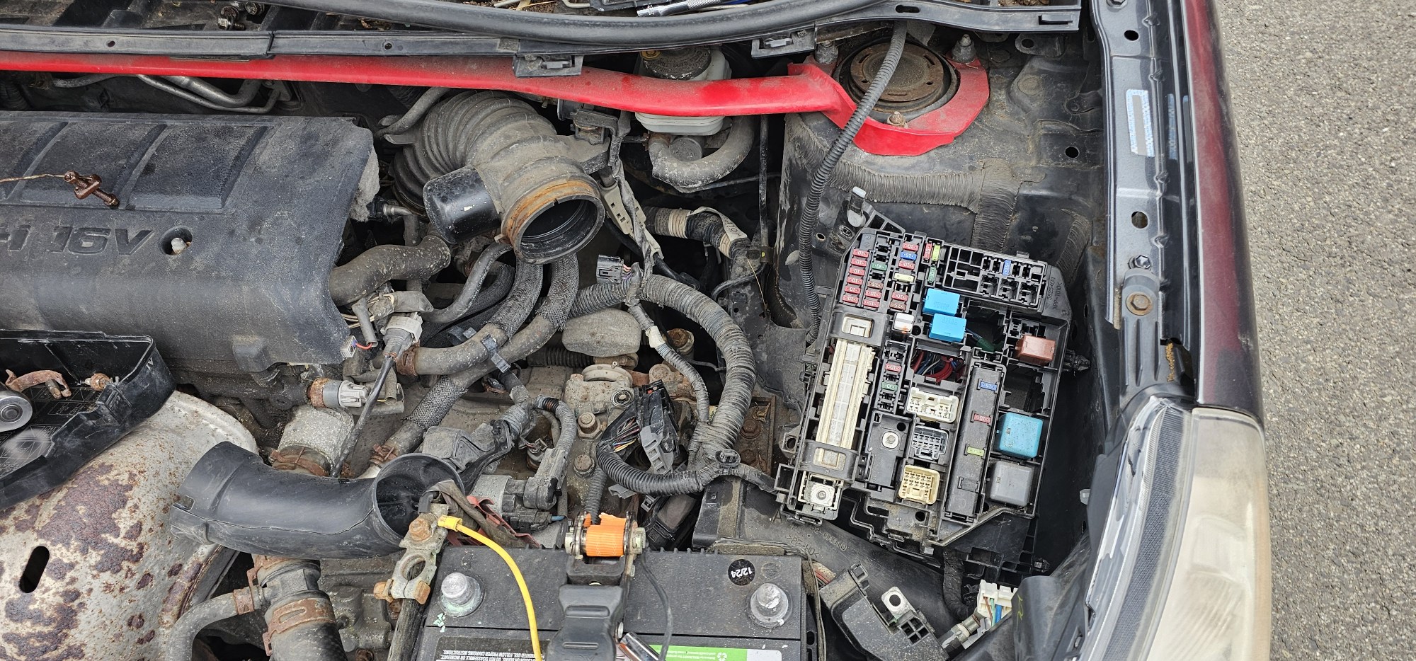

Well, today ive teared up my 09 vibes fuse box. My hvac controls have stopped working. After checking all the fuses, I decided to replace the fusesble link block assembly. According to my fuse schematic it contains a 50 amp fuse to the hvac system. The part cost $35 and replacing it is taking a shot in the dark. Spoiler alert: I missed.
Note my trusty TRD strut brace!

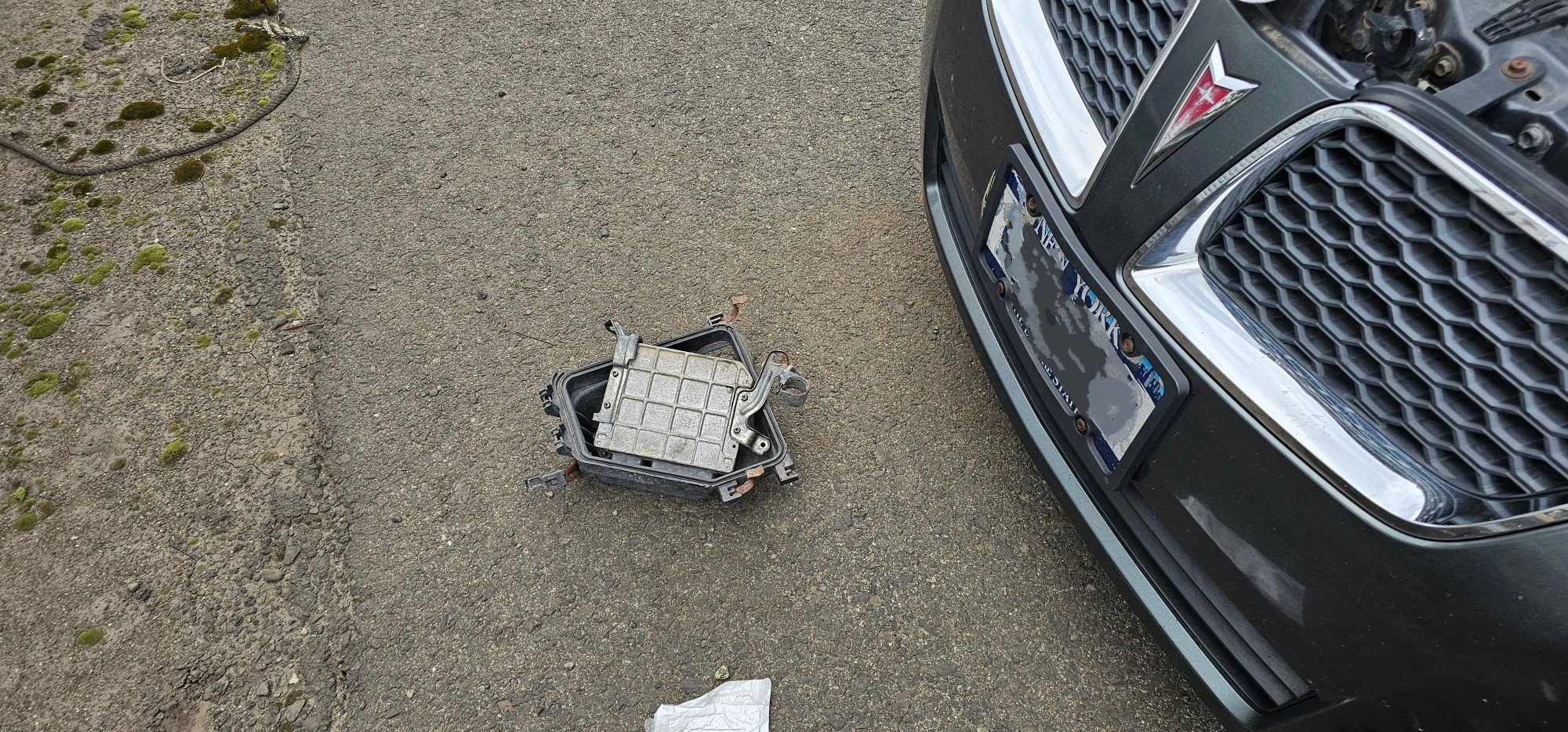

Had the jank out the air box and ecm. Wasn't too hard.
The fuse box pops open like a clamshell.

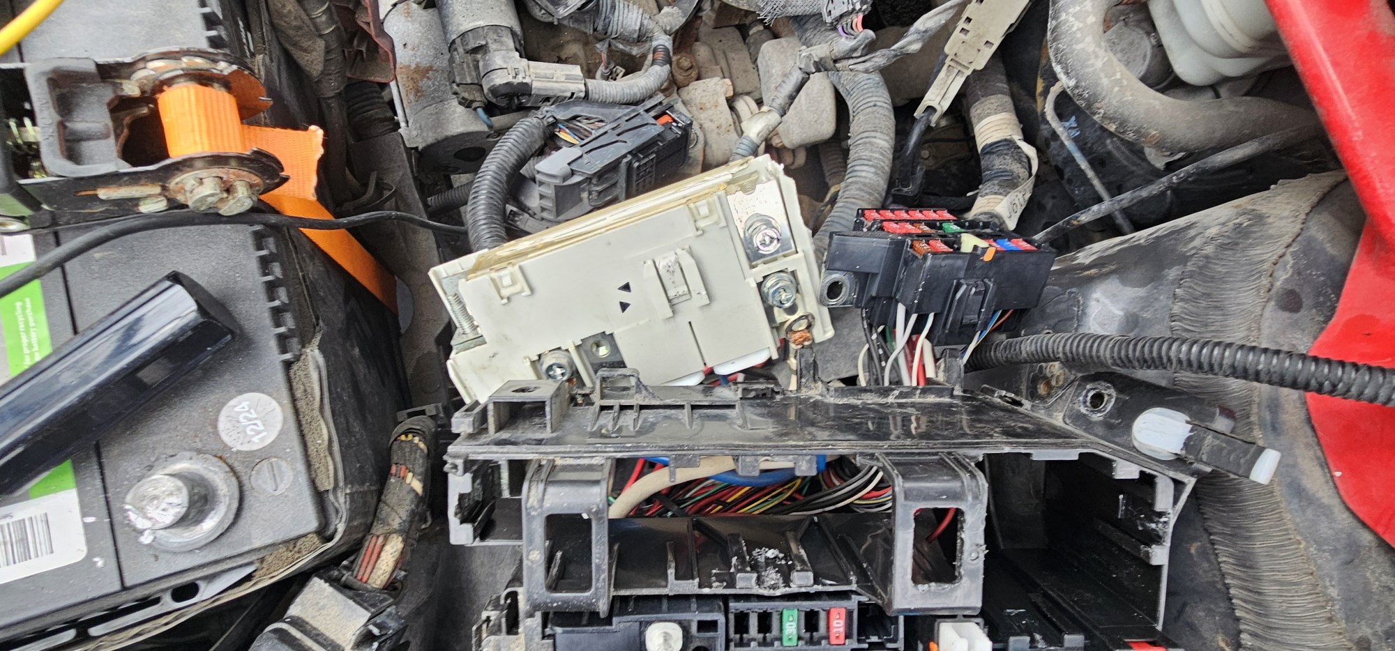

I ended up sorta breaking the original fusible link block trying to pry it out of there. Eventually, I found a YouTube video showing the few clips I had missed that needed to be popped out to remove it. The fusible link block pops out attached to the plastic block populated with smaller fuses above it. Good old YouTube to the rescue. Thanks AUTOTUB3
https://youtu.be/mGmORcPmZ5k?si=ffK_dcbrdcSkcuLp
Making note of where the wires go. I actually swapped the wires one at a time on the new fusible link block as to avoid mixing them up.
20250601_151847 (1).jpg (695.05 KiB) Viewed 689 times
Its in there!
Whelp that didn't fix my hvac..
Its a bummer that ive sorta broken up my oem part which is probably better than the replacement. Though, they look pretty much identical besides the replacement (fusible link block) having one extra connection not used by my car.
