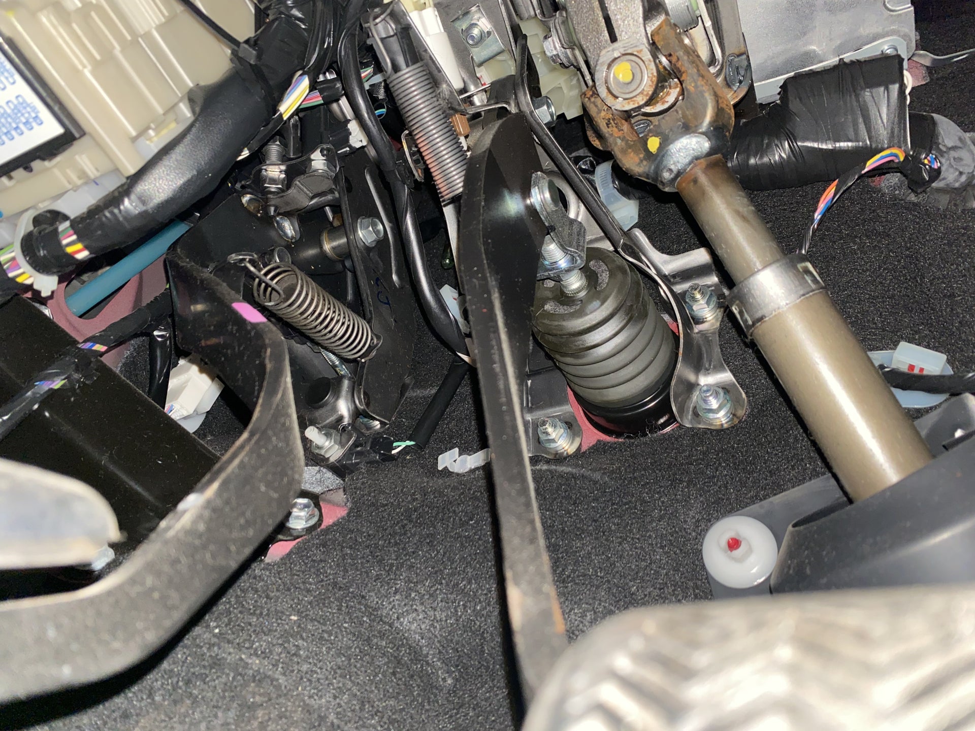

Anyone have knowledge of a 2009 Vibe clutch pedal return spring and where it might attach? I have searched all over, on-line, and there is little to any information on this.
Thanks!

Can someone please post photo(s) of where the clutch return spring attaches on both ends under the dash?
Thank you! Doc Doug

Here's a few pics on my 2.4L clutch pedal. Not sure if this applies to the 1.8L engines. I have a snake camera which I may use to get even closer pics if needed.

GREAT photos. Thank you! I am picking up the new spring today from my local Toyota dealer.
When the dealer specified a 1.8L, which is my Vibe, she said no spring is listed. When she removed the 1.8L from the search, leaving just a 2009 Toyota Matrix, the spring appeared.
Having said that, now I am second guessing if my 2009 1.8 ever had a spring to begin with? The spring seems that it would take up the slack and pull the clutch pedal towards the floor.
Does anyone have a 2009 or 2010 Vibe with a 1.8 manual transmission that can confirm if this spring is present or not?
