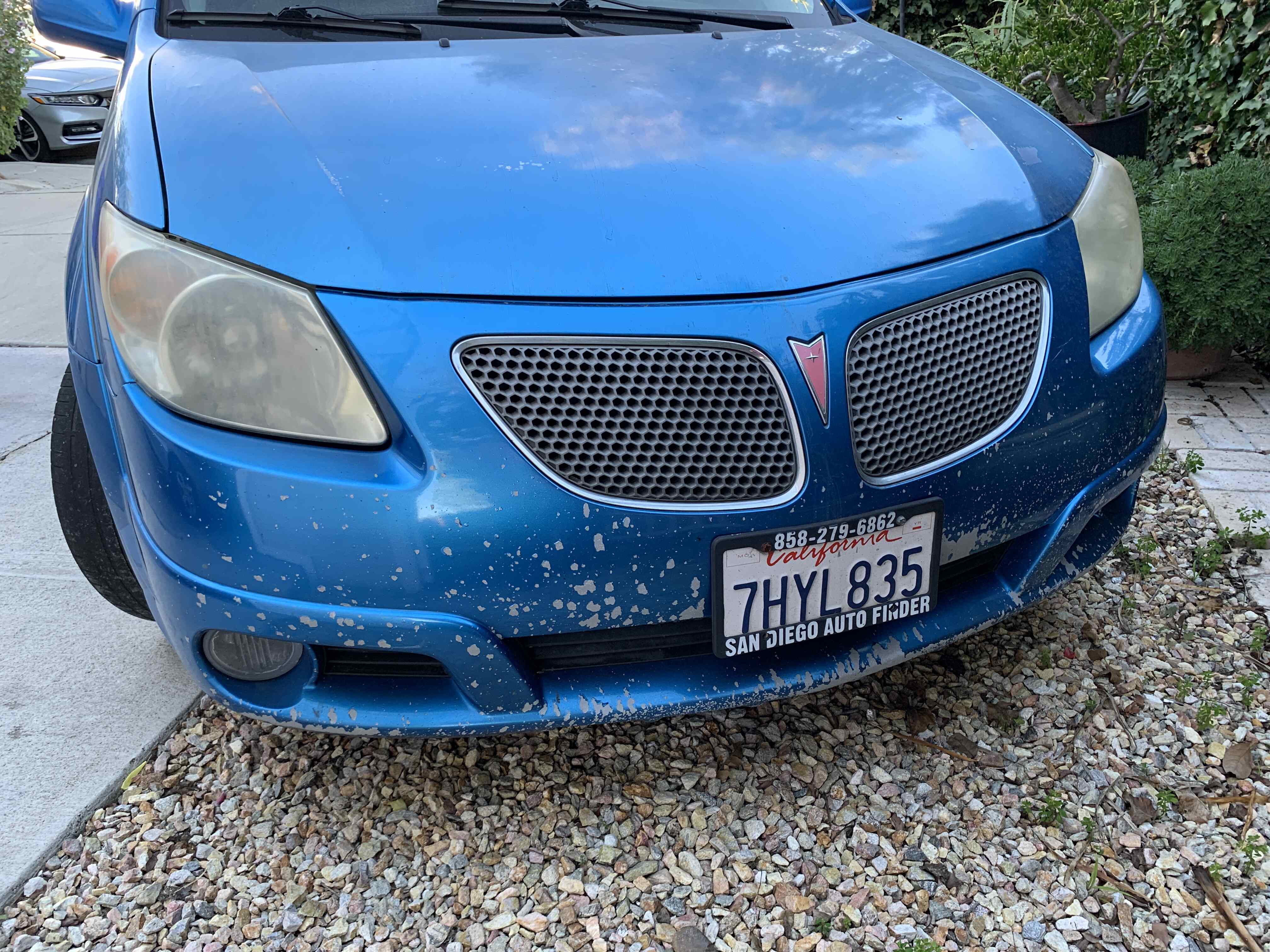

This is the Vibe that I picked up for $1500 in rough shape. I plan to restore it to former glory, but my budget is $2500 total (not including paint). These are the pictures as I bought it. I sold my 01 Honda Accord which ran beautifully with a nice stereo system for $2500, so this is where my budget comes from.

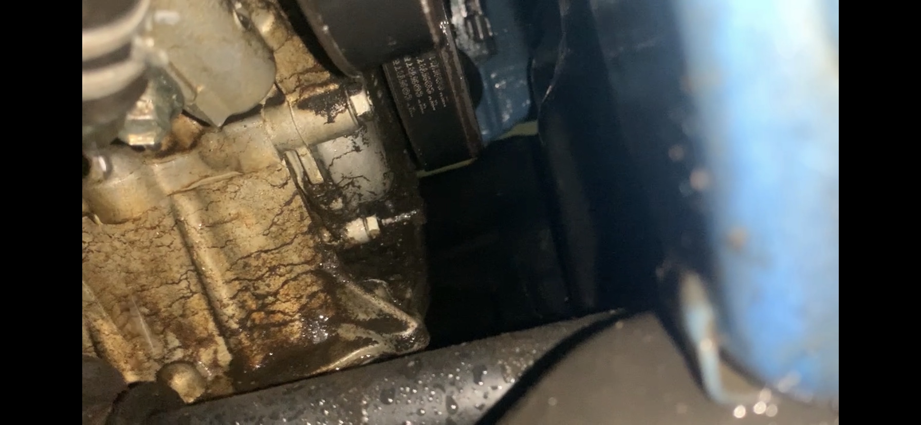

Appears to be a significant leak at the rear. I am hoping it is as simple as the power steering o-ring to the drain flange, like other Toyotas.
Before and after an engine wash. Hard to reach back there! If it is not the power steering o-ring, then it should be the timing belt tensioner o-ring which is up higher. However, when I felt under it, the oil was not wet.

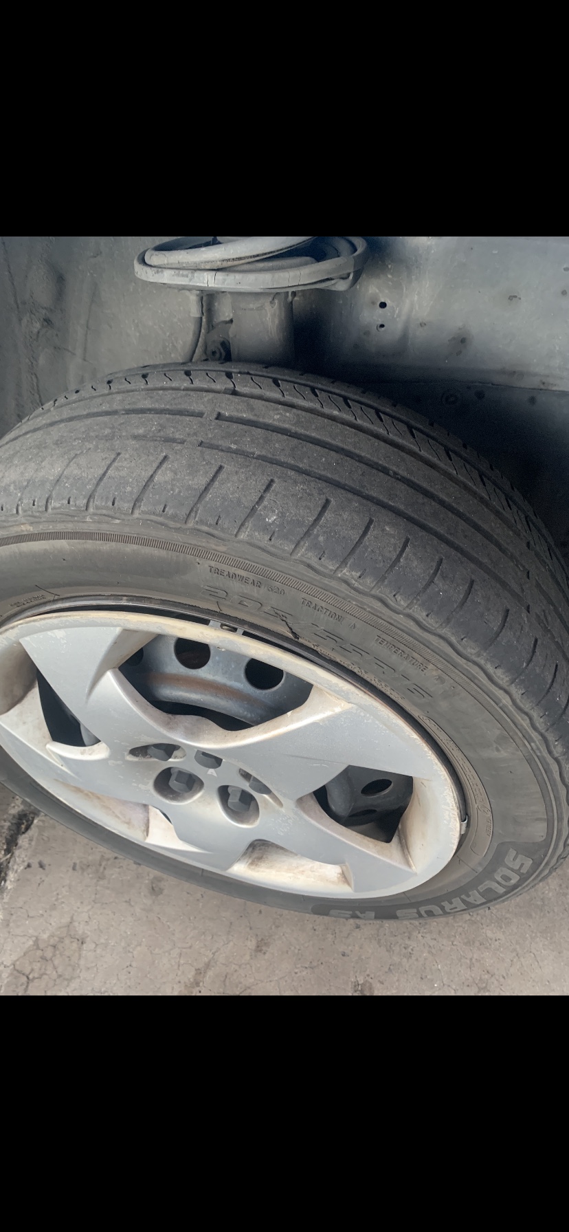

The car had a heavy shimmy above 60MPH. The driver side had outside wear, the pass side also very worn. The rears have lots of meat, generic brand.
I was going to get new tires all around but since I am hunting for alloys, I just needed to get something for now.
I picked up a used set of bridgestone with lots of tread for $100 installed. Not the best deal, but not bad either. The tire guy showed me the driver front wheel on the balancer, it is way bent. So, I have to find another steel one to replace it. Luckily it is only $15 labor to swap it out.
Even though the rim was bent, replacing the tire and balancing it removed the high speed shimmy.

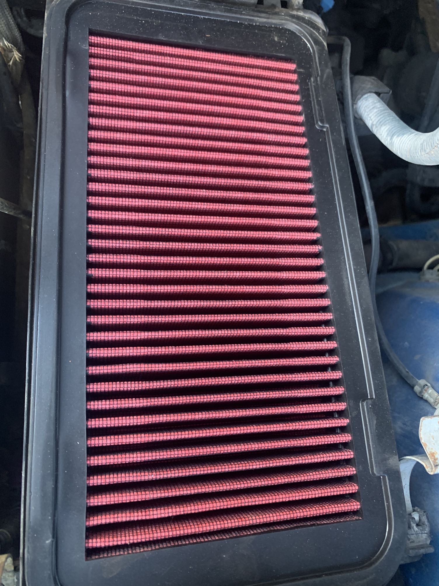

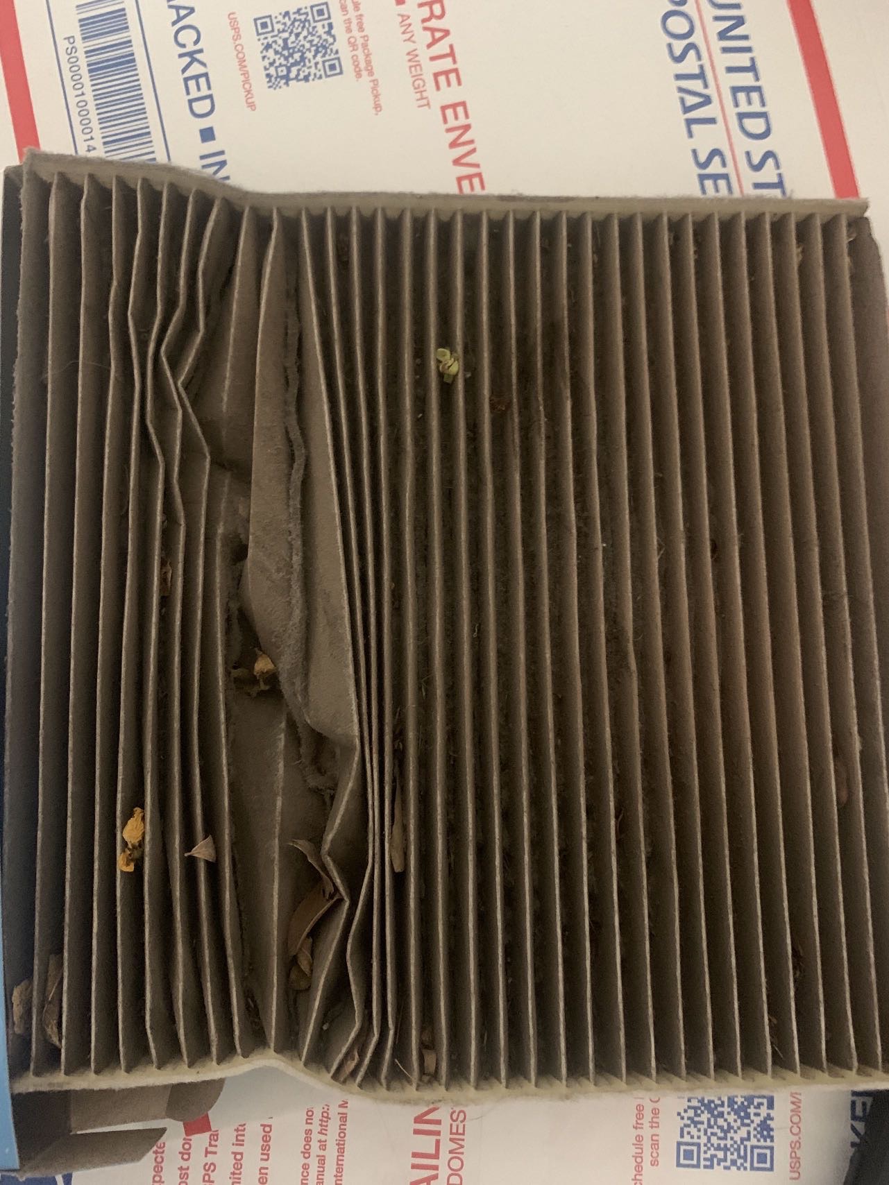

Today was "filter" day. Replaced the cabin filter, air filter, and the airbox mod.viewtopic.php?p=533290#p533290
High flow insert filter $27
Cabin Filter $13
Mod $FREE
Cabin filter YUCK!

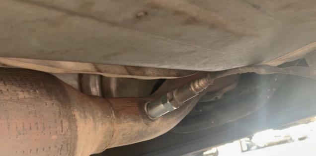

-Passed smog, using the o2 extension/defouler trick. When the o2 sensor is extended out of the exhaust path, it no longer throws a P0420 code. In fact, the Catalyst Monitor cleared in only 5 miles of driving. Finally I get legal tags and title in the savage smog state of California. Someday I may just gut the primary cat because based on what I have seen others have going on in the corolla forum it is probably half plugged and robbing me of 30+HP (kidding LOL), but still.

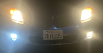

-Installed LED fog light bulbs ($20). They are more "white" than the halogen bulbs, but the housings are so pitted that difference is not amazing. I think after I get the bumper painted I will put clean housings on to take advantage of the extra brightness.

While I was under there I went ahead and looked at this leak on the exhaust side of the engine. Even though I attempted to wash back there, there is still oil or something everywhere around the power steering pump. Getting a fresh look from the bottom, it is higher than the pump. Again I blame the timing chain tensioner o ring but it is hard to see. Now that I have the jack, I should do an engine wash again but with it jacked up so I can reach those areas and get it fully clean.

I had the tensioner leak. It can be reached from above, wiped with a rag to check. I replaced the tensioner and it ran quieter.
