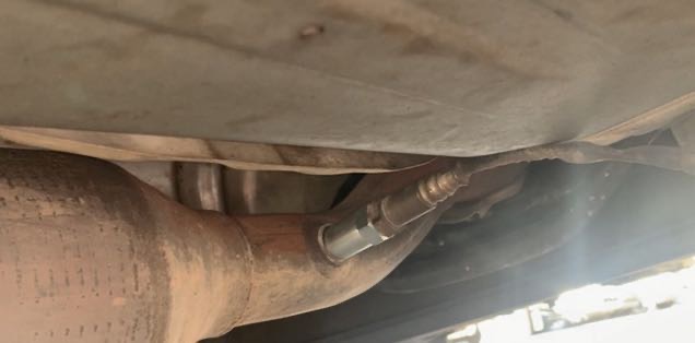

-Passed smog, using the o2 extension/defouler trick. When the o2 sensor is extended out of the exhaust path, it no longer throws a P0420 code. In fact, the Catalyst Monitor cleared in only 5 miles of driving. Finally I get legal tags and title in the savage smog state of California. Someday I may just gut the primary cat because based on what I have seen others have going on in the corolla forum it is probably half plugged and robbing me of 30+HP (kidding LOL), but still.

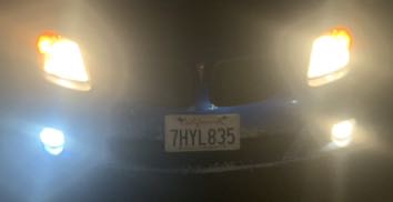

-Installed LED fog light bulbs ($20). They are more "white" than the halogen bulbs, but the housings are so pitted that difference is not amazing. I think after I get the bumper painted I will put clean housings on to take advantage of the extra brightness.
