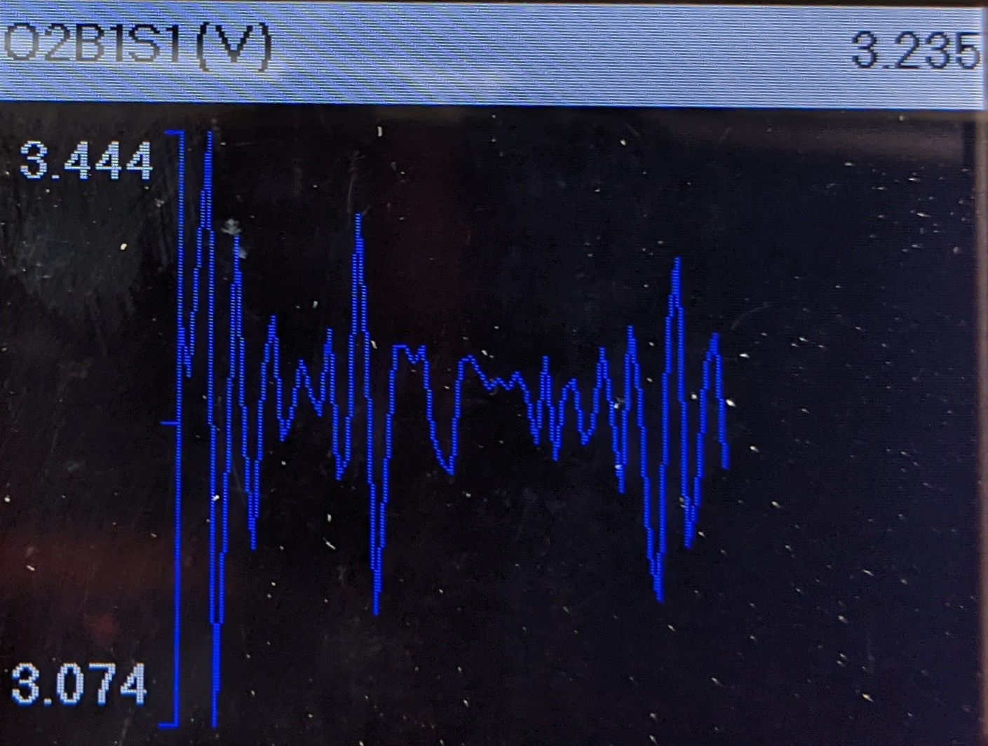

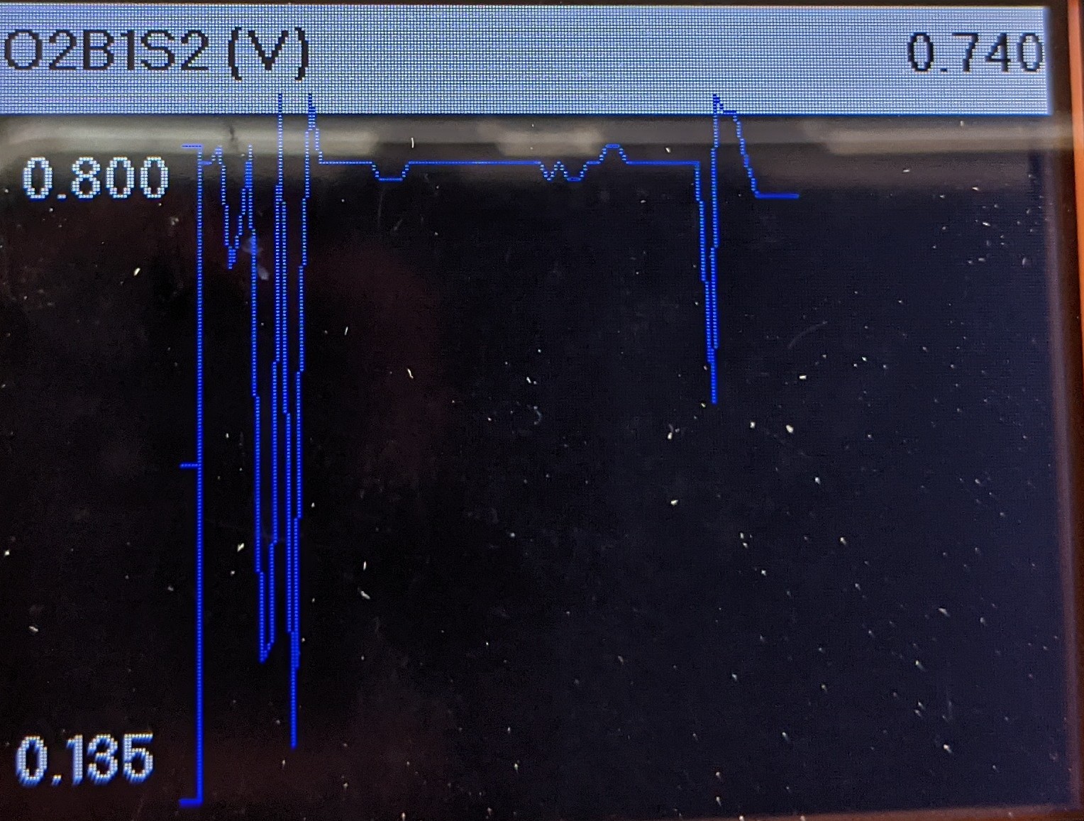

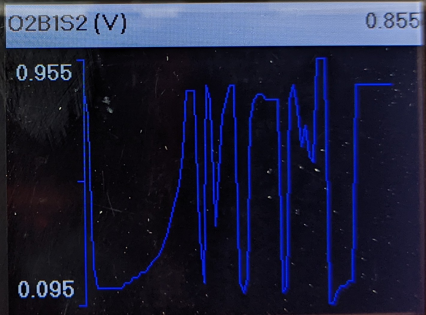

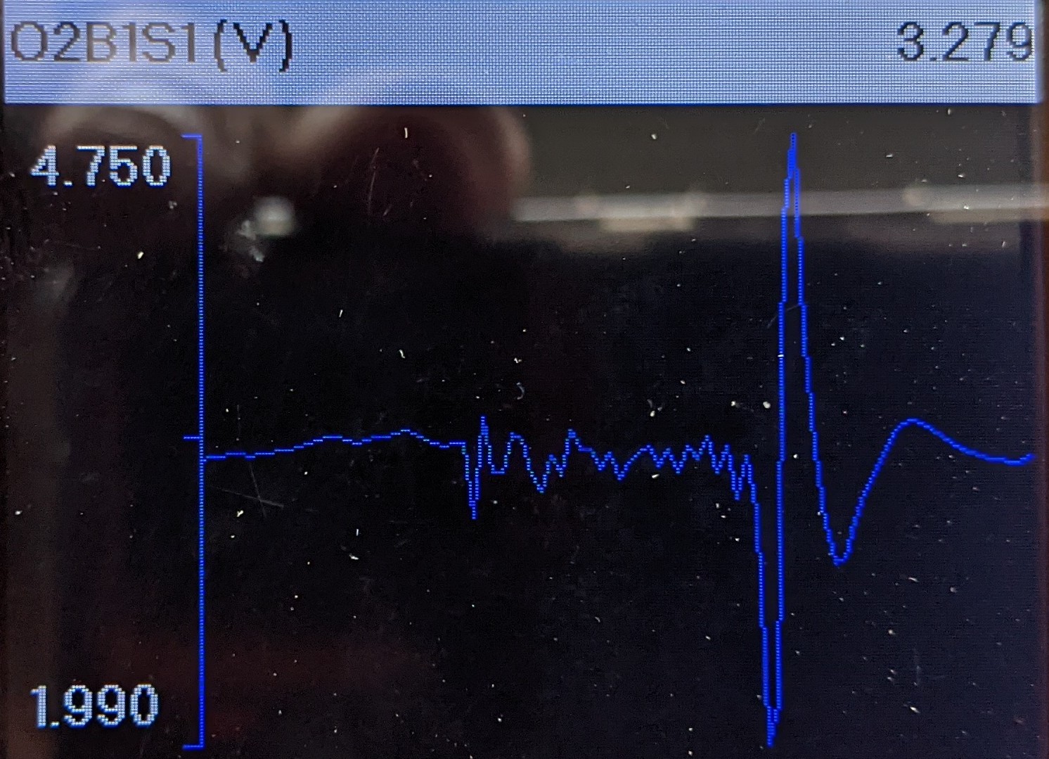

OK, so it turns out that my code reader does have the option to plot a graph of a single parameter. I spent some time this morning getting plots of the O2 sensors. I'd appreciate it if someone could tell me what these plots suggest, although admittedly I'll most likely have replaced the sensors before I get a reply as I'm anxious since my car currently has expired tags.
The following is the upstream sensor while accelerating at a moderate rate:
The following is the downstream sensor while accelerating at a moderate rate:
The following is the upstream sensor. The first third or so is idling at a stop sign. The second third is accelerating at a moderate rate. The third third is coasting.
The following is the downstream sensor. The first third or so is idling at a stop sign. The second third is accelerating at a moderate rate. The third third is coasting.
Thanks so much in advance for any other suggestions on getting my car fixed,

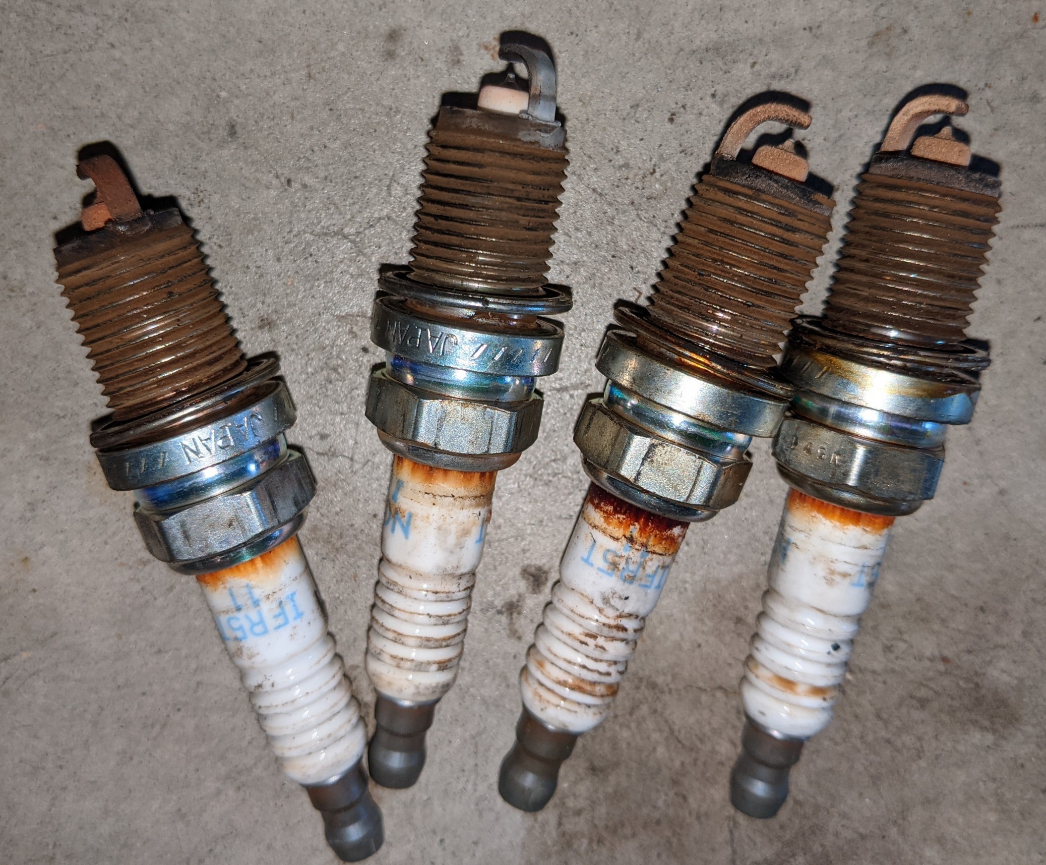

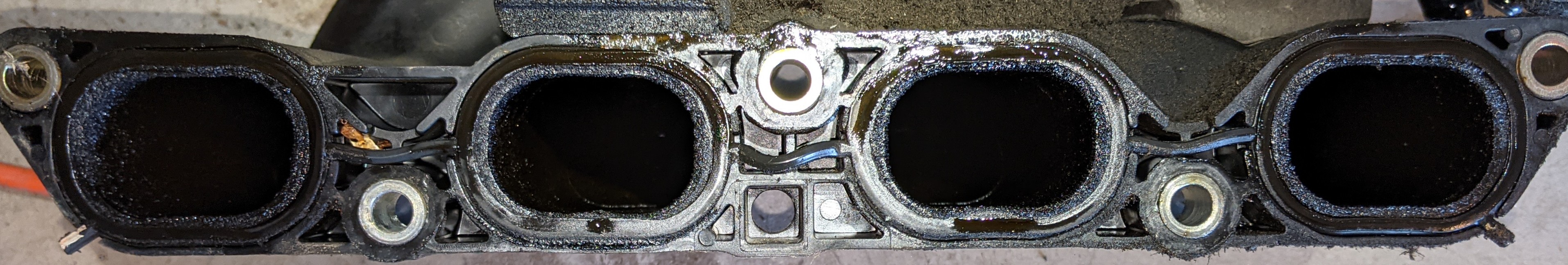

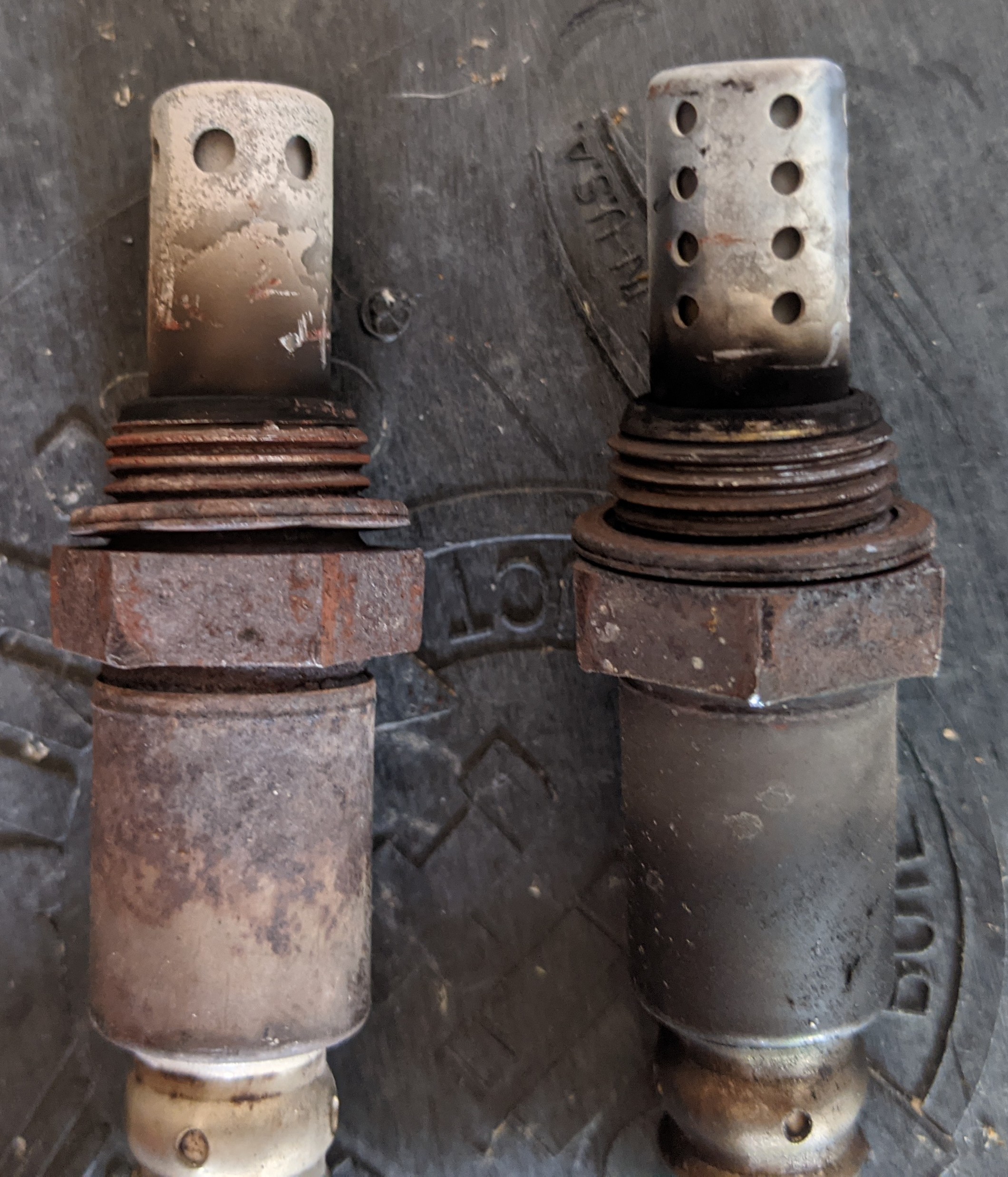

tldr: I replaced the catalytic converter, both O2 sensors, intake manifold gasket, and spark plugs. I still have P0420. Please help!
I replaced the upstream O2 sensor, reset the computer, and went for a test drive. The P0420 appears in the pending list after 5 minutes of driving.
I replaced the downstream O2 sensor, reset the computer, and went for a test drive. The P0420 appears in the pending list after 5 minutes of driving.
I believe these were the original (271K miles) sensors. Upstream sensor is on the left; downstream sensor on the right:
I already had the intake manifold gasket on hand and figured it wouldn't hurt to replace it since it's gotta be done sometime anyways. Maybe it's the culprit? ... Nope! :( While I was at it I replaced the spark plugs. I reset the computer and went for a test drive. The P0420 appears in the pending list after 5 minutes of driving.
Anybody have any ideas I should consider for my next step to fix the P0420?
Spark plugs in cylinder order (left is cylinder 1; right is cylinder 4):

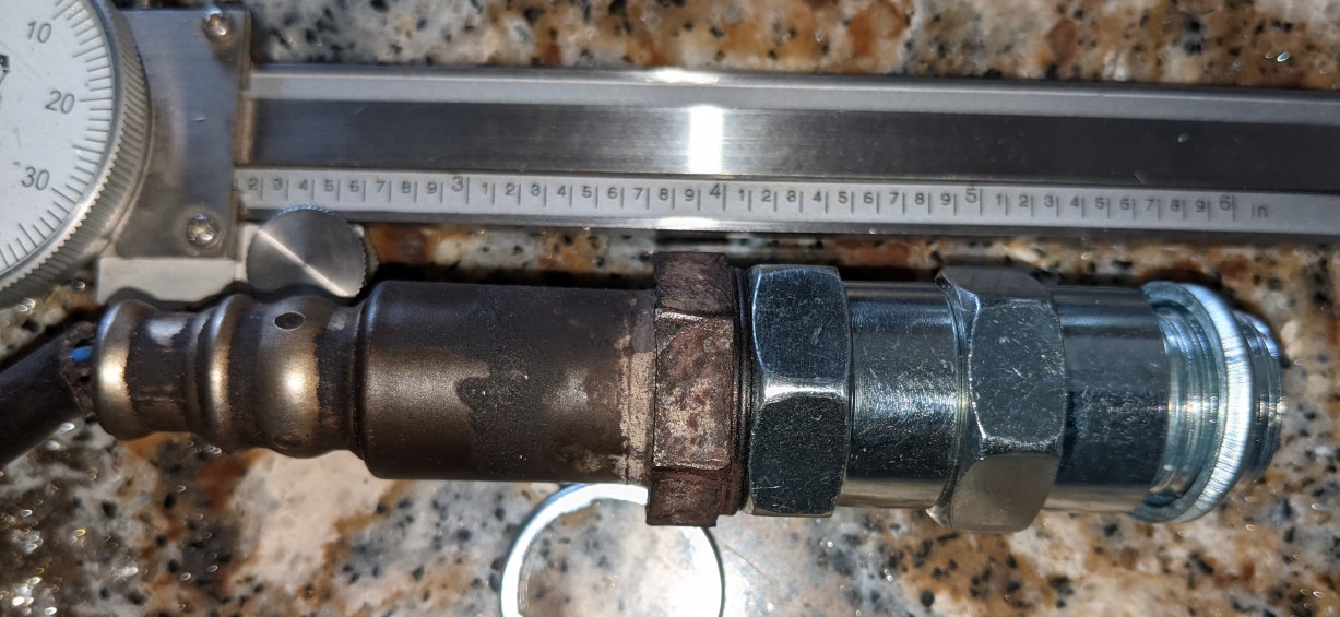

Whoa! The non-fouler trick may have "fixed" the car.
I've driven the car three times so far, for at least 40 minutes total drive time. No set codes, no pending codes, catalytic converter and O2 sensor drive cycle monitors are showing ready.
The evaporative system monitor is the only thing missing, and I read something yesterday that suggests I might even be able to pass emission test without it here (in Missouri). I plan to take it to get tested as soon as possible and will update this thread with the results.
For future reference I've included information and images following.
I believe the link to the non-fouler above is for non-fouler that won't work for this O2 sensor. The link points to the Dorman 42006 which lists a 14mm thread size (outside diameter of theads). I have the Dorman 42009 which has 18mm threads and fits my catalytic converter assembly's pipe hole and O2 sensor after one of the non-foulers was modified.
I drilled the hole out of one of the non-foulers. There's a small hole and then the inside diameter of the body of the non-fouler is larger than the small hole--both get drilled as the drilled hole was larger than the inside diameter of the body. I used oil to help the bits cut the steel and I used 5 or 6 bits ramping the size up a bit each time. I used a wrench to center the non-fouler on the drill press plate
The unthreaded portion of the O2 sensor that slips into this drilled out portion of the non-fouler has a diameter that is somewhere under 0.48". My final, largest bit used had a diameter of about 0.48".
Threading an O2 sensor into the first non-fouler one can see that the tip of the O2 sensor comes nearly flush with the end of the non-fouler.
I threaded the modified non-fouler into the other unmodified non-fouler.
I saw elsewhere that suggested some applications of this method doesn't work using both non-foulers and suggest not using adding the unmodified non-fouler onto the assembly that'll be screwed into the catalytic converter assembly's pipe hole. I planned to try removing the additional unmodified non-fouler and use only the modified one if the two non-fouler application didn't prevent the P0420 codes. We'll see how this goes.
Note that I used the crush washer/metal gasket on the end of this assembly when screwing it into the catalytic converter assembly's pipe hole and the crush washer/metal gasket end up being crushed non-uniformly. If I wasn't so lazy I would've backed the assembly out and used the assembly without one. In the end it probably won't make much difference either way.
Thanks again!
