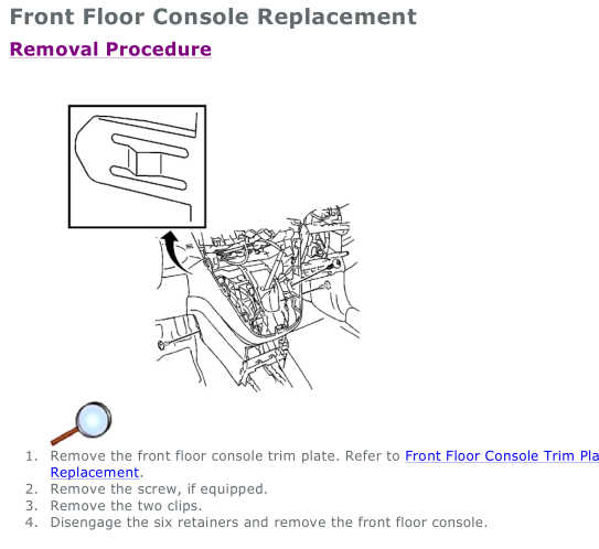

Here is info in attachments (not in order and not step by step) You should be able to figure out what needs to be done. This is to show plastic clips (that break) and can not be replaced without replace the panel. The upper panel around the radio is on by clips too. Last thing is the PDF file about the outlet and how that is clipped in.
If you need more info, I would suggest you pay for subscription at AlldataDIY as this site has a limit to file size so all info can not be posted. Good luck with the clips as the dealer broke some of mine around the steering column when a air bag recall was done. This is not a 10 minute job.
