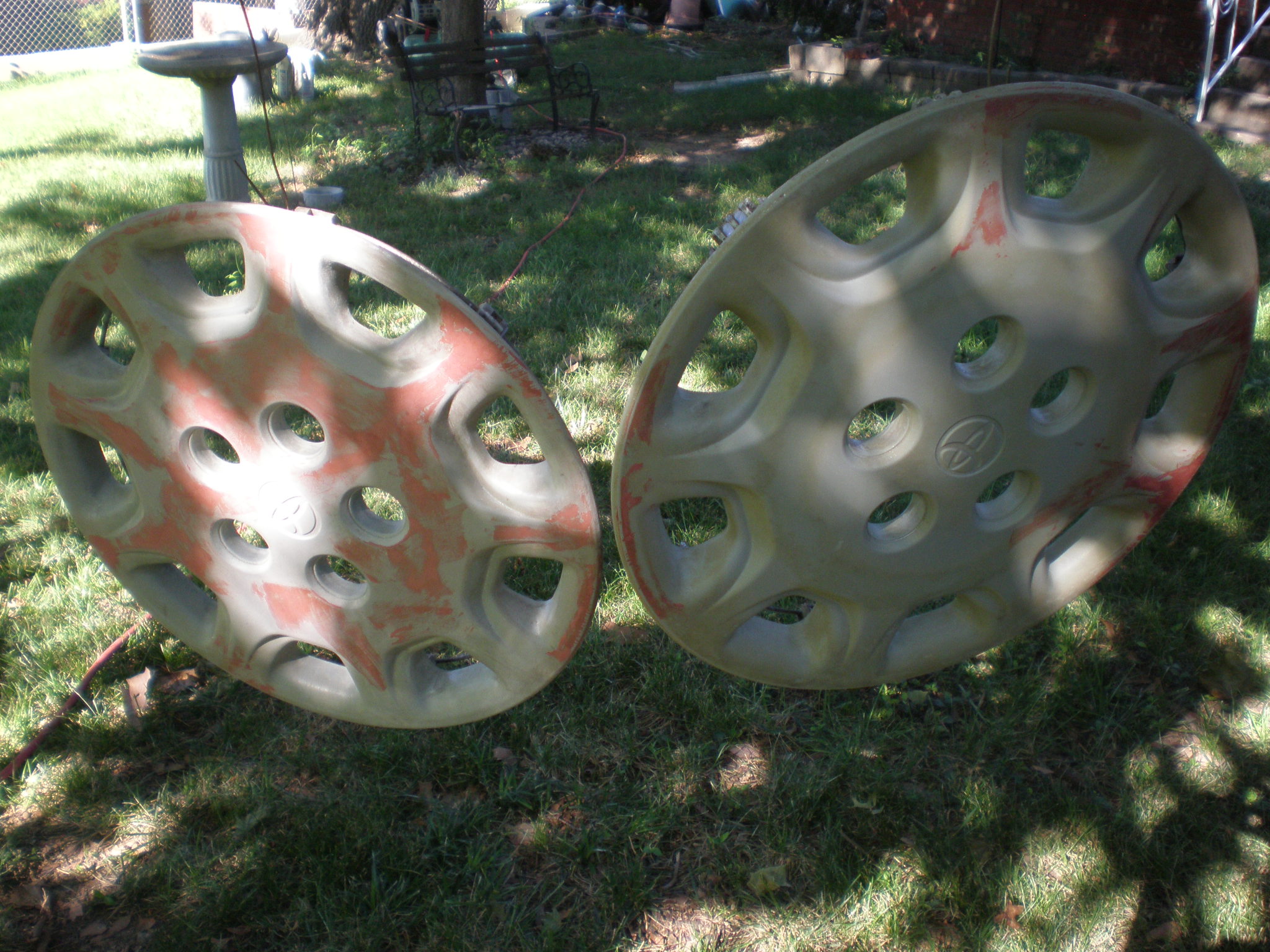

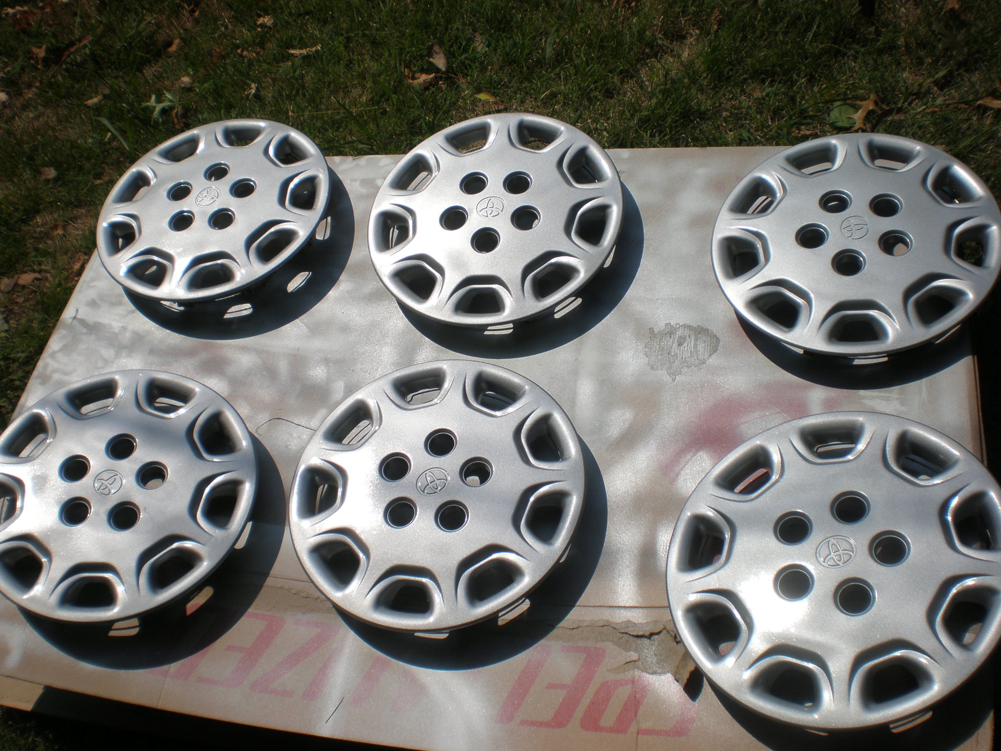

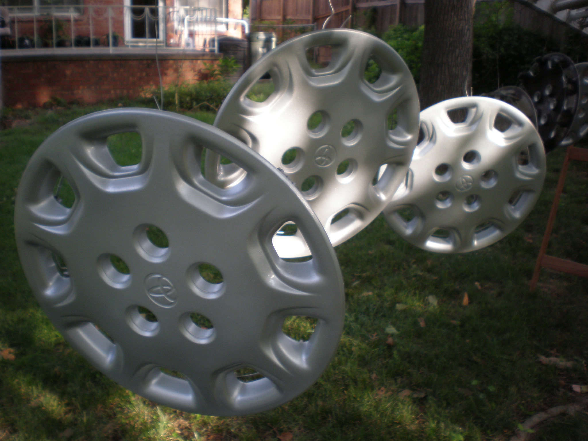

Fwiw, I had very good luck refinishing some old plastic wheel covers by sanding to remove most of the paint, filling in any large scratches or blemishes with a glazing putty (that is the red product in the first picture), then sealing the covers with an epoxy sealer (i.e. epoxy primer that is thinned down) - this step is not pictured; and then a final top coat of a single stage silver urethane.
However, one can easily have $80-100 just in material cost as I did. After two years, the paint has not come off except a small area where I ran up against the curb (which would have damage an alloy wheel as well).
