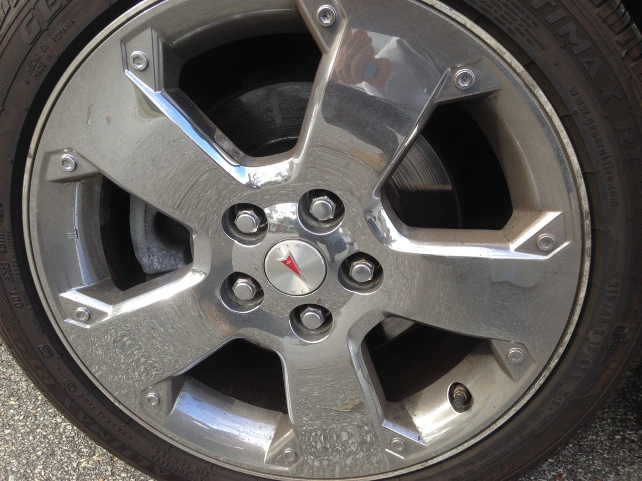

I have a 2009 Vibe with what I thought were chrome or polished aluminum wheel covers. On closer inspection they appear to be plastic (?), with decorative (fake) nuts around the perimeter. I would like to remove them for painting but am confused about how to get them off without breaking.
They are NOT held on by the lug nuts and they appear to wrap the actual hub metalwork. Can I just pry them off around the edges with a screwdriver? Are they glued in place!?

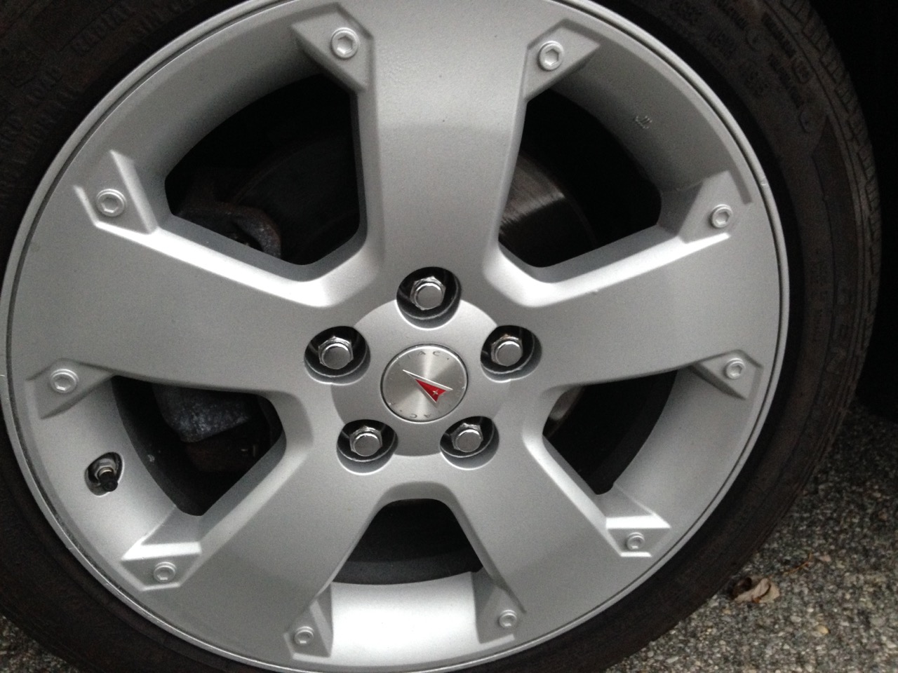

One of our 2nd Gen members could confirm, but I'm pretty sure the only plastic on that wheel is the center cap. The rest of the wheel is aluminium alloy.
The mark at 9 o' clock in the second picture is the Japan Light Wheel Alloy certification.

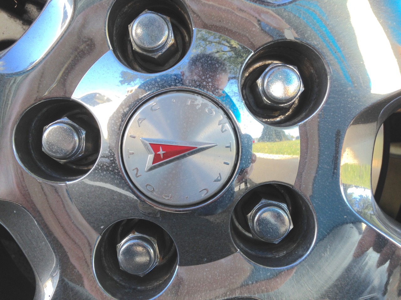

I think that's exactly what I'm going to do: remove the wheels from the car, mask off the tires, remove the center cap, and spray paint them. I'm actually looking to get away from the chrome look and go to black. My first time doing this so hope this is the right process...
  • rough them up with 0 or 00 steel wool
  • apply a spray adhesive promoter (Dupli-Color Adhesion Promoter)
  • spray paint (Dupli-Color gun metal wheel coating -- EDIT I ended up using silver color)
  • matte topcoat (Dupli-Color wheel top coat)

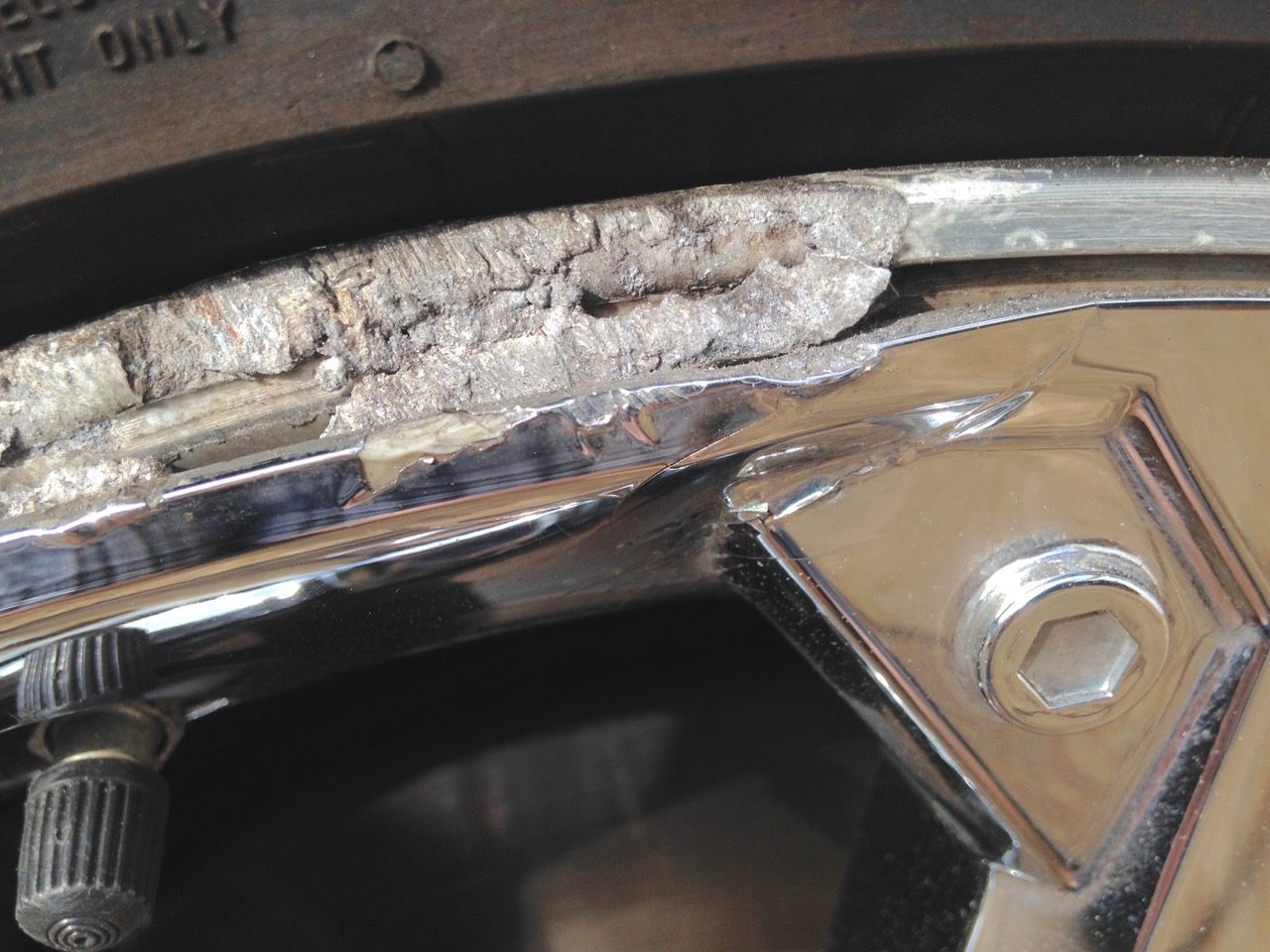

To set the record straight, there are essentially 3 layers as shown here where the previous owner hit a curb: The alloy hub itself, the plastic wheel cover which appears to be glued to the hub, and a thin layer of aluminum/chrome foil wrapping the wheel cover:
So what you're looking at is real aluminum (foil) on the surface, and I found it polishes up real nice with fine steel wool. I'll post photos of the results from painting it later this weekend.

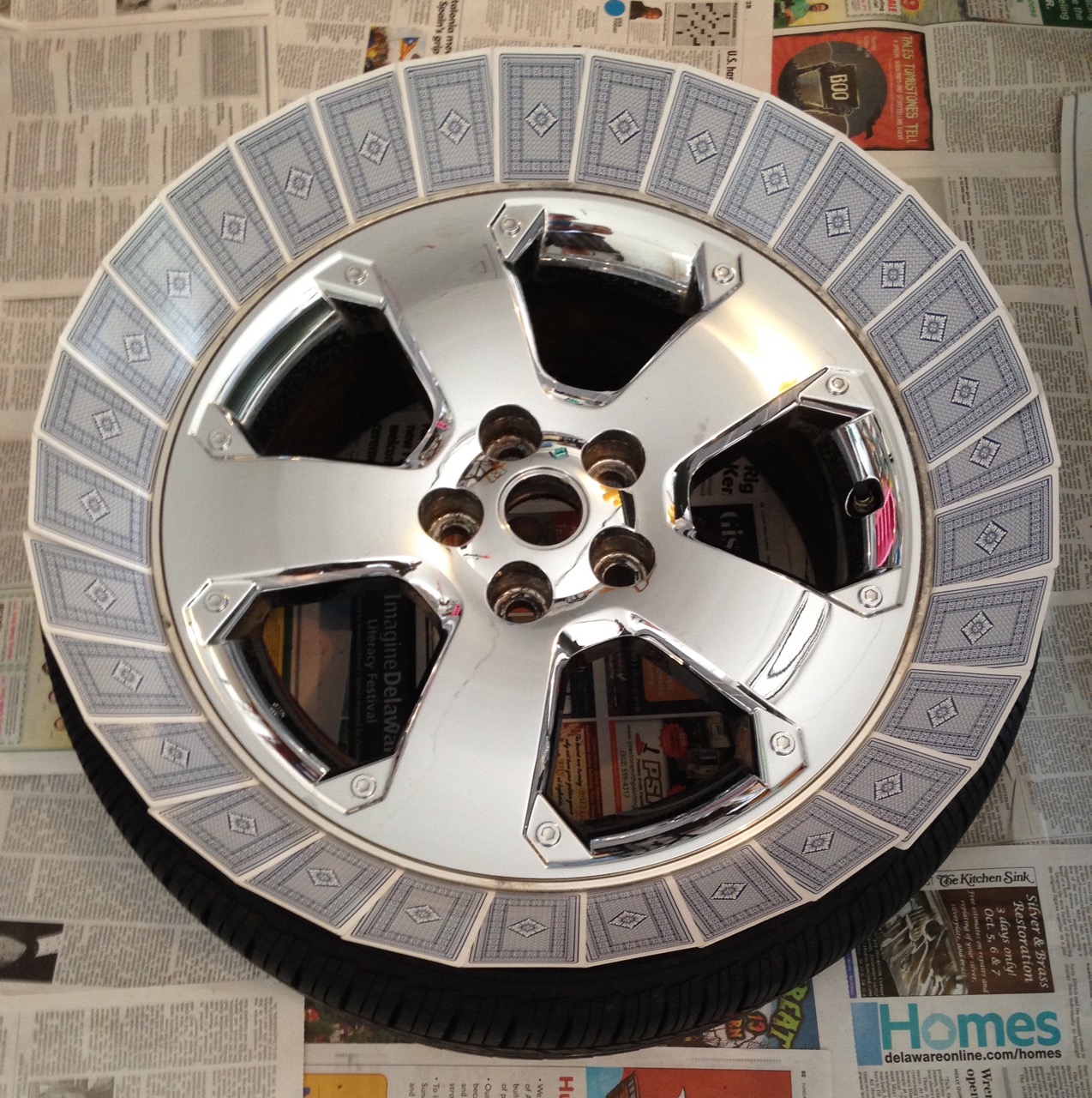

I got cold feet about painting the wheels a dark or black color, because I still like the lighter metal color and because I was concerned that scratches and wear would be more visible. So I went with silver color.
Here is the wheel prepped for painting. Someone at work suggested this trick using playing cards to mask off the tire:
I applied 3 coats of Dupli-color adhesion promoter, 3 coats of Duplicolor silver wheel coating, and a couple coats of Duplicolor matte wheel clear coat (I'm not sure how important the clear coat is, and left it off the wheels on one side of the car because I was in a hurry.) Here is before and after.

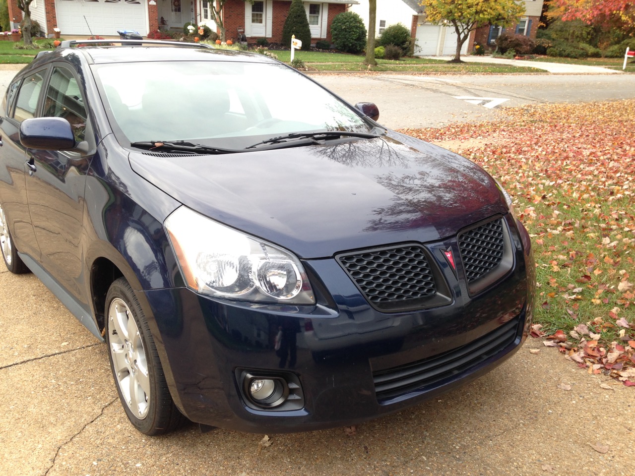

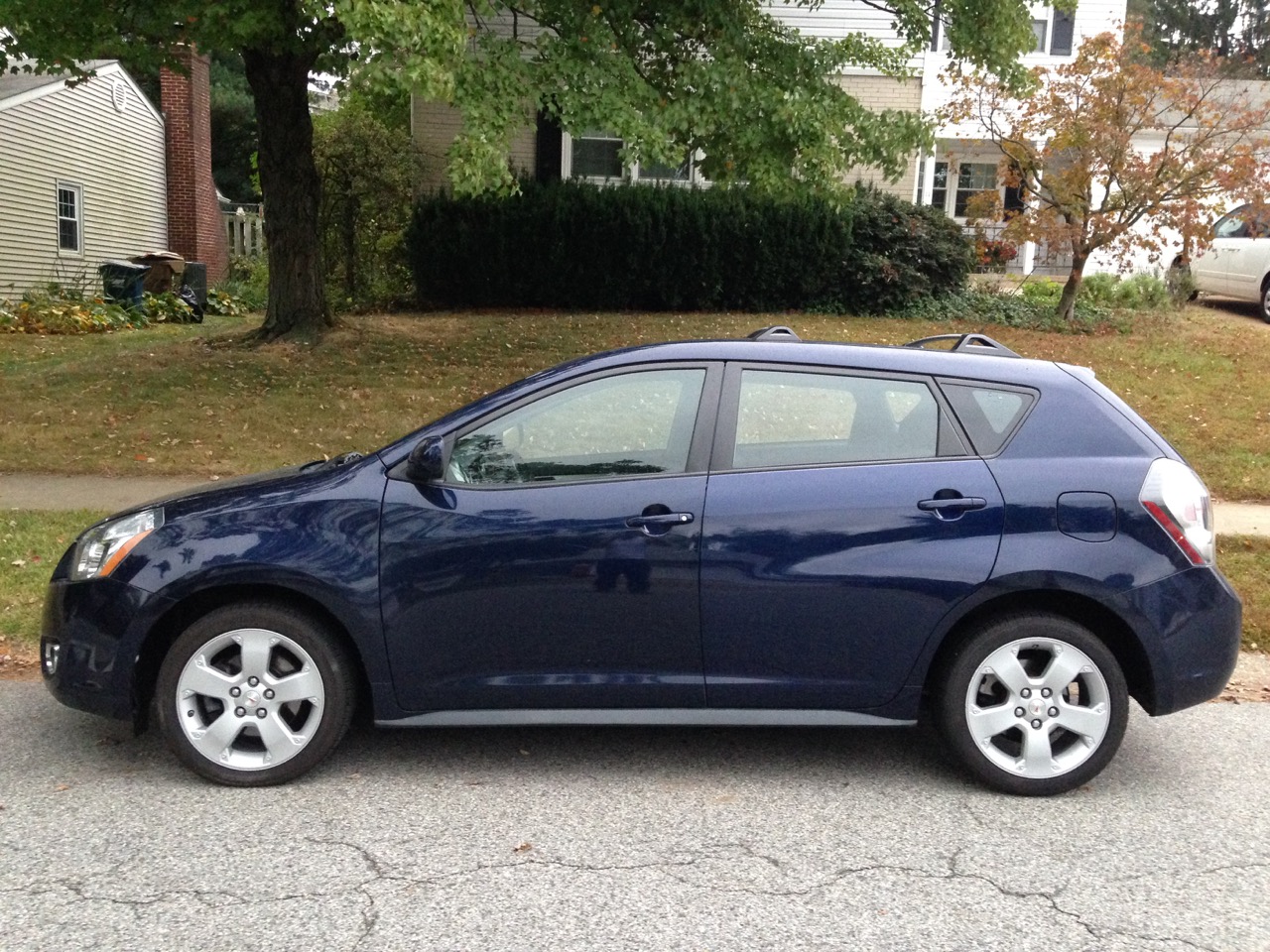

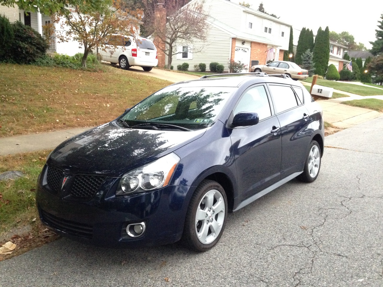

Here are before and after photos showing three changes: (1) painting the wheels silver, (2) painting the front grille trim black, (3) painting the roof rack plastic boots black.
Some people might prefer the "before", but I'm happy with the results!

To complete the look, I also "dechromed" the Pontiac emblem and the fog light surrounds (in addition to the grille surround done earlier) by masking, spraying adhesion promoter, and spraying black.

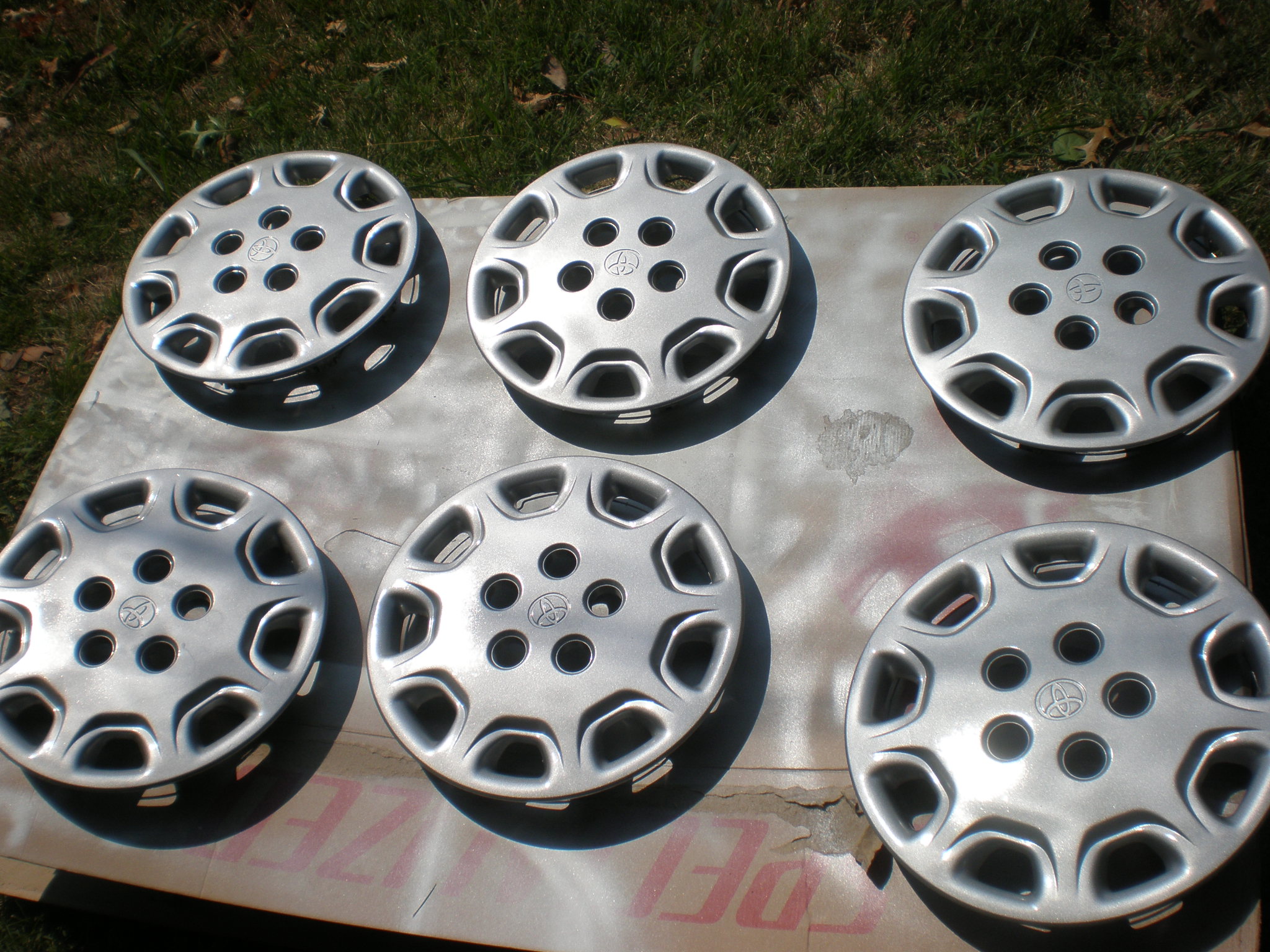

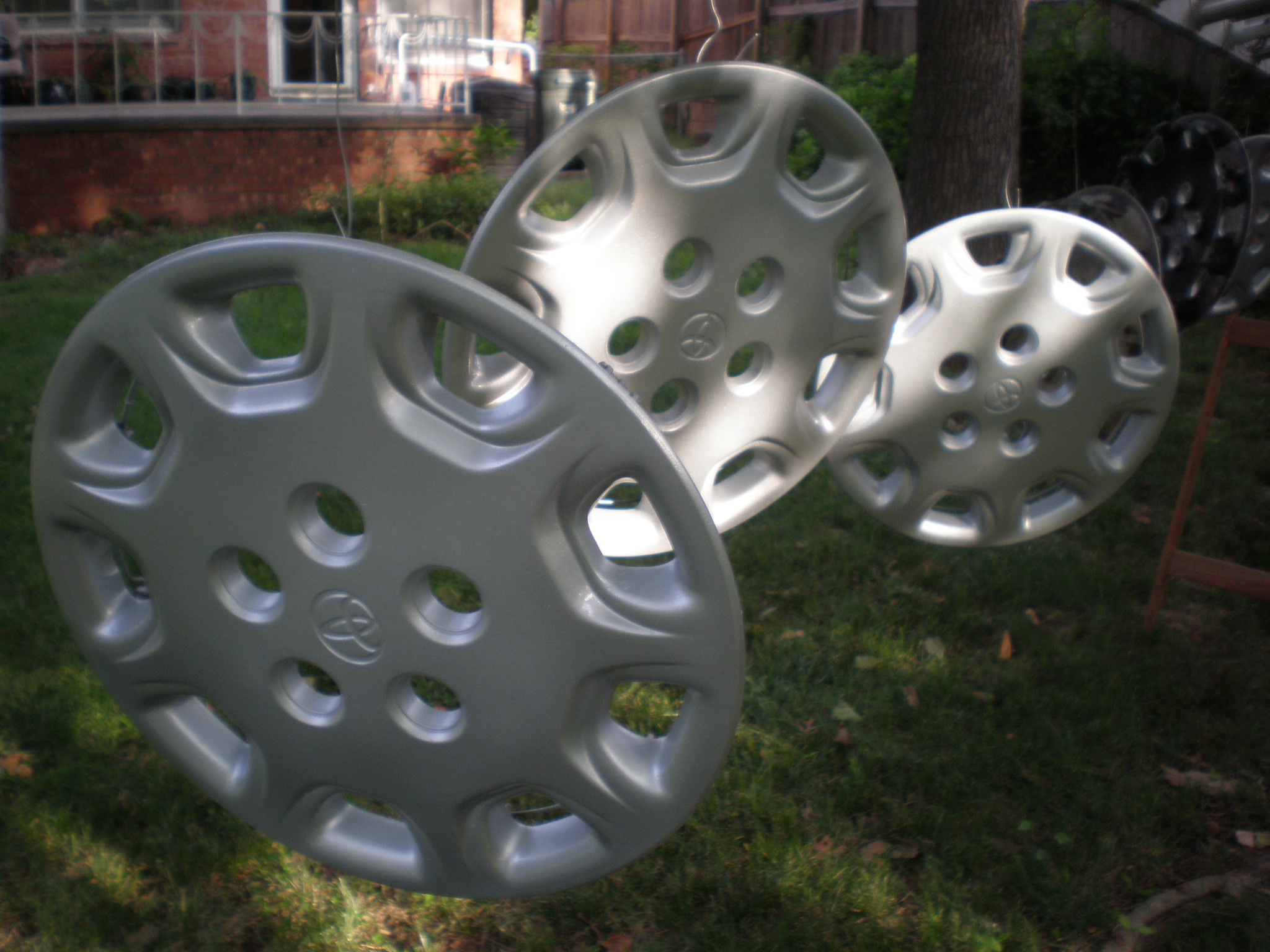

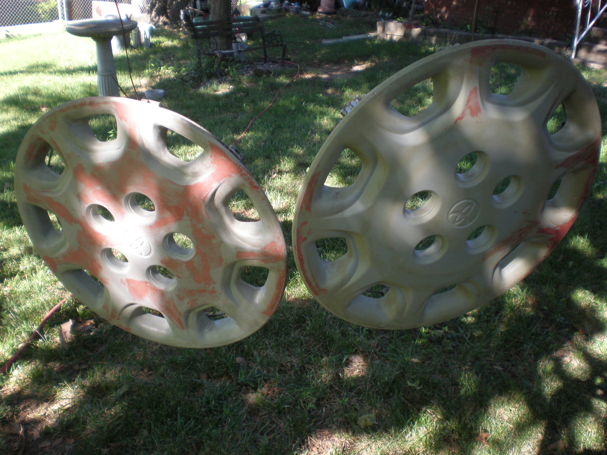

Fwiw, I had very good luck refinishing some old plastic wheel covers by sanding to remove most of the paint, filling in any large scratches or blemishes with a glazing putty (that is the red product in the first picture), then sealing the covers with an epoxy sealer (i.e. epoxy primer that is thinned down) - this step is not pictured; and then a final top coat of a single stage silver urethane.
However, one can easily have $80-100 just in material cost as I did. After two years, the paint has not come off except a small area where I ran up against the curb (which would have damage an alloy wheel as well).

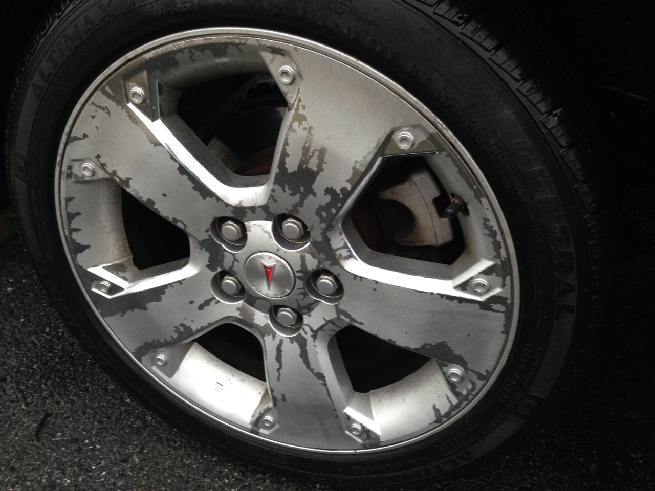

After two more winters, much of the paint is worn off of the remaining wheels, which look like a crappy patchwork as a result. In hindsight the best way to dull the chrome look might be to sand it.
I might sand them at this point to remove the remaining paint. I'm a little nervous to do this while the wheels are on the car though, because of getting grit into the disk brakes...
