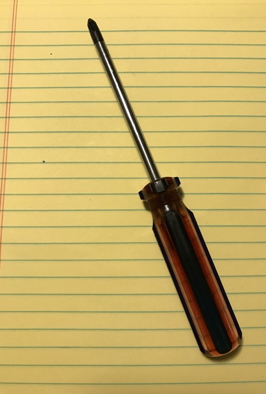

Thank you for the replies. I was able to get the scredriver out with a magnetic pick tool.
The screwdriver is not very small. I am suprised it did slide down the intake (that leads to the 2nd piston?).
After lying in the intake for one day, some oil ate into the clear plastic handle and turned it to brown color (see picture).
What might be cause of the oil in the intake manifold?
Thank you.

Stuck or failing PCV valve could let oil into the intake.
Re: I dropped a screwdriver into the intake
I agree with Derf. It also most certainly means that the intake manifold gasket is bad or going bad.
