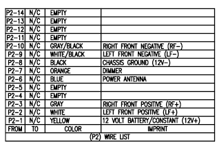

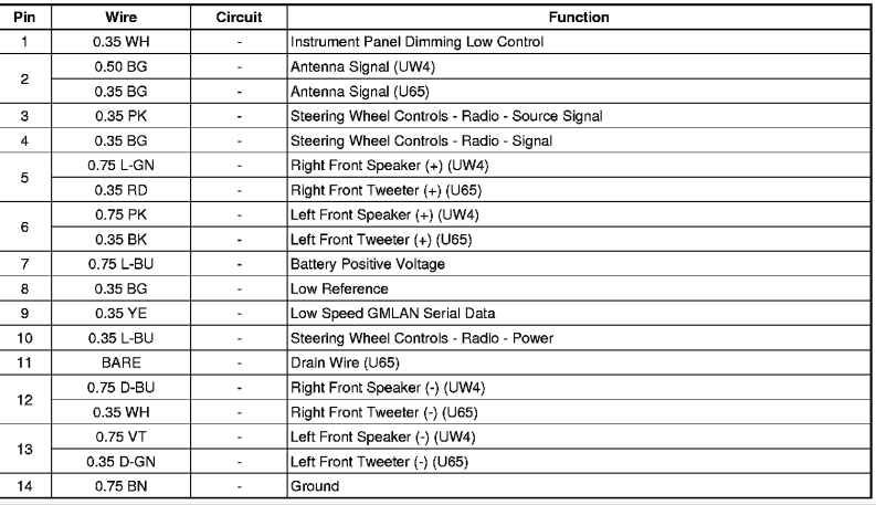

This is the wiring diagram for the GM18B. Looks like the orange wire is there. So I move the 12V from P1-16 to P1-12? Is there a wiring diagram for the stock/car-side connector?

It looks like I may have meant position 13. It's still 4th from the right on the 16-pin connector. The wiring you list for the 14-pin connector looks fine, though they count differently (7 on the GM diagram is 1 on yours). Check the colors in the car harness to make sure things line up correctly.
The dimmer and antenna control seem to be in the right place. The Vibe has a stubby antenna and employs an amplifier powered by the head unit, so the antenna control from the head unit has to be connected.
