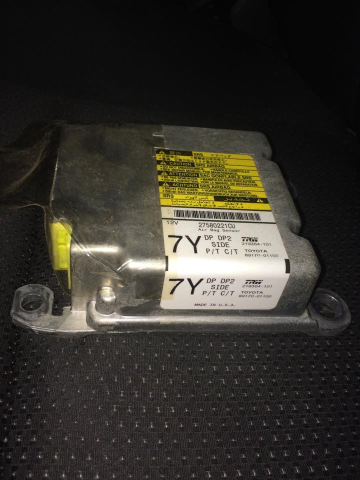

The same part that cost $416 from the GM dealer cost $120 from Toyota.
Toyota part #: 89170-01100
GM part #: 19184922
The SDM module I took out has the Toyota # right on it.
I'll probably have to bring it back in to the dealer to get it programmed, we'll see.

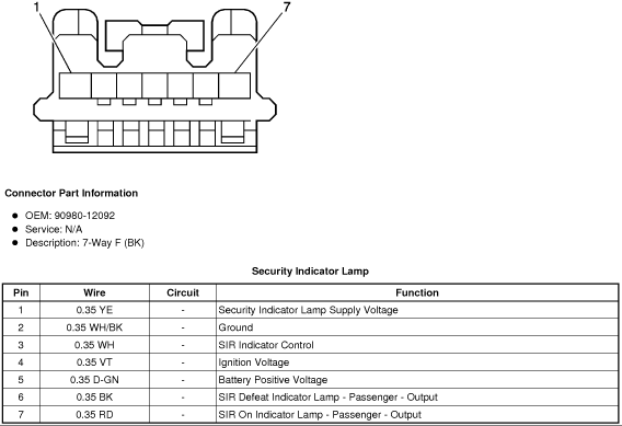

Tim, don't worry about it. I used a procedure from an earlier Toyota Matrix I found on the web. The connector on the airbag indicator lamp was different, found a diagram of it though.
I ran through the diagnostic, wiring is good as is the indicator lamp, must be the main airbag computer. Just ordered it.
For future reference, here is a 03-07 Matrix service manual section for the 43 airbag code:
https://worldtracker.org/media/library/ ... 280015.pdf" onclick="window.open(this.href);return false;
Attached is the connector diagram for the airbag indicator light plug. Wires 6 and 7 are P-AB and PAON from what I can tell.
I am going to try using a Toyota part # to see if that module will work instead of the GM sourced module. The one in my car says Toyota on it and has the Toyota part # on it.

That did it! No reprogramming necessary. Replaced the air bag computer and the code 43 is gone. Had to take out a good bit of the middle console to get to the air bag computer.
I used a new Toyota part, $300 cheaper than the same Pontiac part.
Hopefully someone else can save themselves $780. It cost me an extra $200 for the GM folks to diagnose it (twice)
