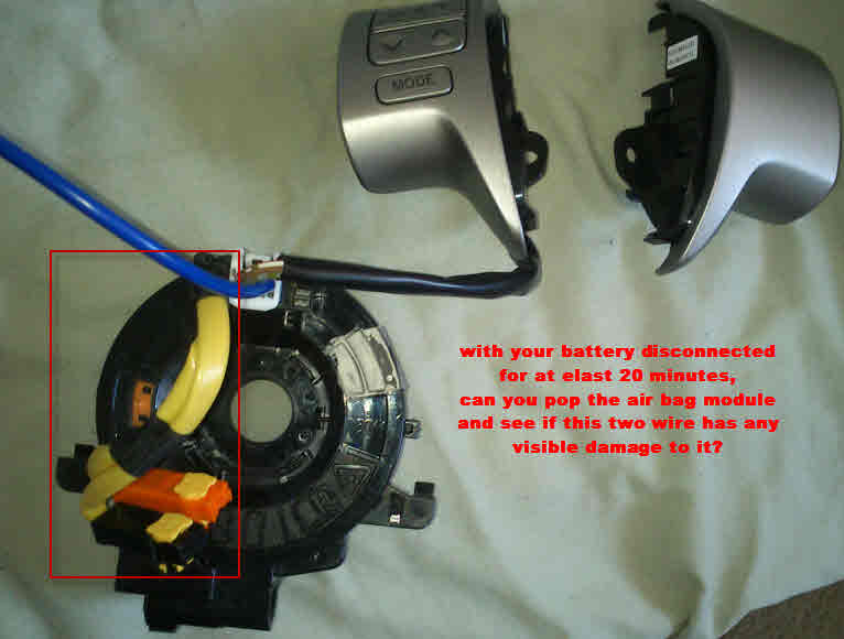

you might need to do a final check and see if the pig tail wires, orange and yellow for visible damage or does the safety clip are fully plug in? or weird twist.. other than that you need to go to junk yard to get a 07 camry/08+highlander, 09+rav4, 07+tundra clock spring
I have a 09 clock spring that i try to get rid of.

Gonna try to take a look at it this weekend (might have to wait until next weekend though...had arthroscopic knee surgery on Wed, so I'm a little less mobile than usual at the moment).......But thanks for the picture & suggestions...I'll post what I find as soon as I can

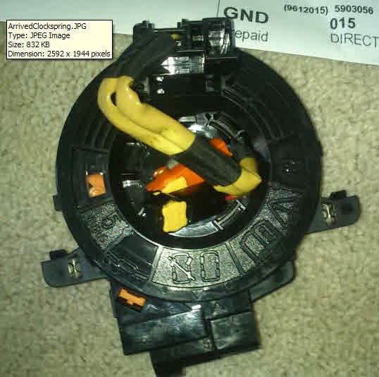

Well, GenVibe member cq358 & I worked out a a deal (he's a good guy).....I bought his old clock spring (clockspring) & just finished swapping it out with my suspect one.....And it appears that my less than scientific diagnosis was correct.
With the 'new' clock spring in, the dashboard airbag light is out. Further testing of my 'old' clockspring seems to reveal that there is a dead spot right where I thought it was...and then some. Put the muli-meter probes in the orange airbag connector, and spun the clock spring & it cut in an out around the 12 o'clock position, just like I thought.
