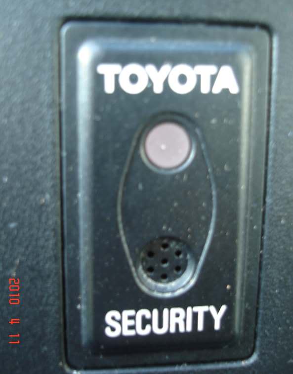

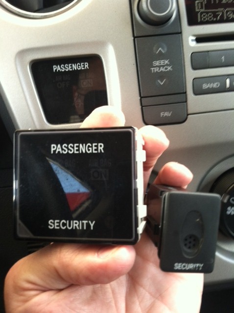

Option 1. I have purchased the Glass Break Sensor and Passenger Air Bag Off Sensor WITH the Security Light (Picture 1), if I do use the RS 3200 system I could use these sensors and have it look stock. With this integration it will look ABSOLUTELY like a stock unit. ONE THING TO NOTE! The harness for the NON Security system is missing a wire in the harness (the lowest most wire)! Be sure to grab one off the parts car (need to make a special trip to the yard to get it). Also I haven't checked if my car has the GBS harness so I will cut it off when I visit.
Option 2. Use the Toyota GBS with Integrated security light, BUT it says Toyota on it (Picture 2)
Option 3. Use the Toyota GBS with the Integrated security light, BUT run a wire to the dash security light to have both blink!
Worthwhile? Discuss...

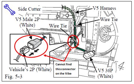

I took my dash apart last night, I can confirm that 99% of what is in the installation manual is in the car! Looks like we can do a plug and play!
ONE SMALL ISSUE! On page 12 there is a small 2 pin connector that has to be plugged into this harness which I could not find on the Vibe. Can someone confirm what this plug is? Do we need it?

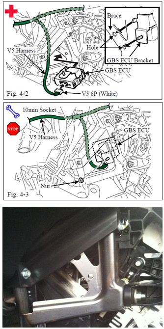

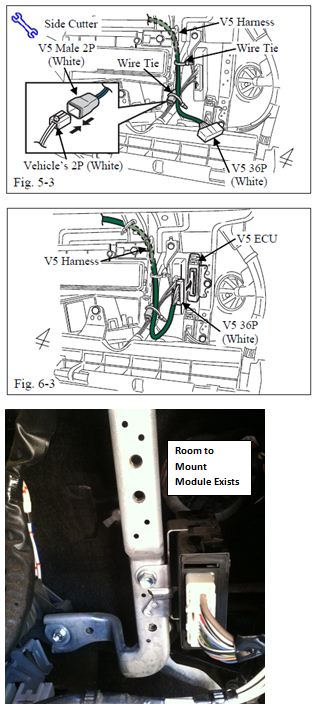

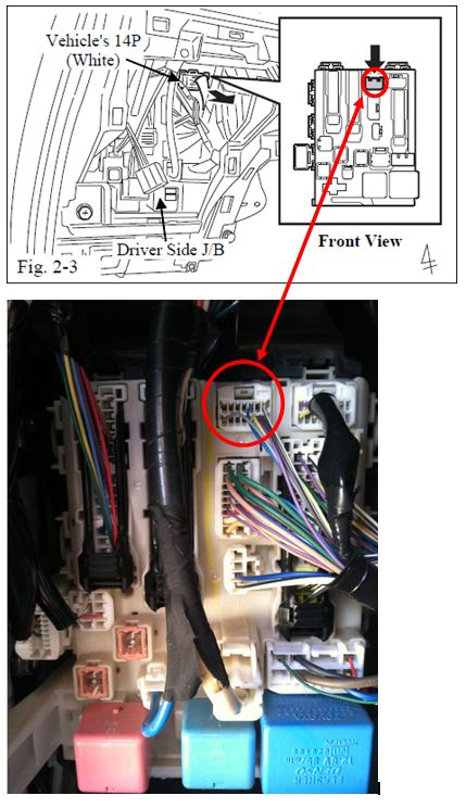

Ok Folks here is the entire comparison I made to the Toyota Installation Manual for the RS3200. It looks doable! EVEYRTHING IS THERE.... BUT!
Check out the pictures below!
Missing Wire
Missing Wire
Missing Wire Diagram.JPG (43.91 KiB) Viewed 1509 times
GBS
GBS
GBS Bracket Comparison Diagram.JPG (70.36 KiB) Viewed 1509 times
Fuse Block Diagram
Fuse Block Diagram
Fuse Block Diagram.JPG (75.33 KiB) Viewed 1509 times

Two More
Unknown Wire
Unknown Wire
Unkown Wire Diagram.JPG (45.73 KiB) Viewed 1508 times
Module Mount
Module Mount
Module Mont Fits Diagram.JPG (59.67 KiB) Viewed 1508 times

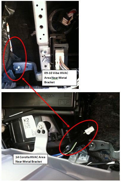

I went to a Toyota dealer at lunch and looked behind the glovebox of a 14 Corolla, the connector is there. Once again the connector is missing on the Vibe. I will have to take a volt meter with me to determine if the cable has power to it, if so it may be possible to tap the power off of some other wire.
Vibe vs Corolla
Vibe vs Corolla
Vibe Corolla Bracket Comparison Diagram.JPG (50.06 KiB) Viewed 1503 times

Come to learn that those connectors are called the E46 connectors, other than that I have no idea what function they provide!
