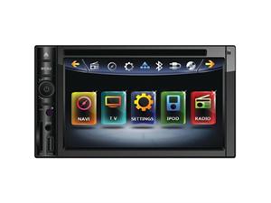

Currently looking to replace my stock stero with something a little more flashy...
Had my eye on the Power Acoustik PD-622NB 6.2" INTEQ Double-DIN TFT/LCD Touchscreen Multimedia Receiver. anyone know if there are any issues installing this into my 05 vibe?
Specs:
General
Product Type: DVD receiver
Intended for: Vehicle
Radio
Type: Radio tuner - AM/FM
Total Preset Station Qty: 30
AM Preset Station Qty: 12
FM Preset Station Qty: 18
Connections
Connector Type:
USB ( 4 pin USB Type A ) - front
Composite video/audio input ( mini-phone 3.5 mm ) - front
Composite video/audio input ( RCA phono x 3 ) - rear
Composite video/audio output ( RCA phono x 3 ) - rear
Subwoofer output ( RCA phono ) - rear
Camera connector - rear
System
Form Factor: In-dash unit
Enclosure Type: Double-DIN
Control Features: Touch panel
Features: Rear-facing camera capability, ID3 tags support, iPod/iPhone compatible
Monitor
Type: LCD monitor
Technology: TFT active matrix
Diagonal Size: 6.2"
Resolution: 800 x 480
Analog Video Format: NTSC, PAL
Features: NTSC/PAL auto switching, touch screen
DVD
Type: DVD player
MP3 Playback: Yes
Amplifier
Max Output Power / Channel Qty: 52 Watts x 4
Crossover
Type: Active crossover
Low Pass Frequencies: 160 Hz, 80 Hz, 120 Hz
More Information
Model No.: PD-622NB
Product in Inches (L x W x H): 10.6 x 9.0 x 7.5
