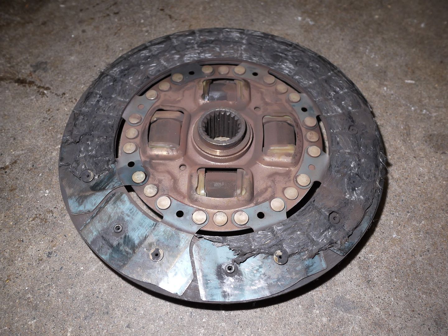

The clutch and flywheel definitely had been replaced before - the old flywheel was marked 88,000 on it, presumably the mileage of the car it came out of. Everything was quite worn and the flywheel and pressure plate were lightly discolored - but the most shocking thing was that the clutch disc had chunks missing out of it! About 1/3 of one of the faces was missing all of the organic material in chunks down to the metal, and both sides were worn all the way to the rivets. I don't think I could have gone any longer without changing it...
Here's a pic of the devastation - just about the only thing worse is an exploded disc!
