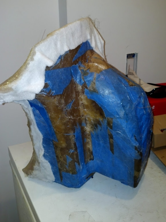

Heres what I got so far

Post by bigdaddyjosh »
very nice....btw it is very easy to remove the plastic back there. i so wish i had done this and did the fiberglass outside of the car. my back hurt so bad constantly from leaning in and out of the car plus u can put whole sheets in and lay it flat
anyway ill be glad to help any way i can i lurk on threse forums most every day

Well I laid the first layer today and after it dried I removed it from car, which wasnt easy, I really had to yank on that thing since I put so much tape down but I got it out. Almost all the tape is now attached to the fiberglass. Is that normal and do I just leave it?

shanghei wrote:Well I laid the first layer today and after it dried I removed it from car, which wasnt easy, I really had to yank on that thing since I put so much tape down but I got it out. Almost all the tape is now attached to the fiberglass. Is that normal and do I just leave it?
you didnt look at my pictures did you? Tin foil works great because it doesnt stick to fiberglass. After laying tape down I just used 3m spray glue to lay pieces of tin foil before applying fiberglass.

I did look at your pics and saw other guides suggest tin foil but gave up because the sun kept reflecting off it and I didnt want to mess up my eyes with that.

I chose left side before realizing the right side would alot easier and better. The pocket is turning into pain to layer fiberglass into.
My problems I am having right now is going through brushes like crazy and the resin hardens so fast.
Im hoping it starts looking better once I start putting more layers on.

Yep. Get the cheapest brushes you can find. I found some for less than a dollar that were about 1" wide. Also you need you need a can of Acetone. Trust me, that stuff works. using a small metal can such as a bread pan can put a small amout of acetone in. I put enough to completely cover the brush when it is laying flat.
Do as many layers of fiberglass as you can before the stuff starts to dry. Quickly soak the brush in the acetone and clean it out as best you can before it gets to hard. Then just let the brush sit in the solution. Doing it this way I was able to get atleast 4-5 good uses out of each brush. BTW you are using gloves for this arent you?
Hope this helps.

Are you suppose to take out the wooden pieces that hold up the subwoofer ring?

no. you have to mount the ring to those pieces. I hot glue my pieces in and then screwed the ring into the pieces with wood screws. The ring needs to be secure so that when you pull the fleece over the front to complete the enclosure you can pull it as tight as possible to make the surface as wrinke free.
Also, before doing this fill the box with water to check for leaks. The box needs to be airtight.

I filled what I had so far with water and didnt see any leak, so far so good.
Now the hard part is having the sub out of the way of the floor that opens up without having the sub touch the enclosure with the back of the sub.

Ok I almost finally done, I had a question though, I filled it full of water and it leaked around all the edges.
Any tips to make sure its 100% sealed? Thanks
All I did was after putting the cloth on I painted a few more coats of fiber glass on. Also are you gong to bondo and paint it? The reason I ask is because you can get matching paint for your interior from pontiac dealer. I didnt go this route but wish I had.
As far as the leaks go, the only thing you can do is inspect the leaks and try to make repairs. Then fill it with water again and check once more. How thick is it? Looks great by the way.

Thanks for the reply, I ended up putting a bunch of resin along the inside of the enclosure where the back meets the fleece fabric, seems to not leak anymore. I wish I was going to do bondo but I am tired of messing with this junk and just bought felt fabric which is same stuff for carpeting wood box at Joann fabric.

LOL. That sounds so familiar. By the time I got to where you are now I was tired of it as well. Its a long messy process.

Well here it is, finally done, just need to slap the subwoofer in and screw it in, and hope it works.

Here is the final product,
It took me forever and a day to do because I work 7 days a week, I'd say its easily doable over a weekend.
It works to my surprise even though I felt I was doing it wrong the entire time.
