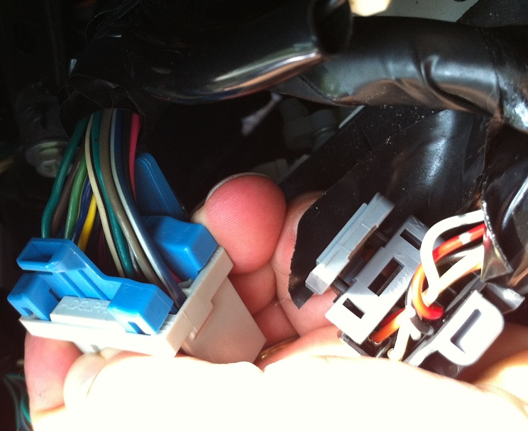

This is the wiring harness from behind the head unit. Hopefully someone can deduce from this whether I have an amplified subwoofer or whether the Crutchfield wiring harness will fit or not... I'm getting a bit confused. There is a box under the passenger front seat, if that helps the diag.

What I can tell you, however, is that the premium sound option in the Vibe included a Monsoon (brand) sound system. The box under the passenger seat is the amplifier, which feeds the sub. So yes, your subwoofer is amplified, and that box is the amp. Crutchfield usually has options for what car you have, and you can select the option Vibe - 6-speaker system, and then select whether or not you have navigation. Maybe their customer support could answer your question.
Here's a thread I found in the Audio board: viewtopic.php?f=18&t=15180" onclick="window.open(this.href);return false;
Good luck!
