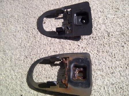

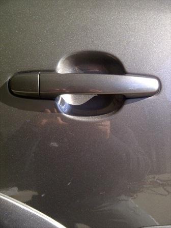

Hi,
I fixed mine. What I had to do it's just to replace a plastic pad under the handle. The pad has a kind of a nut in it which gets rusty. I got my new pad from Toyota dealer (Toyota Matrix) coz they had it in stock and it was cheaper than from GM (Pontiac Vibe). Pictures attached.

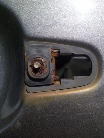

couple more pics

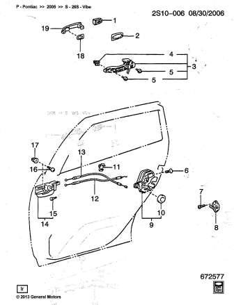

Post by bogdanas »
#18 is the problem
