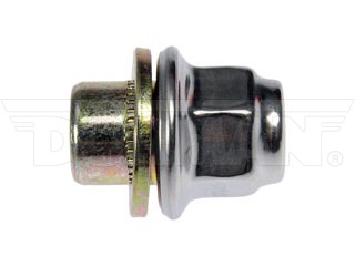

I know this is an old thread, but maybe someone can chime in and help. My '06 Vibe has alloy wheels and I know the lug nuts should be 12x1.5, but what about the length and seat? Acorn style seat or flat with washer???
Posts: 10265
Re: Lug nut size
the alloy wheels take the flat with washer, the steelies get the acorns.
an example of flat with washer nuts for Vibe alloys is
https://www.dormanproducts.com/p-10227-611-211.aspx
although I'm not sure if these have a separate floating washer, or if one is needed. maybe flat flanged is a better descriptor
