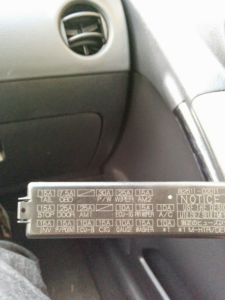

I had to fix the licence plate lights on my 2004 and when I was double checking the fuse box (which felt like a massage session) I noticed the P/W fuse slot is empty. My Vibe has power windows and it's working fine at the moment, but just though I'd ask.
Probably not a good idea for me to stick a fuse in there right? If it ain't broke...

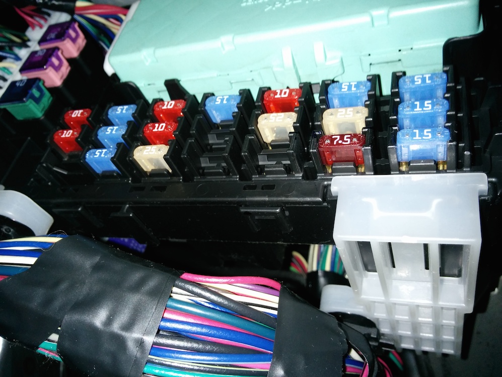

I haven't looked at the fuse block cover for a long time. I don't think it is installed on my car, such a pain to get to, I probably never bothered to put it back on. I don't see in the owner's manual where there is a P/W fuse there, so maybe the fuse block cover is labelled wrong.

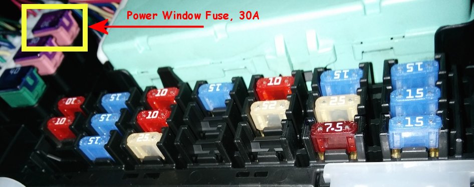

There is a 30A Power Window fuse in the picture you posted, but it''s one of the three square ones off to the side, not one of the little mini blade fuses. Don't know how it's labelled in the car
Power Window Fuse location, 03-08
In those three, the middle (30A pink) one is for the rear window defroster, and the green one is a 40A for the HVAC blower motor

I was reading the cover of the fuse box and though the P/W slot is empty, and I thought that was for power windows. (if you look at the previous picture, imagine it fipped upsideside, then centre of bottom row, just beside the yellow 25amp fuse).
Anyway, ain't gonna touch that now.
