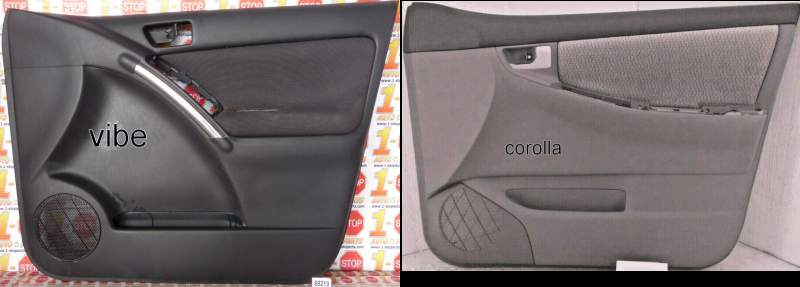

Re: Matrix / Vibe parts interchangable?
whiteknight1972 wrote: Sat Dec 11, 2021 4:51 pm I always wondered if the the 03 Corolla interior door panels are interchangeable with the Vibe. They have the same curve where it meets the dash but they come padding and with wood trim. Anyone ever try?
They are close, but I don't think they are interchangeable. I grabbed pics of front passenger door panels off the net for both vibe and corolla, sized them to the same width, and put them side by side
The corolla panel on the right looks shorter, which could be a difference in the pictures, but if you look at the distance from the bottom of the panel to the bottom of the curved section on the left side of the panel, you can see more space on the vibe panel than the corolla panel. On the vibe, that flat curved section ends above the speaker, its lower on the rolla. So, I think the vibe panel is actually taller.
The manual lock/opener hole is in a different spot, which might be an issue if the cables aren't long enough or there isn't a mounting hole to support the move.
