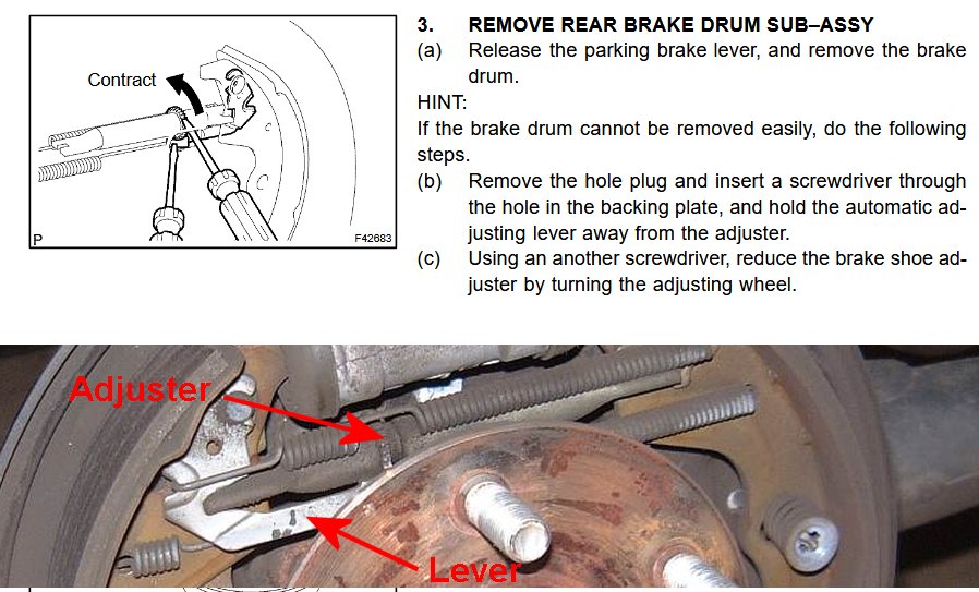

Sometimes you have to de-adjust the self adjuster in the drum to get the drum off. Its no fun, crawl under the car and work semi blind through a tiny hole after you pull the rubber plug, and since it has to be done from under the car, you have to be absolutely sure whatever you lifted the car with is stable and secure, or you could die
the diagram shows the perspective looking from under the car looking out, the photo is from the outside looking in.
Drum brakes have a lot of springs and things, so take lots of pics before you disassemble any of them so you have a reference on how it all goes back together.
