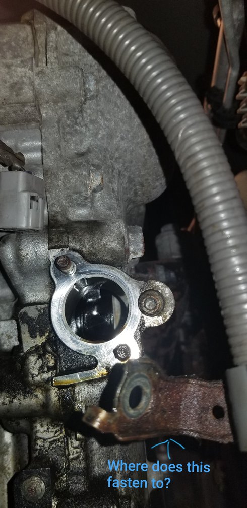

I have a 2010 Vibe, 1.8L, 2ZR engine (says on label). I removed the the old Timing Chain Tensioner...and was about to install the new one.
But I'm hoping some can provide a photo, because I need to see the back of the engine (in particular the wiring harness attachment location near the tensioner). I do not know where a metal part on the wiring harness goes!
If you look at the below photo, I have the Timing Chain Tensioner removed already. You can also see the metal part on the wiring harness (I've drawn arrow to it). Where does this attach to? I can't find an a place. I looks like it would almost share the lower bolt used for the timing chain tensioner...but I doubt that would be the case and I don't remember it like this when I removed it.

I don't own the 1.8L engine BUT I do own the 3-volume set of manuals. Hope this helps:

tpollauf , thank you so much for this great help!
I can see exactly what I was looking for, the image shows the connector I was referring to. And from the drawing, it DOES connect to the lower Timing Chain Tensioner bolt. I really didn't expect that to be the case! I will make sure to re-attach it correctly.
