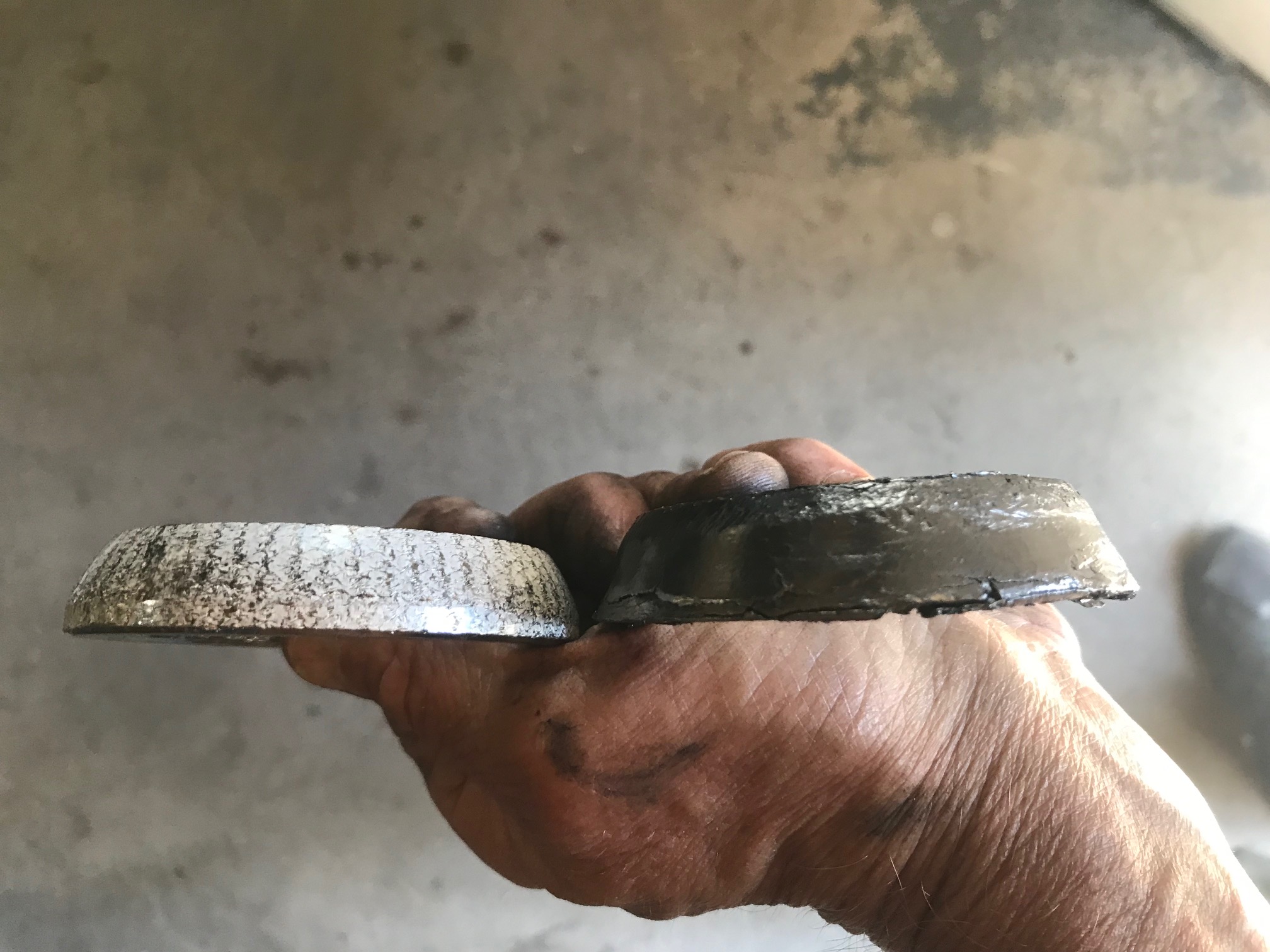

Actually there was a difference in gaskets. The joint started leaking again after about a week, so I went down to the dealer and got one from them. It's obviously more of a spherical section:
But after installing it, I noticed the flanges are not parallel, and are almost touching at the top. So next job is a rear motor mount. Funny, there are no other symptoms.
