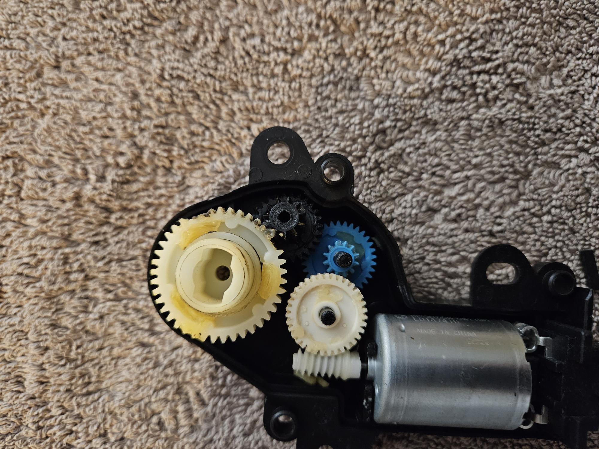

3. What I think is the HVAC blend door actuator. It does stop when the car is off but the dash has a constant clicking that I noticed around the time the heat/cool stopped being efficient, prior to the blower dying completely.

3. This is a very common issue in 03-08 Vibes, a plastic gear has lost a few teeth. Some replace the assembly; some pull it, take it apart, and rotate the afflicted gear 180 degrees; and some just disconnect the electrical connector on the assembly, leaving it in fresh air all the time. Its one of the few Vibe parts that are not the same on a Matrix.

#2 is the fan/blower motor. #3 is a different animal. At the top of the HVAC assembly, up under the passenger airbag, there is a little motor and gear assembly that moves a flap inside the air box. This assembly is completely independent of the blower motor and whether or not AC is on and whatever the temperature selection is.. When it moves the flap one way, it closes off outside air and opens the input to inside air, when it moves the other way, it opens up for outside air and closes off inside air intake. Its only function is to switch between fresh air and recirculate.
The problem is that in either position, the motor is always getting power and over time, this constant pressure on a plastic gear causes a few gear teeth to break off. The motor can then spin freely, catching and uncatching the broken gear, causing the repeated clack sound.
The easy way to verify that this is happening is to hit the recirc button, and if the noise stops, you've verified the problem. However, most people prefer fresh air over recirc . The little motor gear assembly has a little electrical connector, and if you disconnect that while its in the fresh air position, then the little motor won't get any power and will stop snagging on the broken gear teeth, so you'll get fresh air and no noise but lose the ability to select recirc. Not the ultimate solution but can get you by until the fresh/recirc motor assembly is replaced or repaired. However, its up over the glove box and can be difficult to see or access.
Now that you mention it, when it first started I used to do that to stop the clicking. It no longer stops it now for some reason.

The reason that it no longer stops the clicking is because the teeth on that side of the gear are now broken off. Here is a picture of the inside with some teeth broken off before I replaced mine.

VibeNation2024 wrote: ↑Sun Jun 23, 2024 10:43 am The reason that it no longer stops the clicking is because the teeth on that side of the gear are now broken off. Here is a picture of the inside with some teeth broken off before I replaced mine.
They must break much too easily. This is the 3rd time since I've had it, 2014.
Posts: 4195
Re: Introduction and a few dilemma questions...
takearushfan wrote: ↑Wed Jun 26, 2024 11:04 am They must break much too easily. This is the 3rd time since I've had it, 2014.
Yep. Pretty sad :( Several of us have replaced this part more than once!
