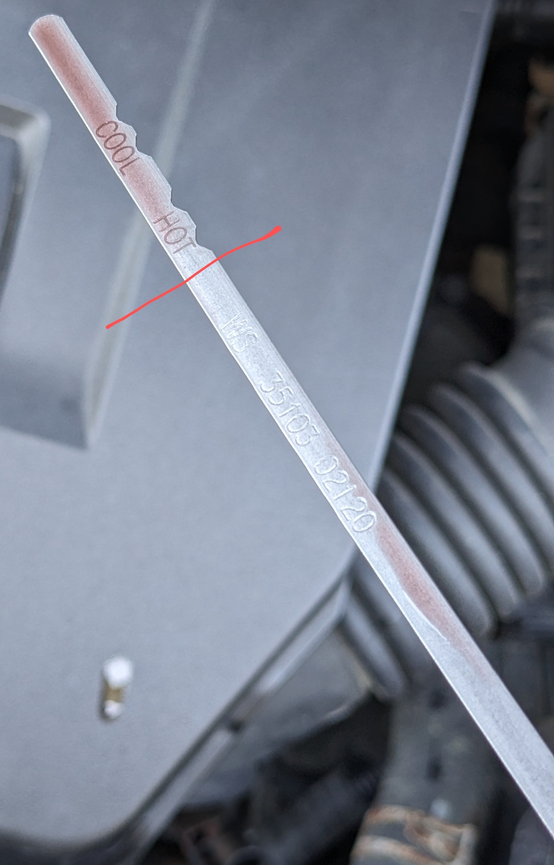

I checked my fluid level yesterday, and the Amsoil one is a bit weird compared to the original WS. If I check it after 10 or so minutes of idling after a cold start, the level is between the two "hot" notches. But, after a 30 minute drive (if was about 85F out), I get a slightly different reading.
I've attached a pic of it. I assume this is ok?

You will not get an accurate reading just by idling the car and will have to drive it. You will then return to park, slowly shift through the gears, return to park, idle for 3-5 minutes and check the dipstick again with the car still running. The full procedure is in your owner's manual but there is also a post in this forum with the instructions:
viewtopic.php?t=22730
Keep us posted how it looks.

Thanks for the feedback. The level you see in the picture is after a 22 or so mile drive on a hot day (which probably wasn't a good idea). I did the gear cycle before the drive too. From what I gathered, what I've got here is fine but anything over 1 inch over the hot notch is bad news. I'll try it again today after a brisk 10 minute drive.
To your point about the manual, the 2nd Gen is when WS was used and Toyota (and GM by extension) started telling people it's lifetime fluid. So the manual is missing the proper procedure to check it. The Vibe 09 manual has the wrong type of fluid listed too.
I got that warm idle tip from some dealership sites but there's inconsistent stuff there too.

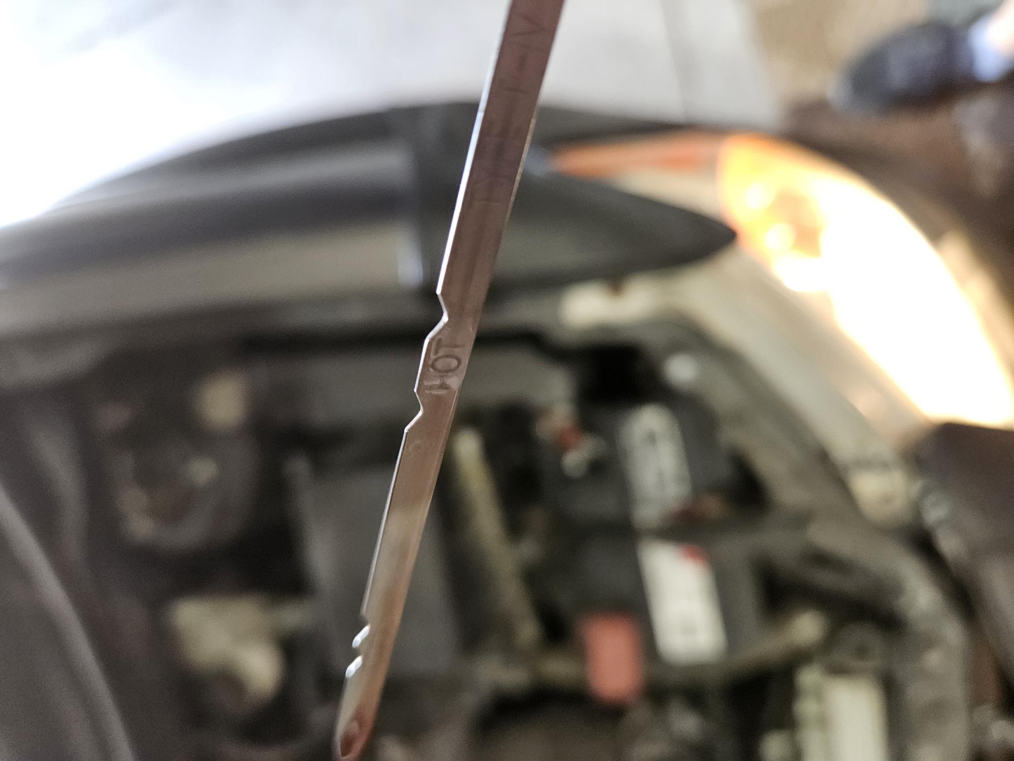

There's a bit of a difference. And given the temps today (85), unless I very quickly took out the dipstick, there was some splashback a bit higher on just one side (the opposite side was dry and so was the mid section until the notches).
I've attached a picture of an earlier reading that looked the same.

Based on that info and the pic for reference, I would say it is overfilled...but maybe only 1/4 qt. I read that the difference between the low and hot notches is only .3 qt so if we use that as a reference, It would be slightly less than that. I will add a disclaimer that this is my opinion so not sure if someone with a 2009/2010 could provide real world input/expirience.
Also, it would be very difficult to drain such a small amount with removing the bolt so you could get a hand pump with a longer hose to remove it through the dipstick tube. You could always remove a small amount (1/8 qt) and recheck before removing any more.

It's a bit difficult, I'll say that much. But here's what happened leading o this. The same day I posted the original pic, I realized that while the car was warm after a drive, the level was at the bottom cold notch.
I added a bit of fluid, about 8-9 oz, and ended up with this. Based on that, I probably needed about 4 oz or so. I'll say that WS and the Amsoil fluids are much thinner than T-IV used in the first generation. So, I'm thinking that warming up the engine without a drive on a hot day is appropriate to check the level.
Worst case I'll get a pump to syphon some out. I'm not too worried because you'd need an overfill of 1 quart to get into trouble.
UPDATE:
Followed the same procedure BUT just drove for 10 minutes or about 5 miles. The level sits right where it should be. Lesson learned: do not check after a 22 mile drive in 85-90 weather when the engine is hot rather than warm.
