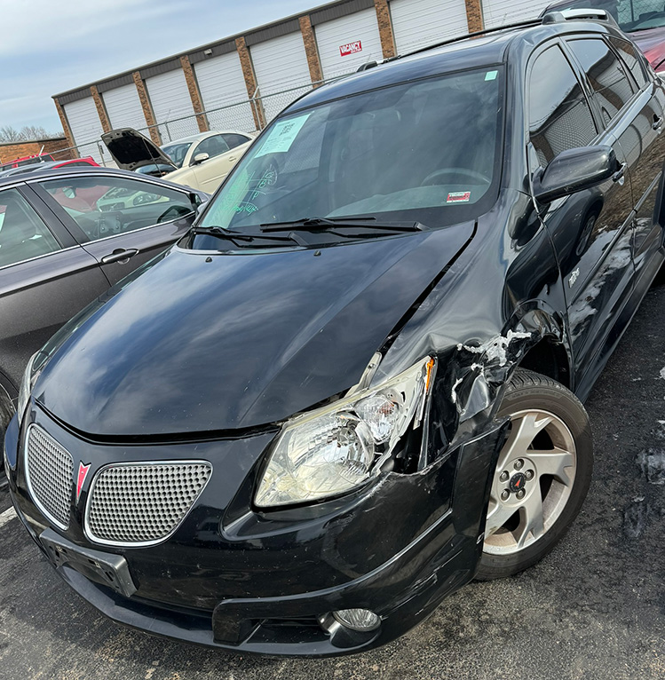

My 2007 Vibe was in a collision a few weeks back on the left front fender and headlight. Just got it back yesterday from the repair shop and it looks good as new!

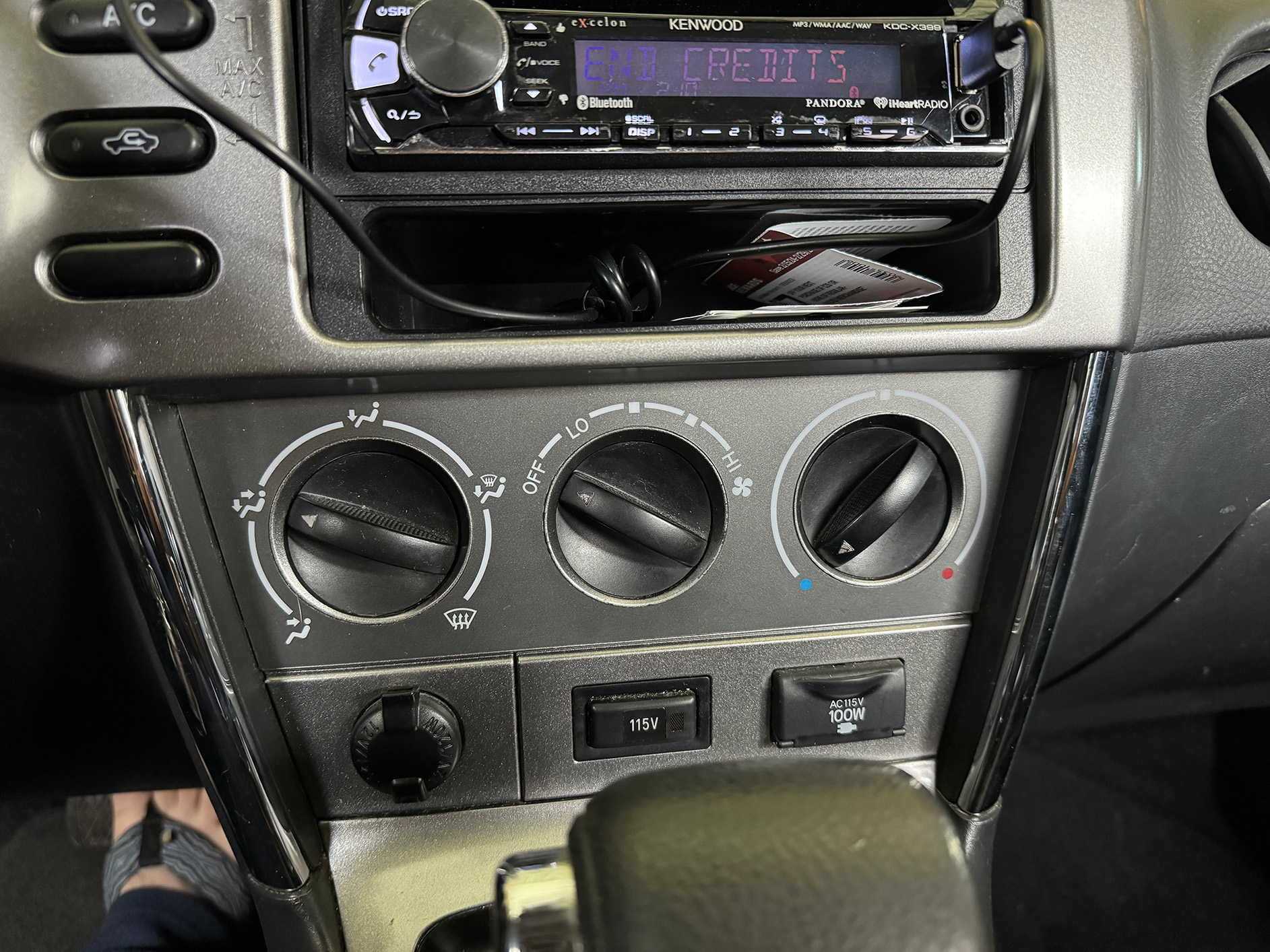

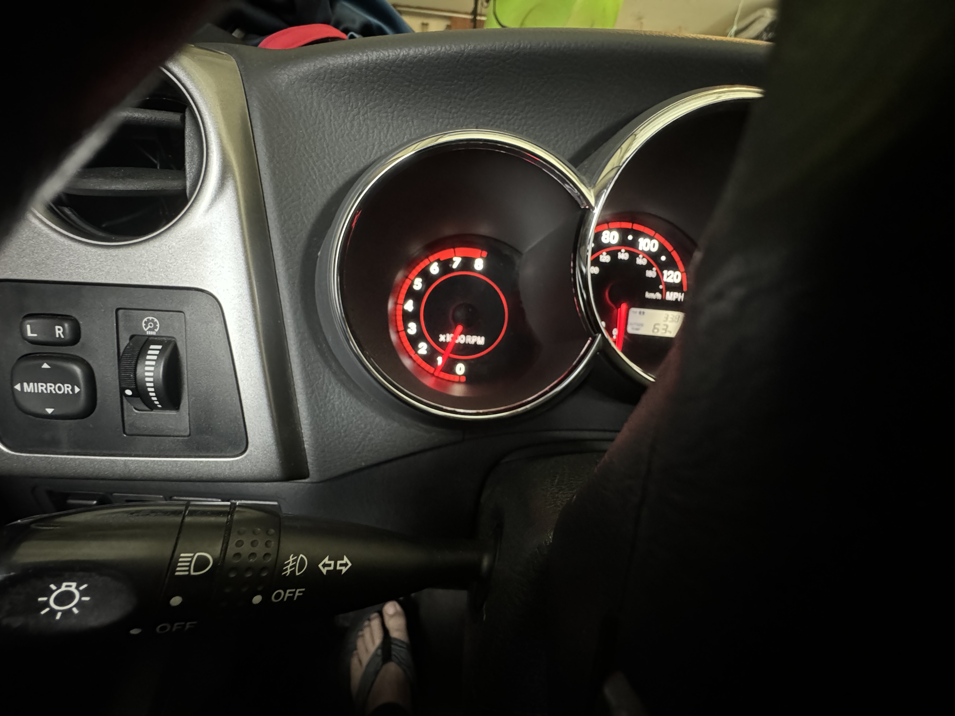

However, last night I discovered the dimmer dial does not work and the speedometer and fuel gauge lights are at full brightness all the time. The lights for the thermostat and controls are out as well as the rear running lights and license plate lights.

So now I'm back to the new left front headlamp. Could something be wrong there with the new one that could be causing this issue?
*Resolution - I took it back today for the shop to look for anything off either their work. Thanks to a previous post on this forum of someone with almost ex actor scenario I had; my guy took off the bumper and found the socket itself of the new lamp was defective. Mysterious that the headlights still worked but I guess goes to show electrical in cars can be oddly interconnected. Hope that helps someone else!
