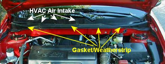

Posts: 10262
Re: Exhaust smell in the cabin on idle with heater/AC fan on
I was asking about the long gasket or weatherstripping on the top of the firewall side of the engine compartment. The cabin air intake is right behind it, if that gasket doesn't seal, then any vapors in the engine compartment would get sucked into the HVAC system, more pronounced when not moving. I don't think it needs to be a perfect seal, but if its worn, or the hood is misaligned and doesn't compress it, or if there are foreign objects on it, then you get more engine compartment air sucked inside. Ideally you wouldn't get exhaust in the engine compartment, but it might be why its getting into the cabin

Hi @joatmon,
Thanks for the picture, this is exactly the seal I had in mind. As I said, it is stretched and form some sort of ware that makes it much less of a seal, and I will try to fix that to see if this fixed the issue and will let you know, but I feel it's been like that for so long before the smell problem appeared that I have some doubts that this would cause the issue. I think you mentioned the most important thing when you said, "ideally you wouldn't get exhaust in the engine compartment". I think the problem is more there. Why is there any exhaust fume in the engine compartment.
