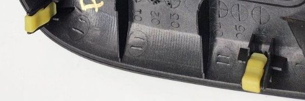

I have taken the bezel on and off a few times, replaced radios, had to get to wires, etc. The clips break and that is the case now.
In the past they have been easy to find locally and cheap at a junkyard. Today I looked and there were none to be found. They had already been removed. They are available online but not cheap.
I haven't removed it and am relying on memory, but I remember it looked like the retainer clips were made of a different material than the bezel and it they weren't molded on. I don't know that they were made to be replaceable either, but I'm wondering if anyone has looked into this and what parts these are, the PN and how to get them.
Or, whether my memory is at how things actually are.
Thanks
Re: Replacement Retainer Clips for Pontiac Vibe Radio Bezel (03)
I found a picture of the backside of a Vibe radio bezel on ebay, and cropped out this pic
looks like this ebay listing has them and says they are toyota part # 90467-10203 https://www.ebay.com/itm/275043642217
I wouldn't buy from that listing. If the clips you need are really toyota part # 90467-10203 you can buy a bag of 50 for $8 from amazon
( https://www.amazon.com/Console-90467-10 ... B0BWR83J1H )
but that's just one option, and hopefully you won't need 50 of them. Online toyota part sites seem to sell them for about $1.66 each, so if you're in a hurry, you could stop at a toyota dealership's parts department
