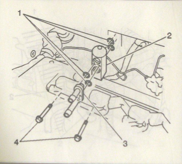

Re: HVAC - AC TXV Thermal Expansion Valve Replacement?
I don't have a Vibe to check, but from this picture out of a 2003 Vibe factory service manual, it looks to me like it's in the engine compartment mounted to the firewall
TXV is #2 in the pic

I'm working on my 05 Vibe and have been very successful with YouTube University to help me, but this expansion valve has me stumped. I've tried getting it out from under the hood but couldn't release the hose bibs from the valve, hoses came off but there are still bibs sticking out of the firewall.
Soooo, in pulling the dash, vent manifold and blend door assembly now I'm stuck on trying to remove the part that covers the TXV.
Does anybody have a link to help me?
Pattiba
Joined: Sat Sep 16, 2023 9:35 am
Post by Pattiba »
Welp, got it figured out, after pulling all the parts in the above post and seeing more needing yo be removed, I returned to underneath the hood, struggled a little with the grommet and it finally released, 8mm sWell, on two long screws on the expansion valve, jiggled it back and forth with needle nose and voila'. Now to move onto the rest.
