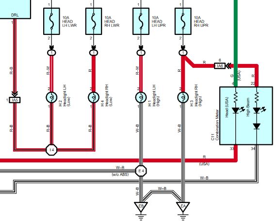

Not sure how much a wiring diagram will help though. Here's the relevant part from the 04 Matrix manual
I expect the wire colors are the same in Vibes, and if so the diagram shows the +12V side of the bulbs are the same colors for both low and high beam, red with white stripe for the left light, solid red for the right light.
In the diagram, the low beam ground side comes from the DRL module, which provides a ground for full low beam, and something above ground for DRL mode, that would be red with black stripe for both sides. Ground for the high beam would be white with a black stripe.
As far as I know, the only difference between this matrix wiring diagram and the headlight circuit in the Vibe, is that the matrix uses four headlight fuses, two low beam fuses and two high beam fuses, where the Vibe uses only two, a single fuse for both low beams, and a single fuse for both high beams

Well, that wiring diagram I posted doesn't seem right, as it shows four wires going to a three wire connector, so ignore that

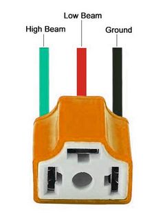

I found this pic online of a standard H4 socket
I had a spare 9003 headlight bulb and tested it with a 12V power supply, and the pinout in that diagram is correct, however that doesn't mean that the wire colors in that pic match the Dorman 84790. However, its pretty standard in automotive wiring that black is ground.
