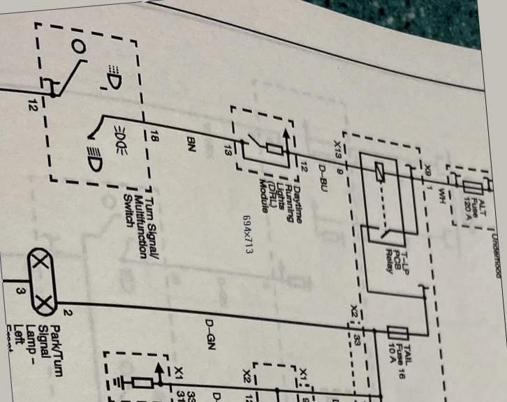

Back on topic here, I've taken some crude photos and uploaded them here for you. Hopefully you'll be able to see them on a good size laptop or full size monitor from some other device. Smart phone is OK but can't see the overall pic.

Assuming the bulbs aren't burned out, the most likely section of the drawings is this bit of the middle picture
Somewhere in the car there is a "T-LP PCB Relay" That relay gets activated with 12V from the 120A ALT fuse (which if that was bad a whole lot of everything else wouldn't work) and from a ground , switched by the headlight switch that then runs through the DRL module. When that relay closes, 12V from somewhere gets sent to the 10A TAIL fuse.
SO, the first question is where is the actual TAIL fuse on a 2010 Vibe? The book says its the #1 fuse in the underdash fuse block, but kgw51gmc says there's no fuse there and putting one in doesn't help.
Then if that can be found and its good, where is the "T-LP PCB Relay"?
And where does the "T-LP PCB Relay" get the power it sends to the TAIL fuse?
Also, keep in mind that tail lights should come on when the headlight switch in in full headlights mode, or when in DRL mode if the light sensor turns the headlights on full. If in DRL mode, there's no tail lights in day mode. So when checking for tail lights, either turn the headlight selector to full on or check that headlight symbol in the cluster is lit.
