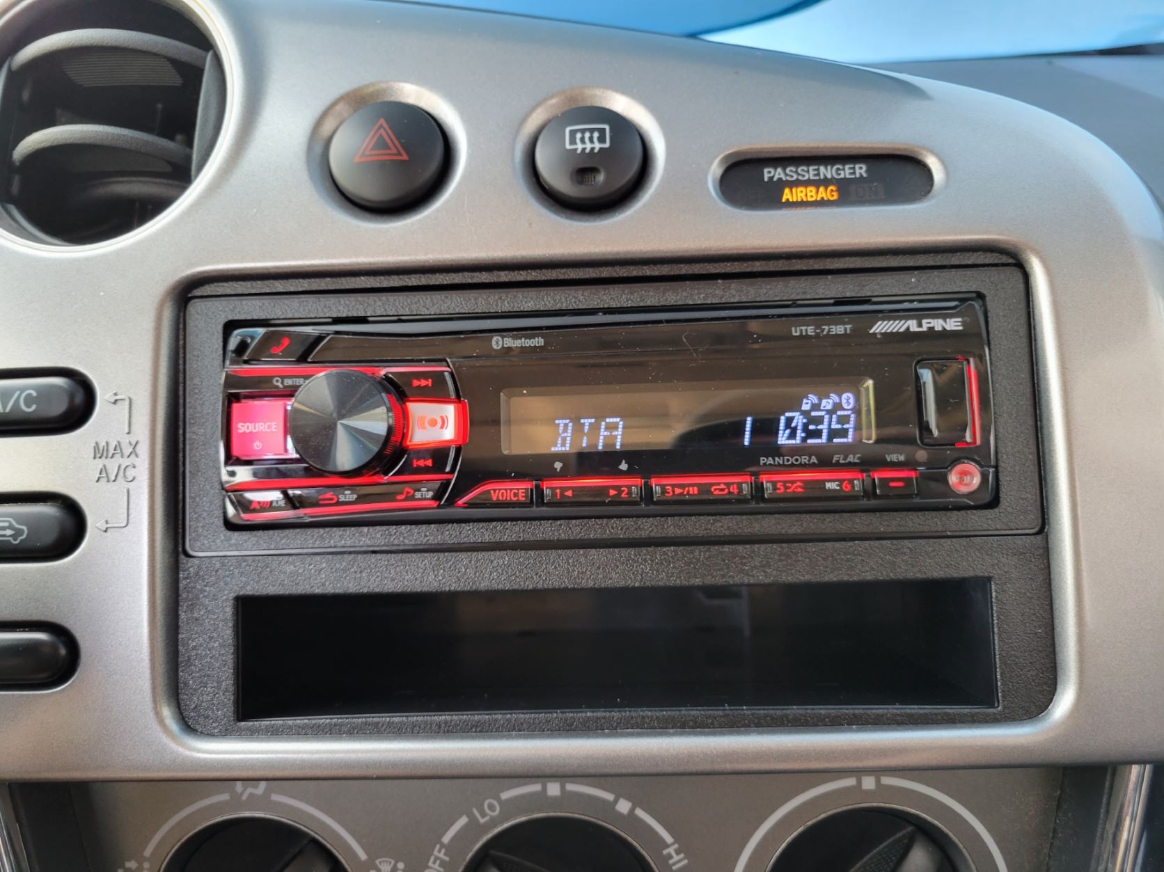

  1. New head unit: UTE-73BT. I don't like touchscreens, and pretty much use Pandora or Bluetooth to stream music. Can also customize light color and has blackout mode.

I'm not going to cover this really since it is the same as any other vehicle. Thinks to note.
  1. There is a lot of room behind the head unit to put wires and stuff.
  2. The dash kit (Scosche PT2049B) isn't the best fit, but better than the Metra one that the previous guy had installed IMO.
  3. If there is still static in the system after I Install the new amplifier I am going remove the ground from the harness and ground it the the chassis behind the dash.

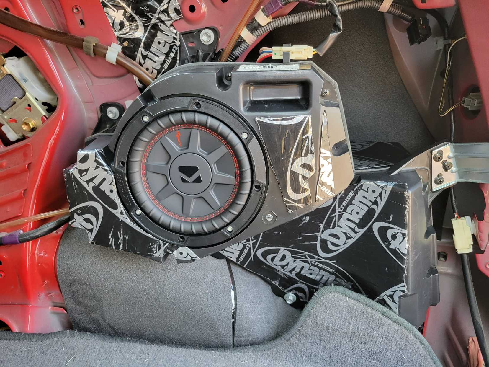

SUBWOOFER INSTALL

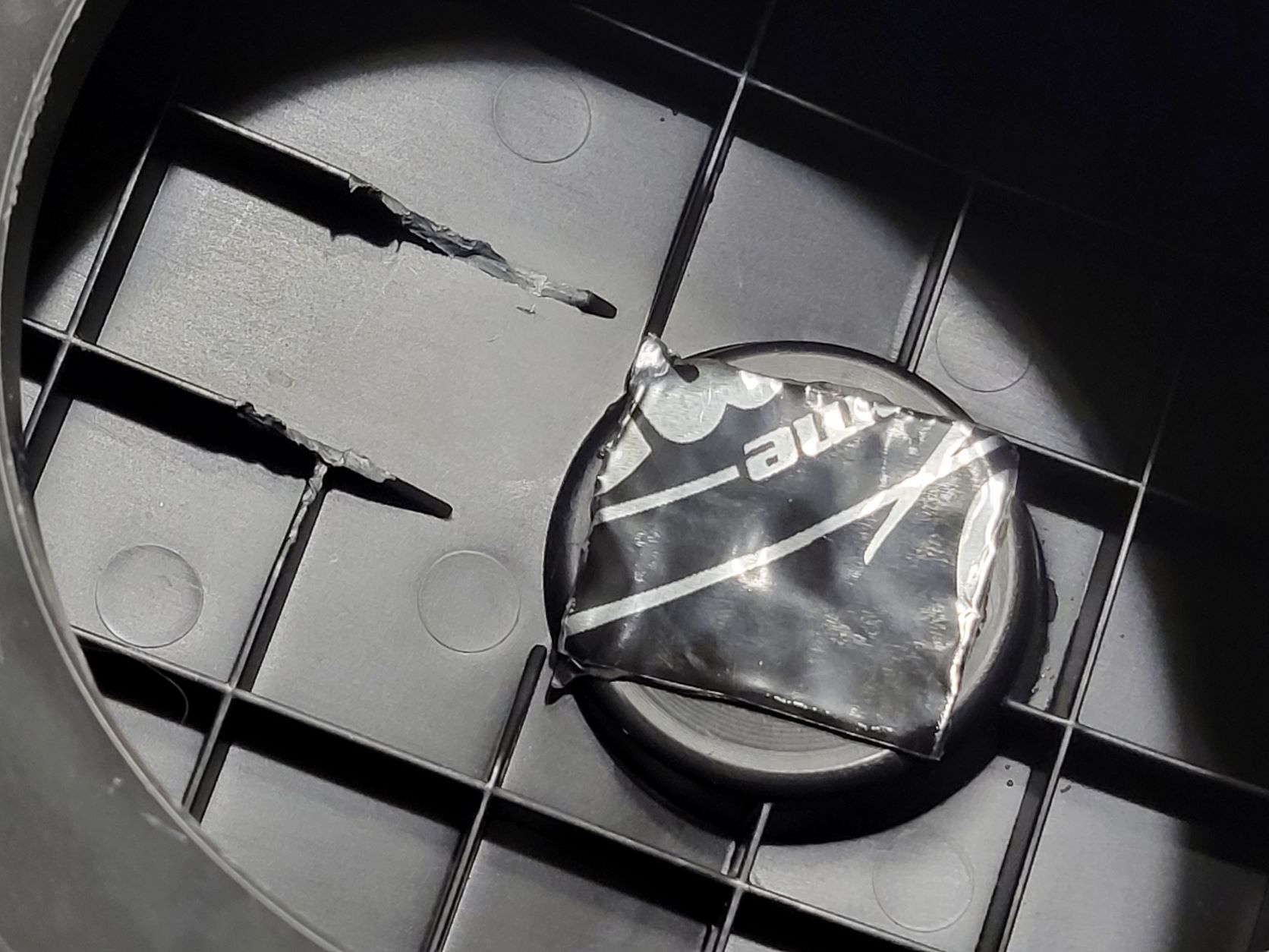

This went even better than I anticipated. I used a pair of lineman pliers to tear off small sections of the ribbing where the speaker interfered. The screw holes lined up too!!! The OEM hi-low screws have too large of a head to fit in the Kickers screw pockets (8.3mm/.325"), so I found some that fit.
I plugged the hole at the rear of the enclosure with dynamat from both sides. Time will tell if this is sufficient. I also added acoustic fill in the enclosure cavities as Derf had done.
