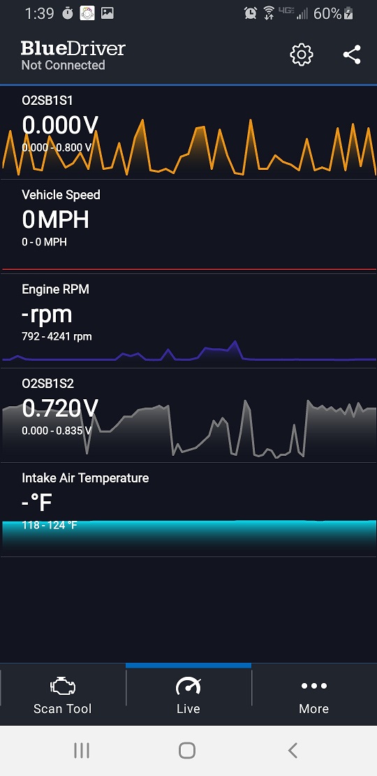

P0138 O2 Sensor Circuit High Voltage Bank 1 Sensor 2
rgnjc
Posts: 68
Joined: Sun Sep 11, 2011 12:53 pm
Post by rgnjc »
Over the last few days, my 2005 AWD Vibe has had brief low power issues when accelerating after a red light. This would only happen once or twice when the engine was cold and it doesn't happen after warming up. There was no CEL, but my Blue Driver OBDII scan tool found a single error code: P0138 O2 Sensor Circuit High Voltage Bank 1 Sensor 2. See attached images for the error code and the Sensor 1 and Sensor 2 voltages.
Can somebody interpret this? Has the sensor 2 gone bad and need replacing? Is it also possibly my catalytic converter is bad?

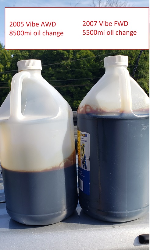

I ask about the cat, because over the last year I've been slowly losing oil (see the attached picture comparing oil volumes in my 2 vibes on their most recent oil changes). I do have oil leaking somewhere visible on the engine (rear/side passenger side) which I suspect may be the main oil seal. No oil ever ends up on my driveway though, so I have been wondering if the engine might be burning oil too.
Can somebody advise on how to proceed? Should I just replace the O2 sensor and see what happens in the future? How do I determine if the engine is burning oil and fouled the catalytic converter? Is there a way to determine if the O2 sensor is faulty without replacing it? Also, how do I access the wire plug for the O2 sensor? It seems to be somewhere under the passenger seat but I'm not sure where exactly. This car is at 191k and this is the original rear O2 sensor.

That's a big difference. I did 5000 mile oil changes on my Vibe, even though blackstone labs recommended 7000 mile.

Normally
SeattleJeremy wrote: Tue Aug 16, 2022 11:55 am That's a big difference. I did 5000 mile oil changes on my Vibe, even though blackstone labs recommended 7000 mile.
Normally my OCI is 4-5k mi, but I recently moved and and have a baby so I haven't had the time. As for the oil leak, I think its coming from crankshaft oil seal. I'm not sure of the seal's GM part number is though so I may have to pull it out and get the number off the seal. I also threw a can of Liqui Moly Oil Saver in for now. Other than the known issues of Toyota engines burning oil (because of the drain holes on the pistons getting clogged), I have no obvious indications that I'm burning oil and fouling the cat/O2 sensor (no soot in exhaust, no smoke, no sulfur smell).

A 2003 Matrix manual on the sensor 2 gives this test for sensor 2 malfunction (P0136)
Code: Select all
a) Connect the hand – held tester or OBD II scan tool to the DLC3.
(b) Warm up the engine to normal operating temperature.
(c) Read the voltage output of the heated oxygen sensor when engine is suddenly raced.
HINT:
Perform a quick racing to 4,000 rpm 3 times using the accelerator pedal.
Heated oxygen sensor output voltage: Alternates from 0.4 V or less to 0.5 V or more.
I don't have the Toyota doc for P0138

In general terms, (as I understand it, which means I can easily be wrong) the first O2 sensor is used to help regulate air/fuel ratios, while the second O2 sensor is just to measure the converting of the catalytic converter. Computer compares the readings from the second to the first. If the converter isn't doing enough, the computer doesn't see enough difference between the two and throws a 420. Stacking a couple antifoulers backs the sensor out of the actual exhaust flow, which makes it read lower, and the computer interprets this as an indication that the converter is doing its job, even if its not.
viewtopic.php?t=35971 is a recently active thread on doing it

Here's my conclusive update on this issue: I took it to the mechanic and he said the diagnostic indicated the MAF was faulty and needed to be replaced ($253 for an aftermarket part!). I took the car back and got the GM Original part (88969106) off rockauto.com for $90 and replaced it myself. I didn't suspect this because I kept the MAF clean, since it was a regular part of my maintenance to clean it.
Before replacing it I looked at the MAF sensor with my bluedriver OBD reader. I recorded the live readings of rpms, TPS, and MAF rate. See attached for readouts. Basically, the MAF sensor mostly worked, but every now and then I would get a funky MAF reading that didnt match the throttle position. As I understand it, the TPS and MAF basically overlap mostly, except for a small lag between the throttle position and MAF response. Occasionally I would see a weird MAF reading that didn't match the throttle position, which was causing my slight but noticeable hesitation. The new MAF sensor seems to work perfectly and I've looked at a lot of live readings and everything seems to be working. I added pics here so people have a reference if they ever want to diagnose their MAF with an OBD reader.
I did however get 2 new codes after changing the MAF sensor: P0102 (Mass or Volume Air Flow Sensor "A" Circuit Low) and P0113 (Intake Air Temperature Sensor 1 Circuit High Bank 1). I didn't reset the ECU after changing the MAF, so the computer probably thinks something is funny because it learned the fuel and O2 trims on the old faulty MAF. I cleared codes and drove around for a half hour and they haven't come back.
Long story short: rear O2 sensor was probably not faulty (maybe it was lazy, maybe not), but since it was only $100 I'm not going to sweat it, I look at it as a lesson learned. Replacing the MAF sensor seemed to solve the problem. Car test drives fine and is on its way to 200k! I did however find 2 new problems: the center support bearing rubber is cracked, and the exhaust flange is leaking. I'll fix those next. I can do both, although I'm not sure how to make sure the driveshaft is aligned (I replaced it 2 years ago and it probably failed again because it wasn't aligned perfectly). I'll have to find a shop to do the alignment after my repair. These 2 issues can wait till the fall though.
