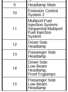

According to the 09 Vibe owner's manual,(available at viewtopic.php?t=755 ) there seems to be five fuses associated with headlights in the under hood fuse block
Since 14 and 15 are labelled "low beam", perhaps 12 and 13 are for high beam.
