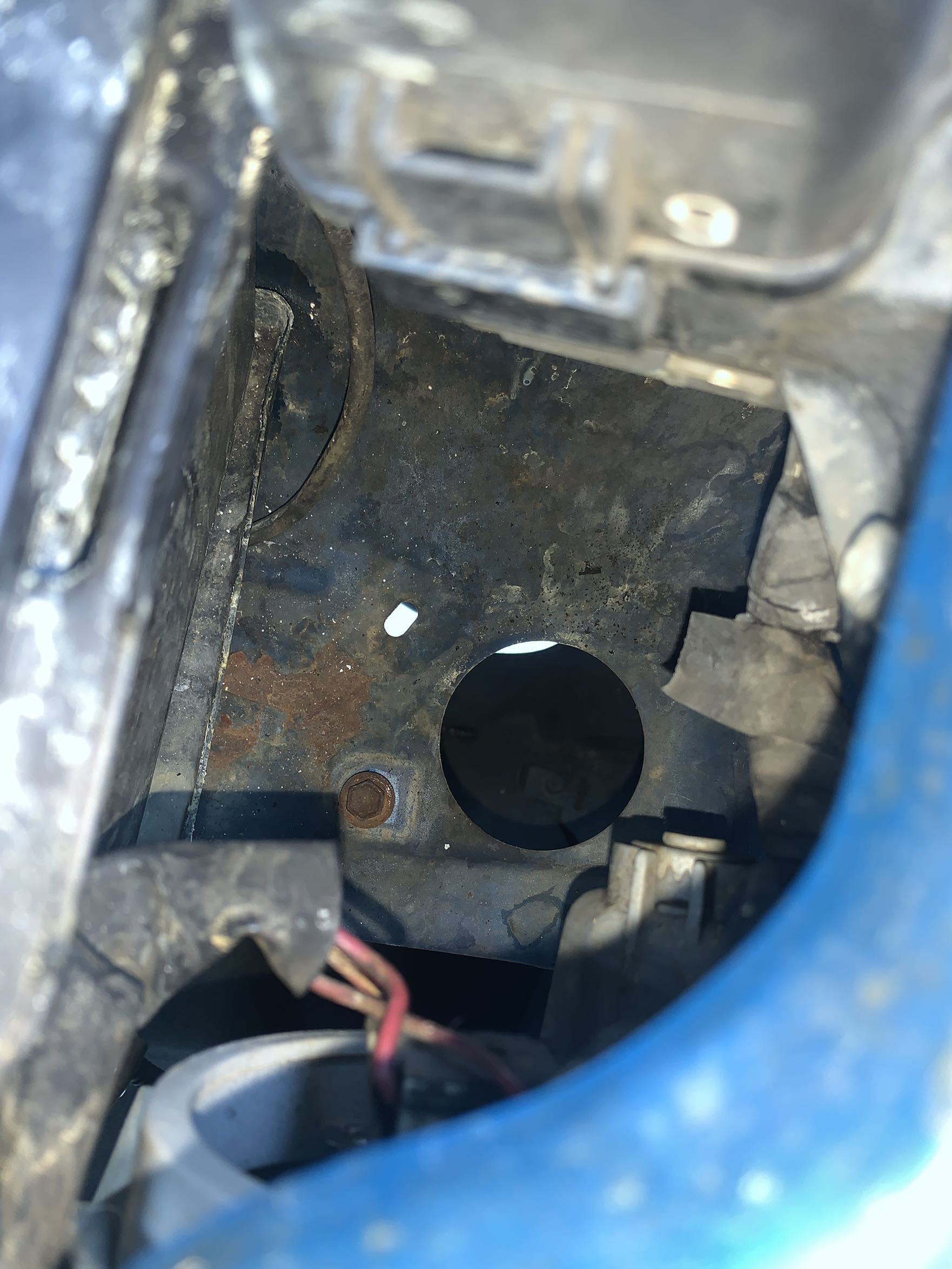

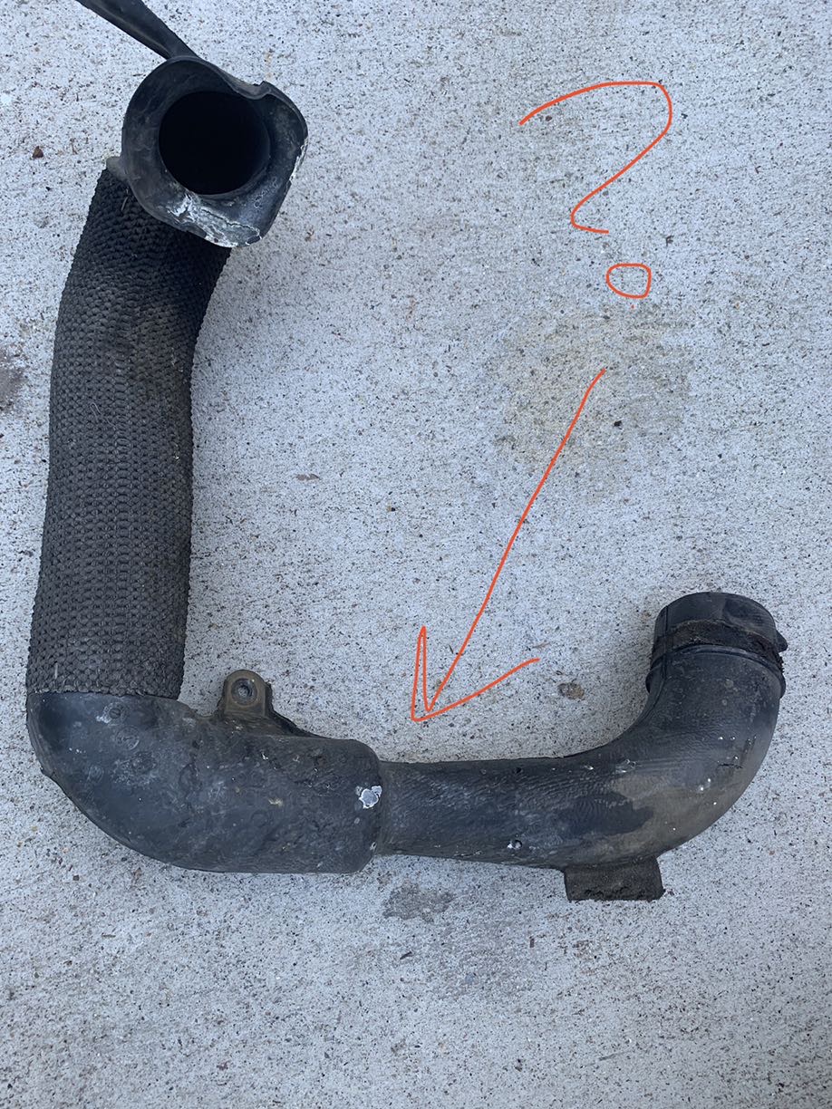

The plastic pipe that connects to the airbox wraps around the battery, then up behind the headlight with a little horn. However, in the middle, it chokes down to what looks like 2". I can't believe that any car could breathe through that hole. Removal is not too bad. You must take off the battery tie down to get some wiggle room. There is a 10mm bolt in the middle holding it to the chassis. Once the battery is moved back and the bolt is removed there is just enough space to snake it out. You will then find a mystery hole next to the battery.
Going a step further, you could run a 2.25" flexible duct from the airbox inlet to this hole and get true cold air feed.

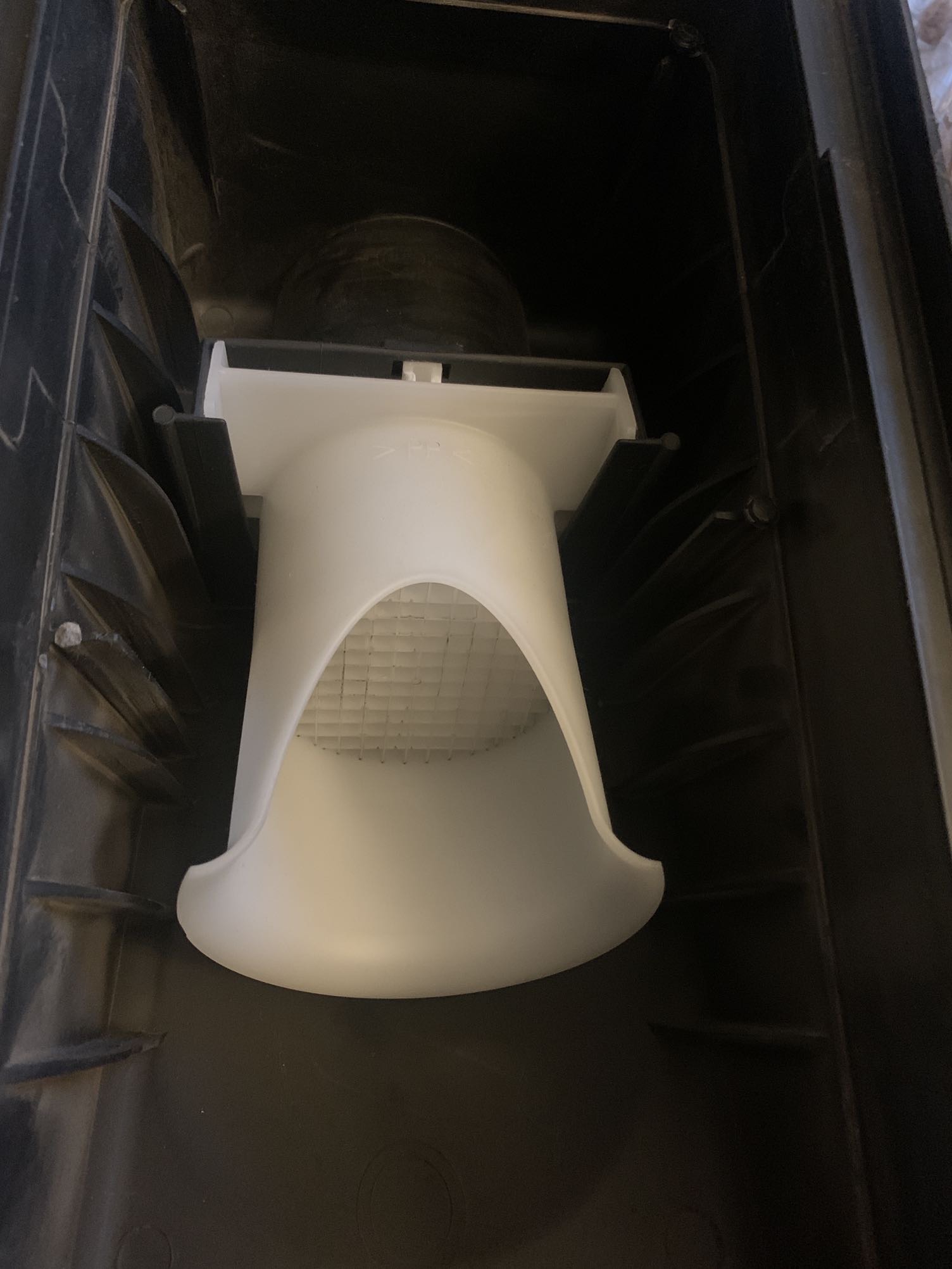

This is some debate about this. The intake horn in the top of the airbox is removable. It just pops right out. My question is, why is it removable? Some have popped it out, but who knows if this is a benefit or a loss. Obviously a horn shaped duct into the MAF would help with air flow on the low end. There is a screen in the horn though. So in theory removing the horn removes the screen as well. Also, because the horn is so long, you are only breathing from one side of the airbox. The MR-S 1zz does not have a screen, just a shorter horn and a larger airbox. HMMMMM.
By the way, the Matrix internal air horn does not have the slit in the bottom and the screen is right at the front. I *think* the reason why it is removable is because the top of the airbox is shared with the corolla, vibe, and matrix. You can then insert the horn that goes with the application at the assembly plant. Mystery solved?
