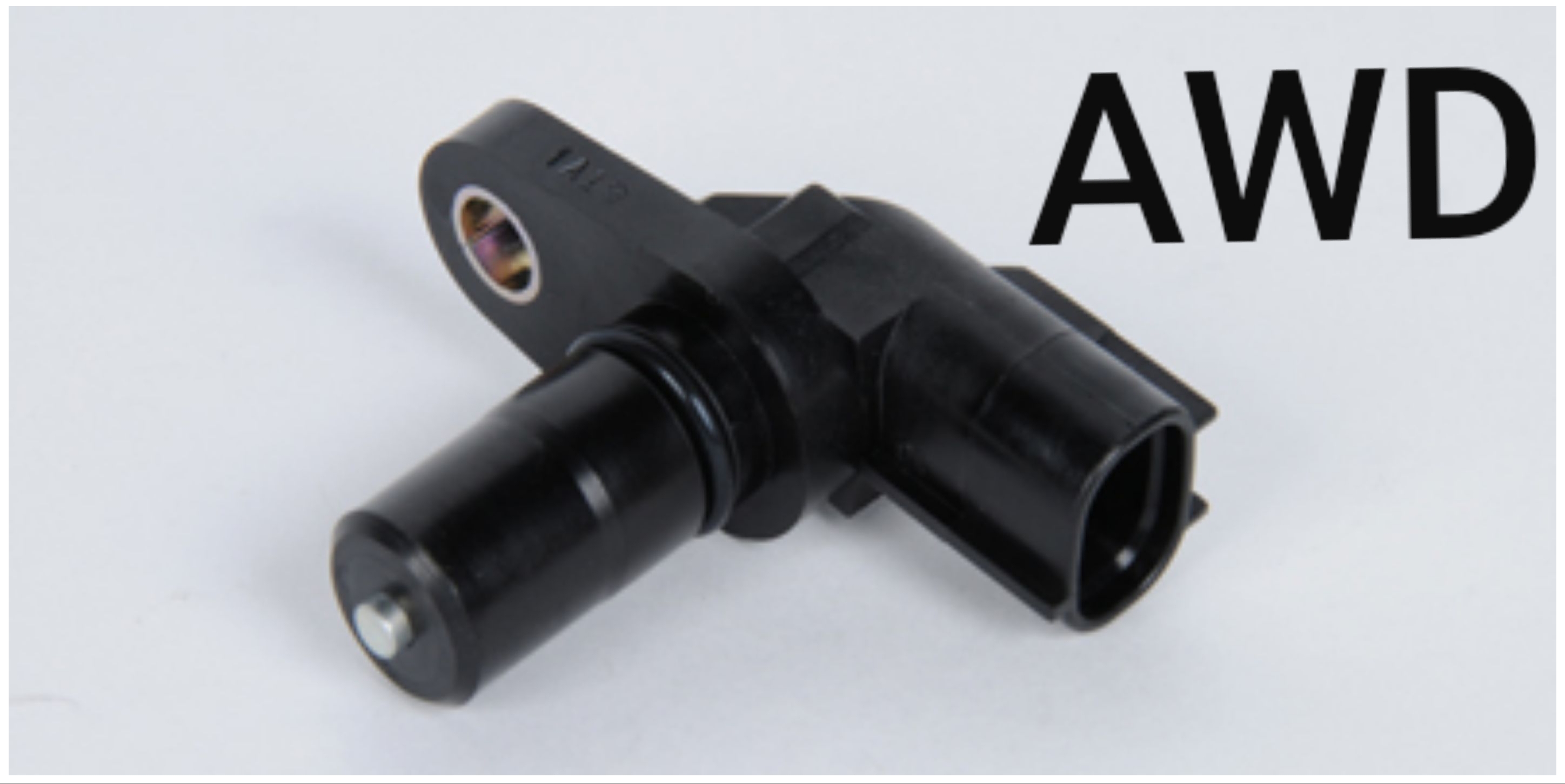

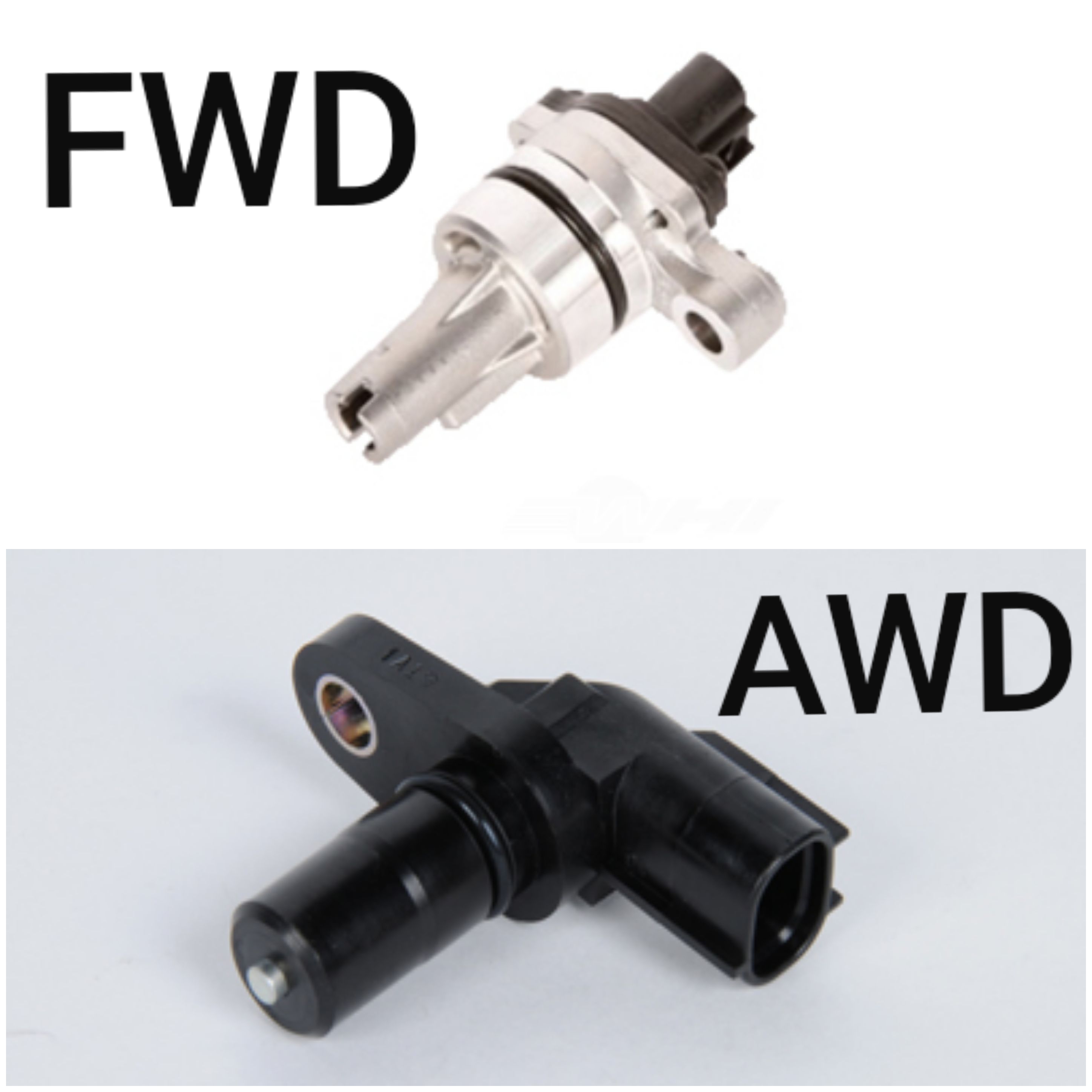

I was searching online and it looks like the AWD Speed Sensor looks like the ABS sensor at the wheel hubs. Very different from the FWD one. Please check the picture and confirm.
Posts: 606
Re: HELP: 2003 Pontiac Vibe ABS + Brake Lights Speedometer After 20 Meters Warning Lights Turns Off & Working Speedomete
I think that's the neutral safety switch. The VSS will be toward the rear, right above the shaft output.

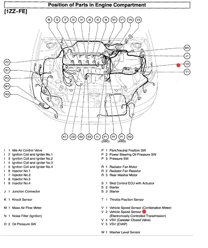

Hey, please check this picture where it shows the location of the VSS. Please confirm.
Posts: 606
I missed in your OP that you have AWD. Make sure that diagram is for AWD. As you noted above, they're different parts. There may be different wiring as well.
On my base model 2007, that diagram is roughly correct. It's more behind the engine, near the exhaust manifold.

Yes, my 2003 is AWD. I found the VSS exactly where the V2 is pointing to.
Would it make sense that the VSS is bad even thought the check engine light is not on? But usually the ABS and Brake lights are on, the speeedometer does not work and the transmission does not shift until the lights turn off.

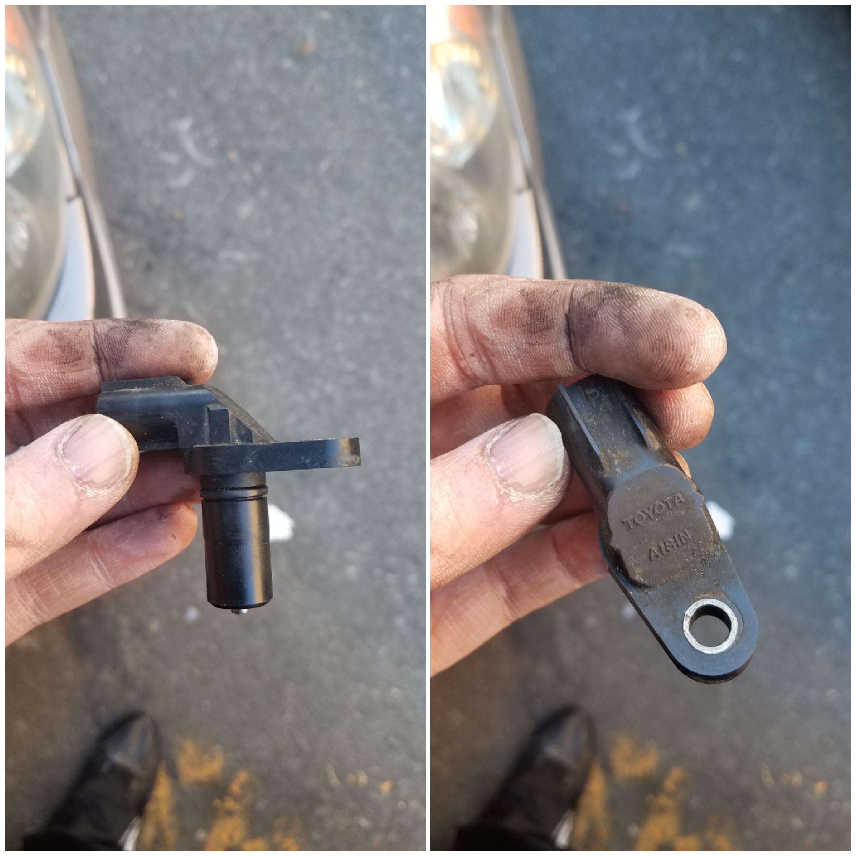

I have not done the bench test for the Speedo sensor yet. I was having trouble finding it. But I will remove it, check the connections, clean it and report back.

You may be right because the ABS Vibes also has a speed sensor very similar to a ABS sensor (they call it magnetic speed sensor) in the transmission.

zbyers wrote: ↑Tue Nov 02, 2021 2:29 am
joatmon wrote: ↑Sun Oct 31, 2021 4:54 pm Looks like the speedometer gets its signal from the ECM I know on non-ABS Vibes, the ECM gets its speed signal from the speed sensor on the tranny. Is it possible that on ABS Vibes, the ECM gets its signal from the ABS module via the individual wheel sensors?
I don't think the typical OBDII code reader can read ABS codes. Might need to take it somewhere that has an appropriate scan tool and see what error is being set when first starting, before you drive the short distance that clears it
pretty sure you are correct about ABS sensors giving speed input.
AutoZone's new in-store scan tool can read ABS on most vehicles.
Thank you for replying.
Like I said, I bought an OBDII / ABS / SRS/ code reader, but as well as the AutoZone code reader, does not detect any codes. The reader says "No ABS codes". Both code readers have been used at the time when both ABS+Brake lights are on, but it still show "No ABS codes" in any of the ABS code readers.

:o SOLVED:
I bought a QD Electric Cleaner at Walmart for less than $5.00. I unplugged and cleaned the transmission speed sensor. Also, I cleaned the engine bay ABS module plug (the module pins and the plug). I drove the car for like 10 miles with a couple on/off power cycles and ABS and Brake lights no longer stayed on. I have driven the car for 3 days now without problems. Now the speedometer works and no ABS Brake light problems. A SIMPLE CLEANING! Well guys, thank you all for the replies and support. Thanks!
