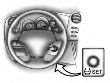

TPMS Reset
The TPMS sensors and transmitters have unique identification codes. Anytime you replace a TPMS sensor or transmitter the identification codes need to be registered and the TPMS needs to be reset (initialized). When the system is initialized, the current air pressure in the tires is set as the tire pressure benchmark. The tire pressure warning system determines decreased air pressure by comparing tire pressure to the benchmark pressure stored in the TPMS.
Do not reset the TPMS without first correcting the cause of a low-tire condition.
To reset the system:
1. Park the vehicle at a safe place and apply the parking brake. Turn the engine off.
2. Turn the ignition to ACC/ACCESSORY or LOCK/OFF.
3. Adjust the tire pressure of all the installed tires to the specified cold tire inflation pressure level indicated on the Tire and Loading Information label attached to the vehicle.
4. Turn the ignition to ON/RUN with the engine off.
5. Press and hold the tire pressure warning reset switch until the tire pressure warning light flashes slowly on/off three times.
Wait for a few minutes with the ignition in ON/RUN, and then turn the ignition to ACC/ACCESSORY or LOCK/OFF.
If the low-tire pressure warning light does not flash three times while you press and hold the reset button, the reset has failed. Repeat the reset process. If the reset cannot be performed, see your dealer/retailer for service.
If you press the tire pressure reset switch while the vehicle is moving, the reset is not performed. If you press the tire pressure reset switch accidentally and initialization is performed, adjust the tire pressure to the specified level and perform the reset procedure again.

Once I see how tomorrow morning's drive goes, I'll perform the reset procedure. If no resolution, I'll check on the sensors at RA when I get home and see if Sam's will do the installation.

Final: nope, reset procedure failed. Thanks for posting it joatmon.
