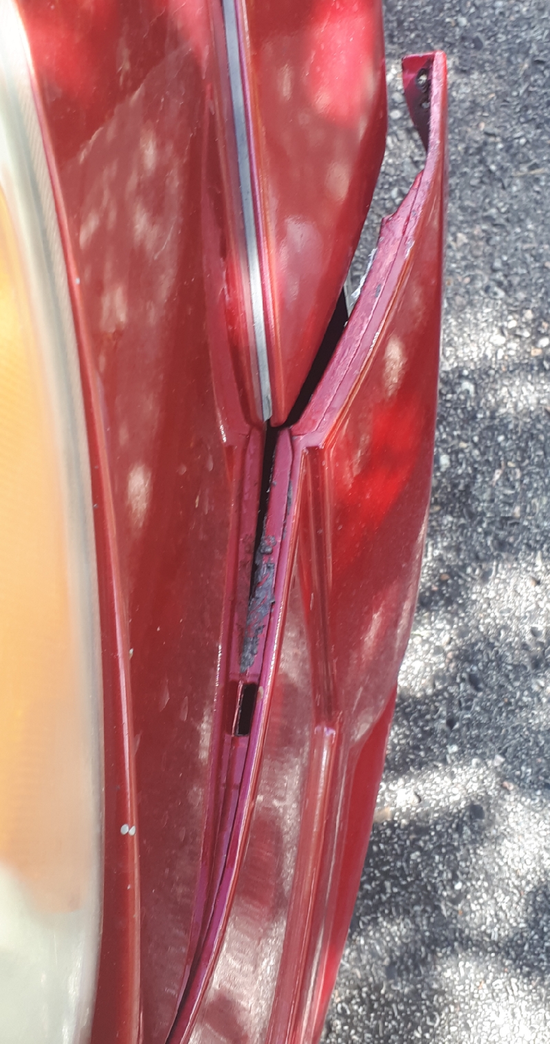

Hello,
The left fender on my '07 Vibe is coming detached and I was wondering if there are some clips that I can use.
I tried a 3M adhesive but it didn't work; perhaps because the area is too thin for a good hold?
Any other suggestions? Goop or something similar?
'07 Vibe, over 300 000km, live near Oshawa Ontario Canada
Posts: 611
Re: Left front fender issue
If I had access underneath I'd use some self-tapping sheet metal screws to hold the bumper cover to the fender. A fender liner or engine cover may need to be removed for access.
That piece is part of the front bumper cover. There is supposed to be a 10mm bolt holding the corner inside the wheel well.
