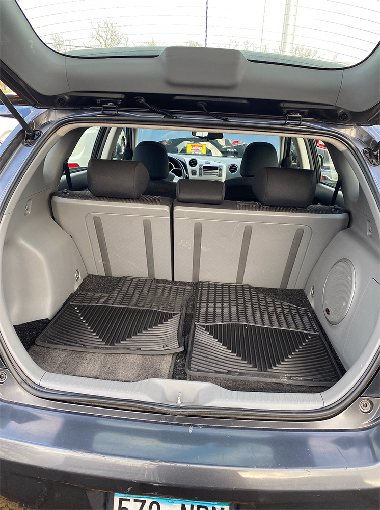

Hi All! First time posting here. I'm (24F, living in Minneapolis) looking for my first car. I'm looking for something I can use as I travel cross-country for the next 6+ months camping and staying with friends and more intermittently for travel after that. [Edit: my max budget is $11-12k, a bit lower is ideal]. I really don't know much about cars so I've been relying on doing research, including on forums, to try to feel confident in my search! I've been looking at crossover SUVs, wagons, and hatchbacks. I came across the Pontiac Vibe and it sounds like a car that could work for me. First question: does it sound like a Vibe would be a good fit for what I've described? I think if I can put some storage on top it should be big enough for all my camping gear, and from everything I've heard it sounds like a Vibe could be able to do long trips.

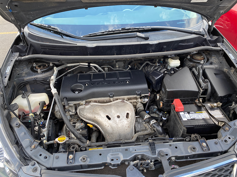

If yes, I need some help assessing the 2 AWD Vibes available in my area that meet my requirements. Btw, whatever car I end up wanting to get will be taken to a mechanic pre-purchase. But I need some help getting to that point! This first one I went and test drove today: https://www.whitebearsubaru.com/used/Po ... 1008ca.htm I'm attaching some pictures because that listing doesn't have any. Overall it seemed pretty solid! Drove well, no weird engine sounds, pretty normal seeming wear. The only thing I noticed is there was a sort of "knocking" sound coming from under the passenger area every so often when I was driving. When you pushed down on that side of the hood, it made the same sound (my dad guessed maybe something to do with suspension but he's not a car guy). They just got it and hadn't done the safety inspection, so the guy there said he'd let me know if anything turns up when that's done. The other thing is that the cruise control knob was broken (plastic snapped), but it looked like it just needed to be glued back on? Also, the CarFax lists it as having had four owners but when you look at the info I believe it only had 2 (first 2 owners was the same owner but registered in 2 states, 3rd only had for 2 weeks so seems like a dealer or something, 4th had for 2.5 years). So overall I'm wondering if this seems like a good car worth continuing to pursue, and if so, what might be reasonable to offer for it? $7,900 seems high to me.

The noise on the first vibe you mentioned will likely be the front struts. Kind of a deep/dull clunk? Could also be swaybar end links. Neither of which are particularly hard to change, or require any special tools (if you buy “loaded” struts with the spring and top hat - definitely recommend this route). Specifically, that clunk will be the rubber top hat on the strut.

As far as camping goes, I can fit a twin air mattress in the back of my 03 with the seats slid up. With a roof bin, it’s a definite YES to camping. Plus they have a 110v outlet in the dash that will run an air pump just fine, or you could get a 12v cigarette lighter style pump for about the same cost.

The AWD option is particularly useful if you’ll encounter rough terrain or snowy conditions. That first car sounds promising, but the knocking could indeed point to a suspension issue, like worn struts or bushings, so it’s good that they’re inspecting it. For $7,900, I’d negotiate after the inspection—maybe aim closer to $7K, especially with the broken cruise control knob.
